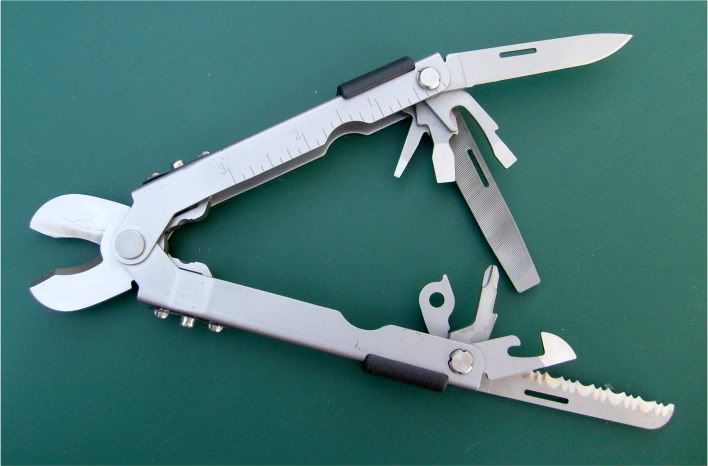

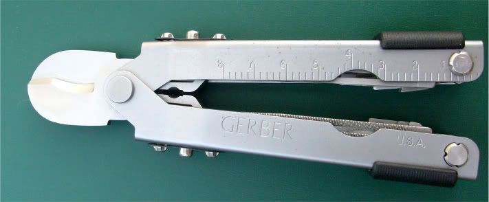

I stumbled on this odd/rare Gerber on US Ebay , $38 latter it was mine  8) 8) 8). I have been hanging out for it too find me & today it arrived :mail: :D :D
http://i291.photobucket.com/albums/ll287/multimat426/Gerber%20Cable%20Cutter/S6303604-1.jpg[/img]]

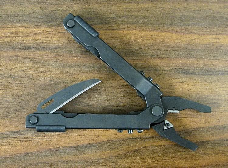

It is a MT based on the MP600 series of tools with the plier head replaced with a cable cutter
http://i291.photobucket.com/albums/ll287/multimat426/Gerber%20Cable%20Cutter/S6303605.jpg[/img]]
I wonder if this cutter head was available for the Gerber 650 MT with the interchangeable/removable plier heads  :think: :think:

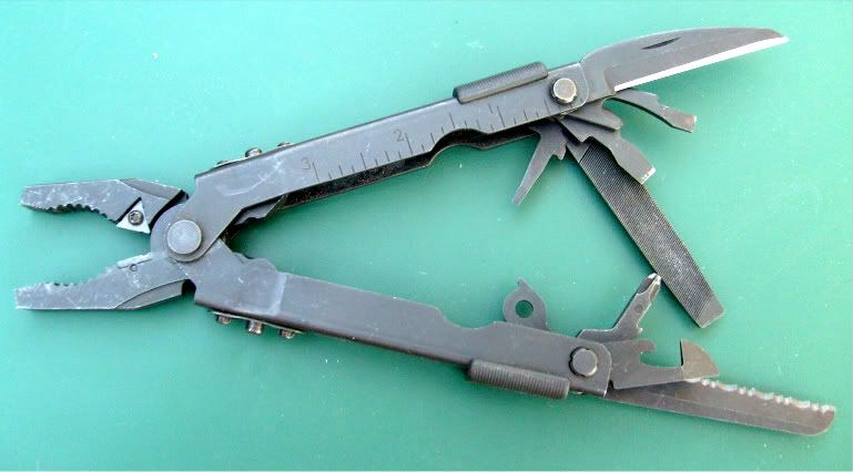

Tool selection is the same as that found on my Gerber MP600 blunt nose + carbide cutter MT below , with some small variations.

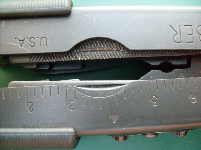

Note intact carbide cutters  ::)

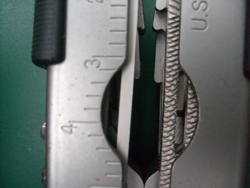

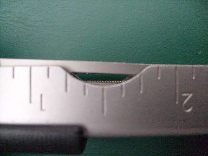

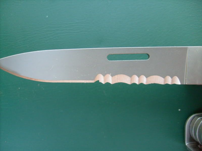

Different shape & nail nick/hole
http://i291.photobucket.com/albums/ll287/multimat426/Gerber%20Cable%20Cutter/S6303612-1.jpg[/img]]

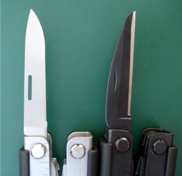

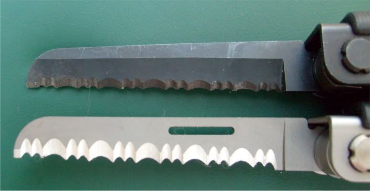

Blade serrations are more aggressive on the Cutter MT + different nick/hole

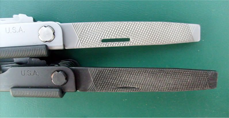

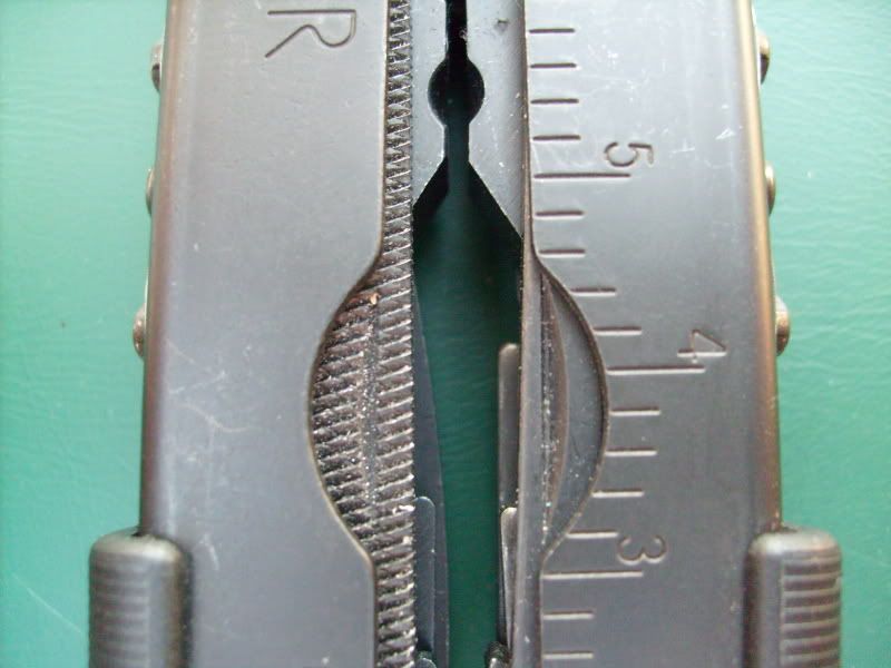

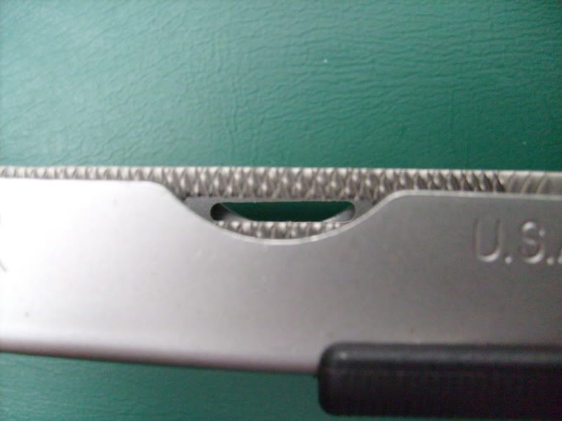

Cable cutter MT's file looks slightly coarser  :think: , I really dislike the holes for file deployment instead of nail nicks. SOG uses holes as well & I find it leads to what ever you are filling catching in the hole  >:(. Not a fan  :D

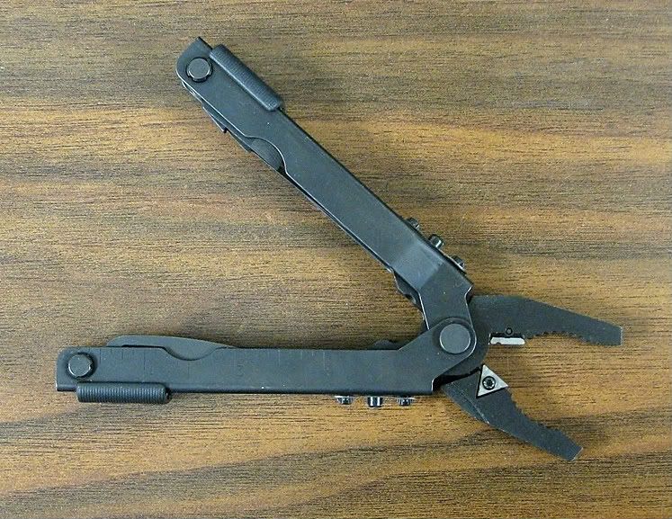

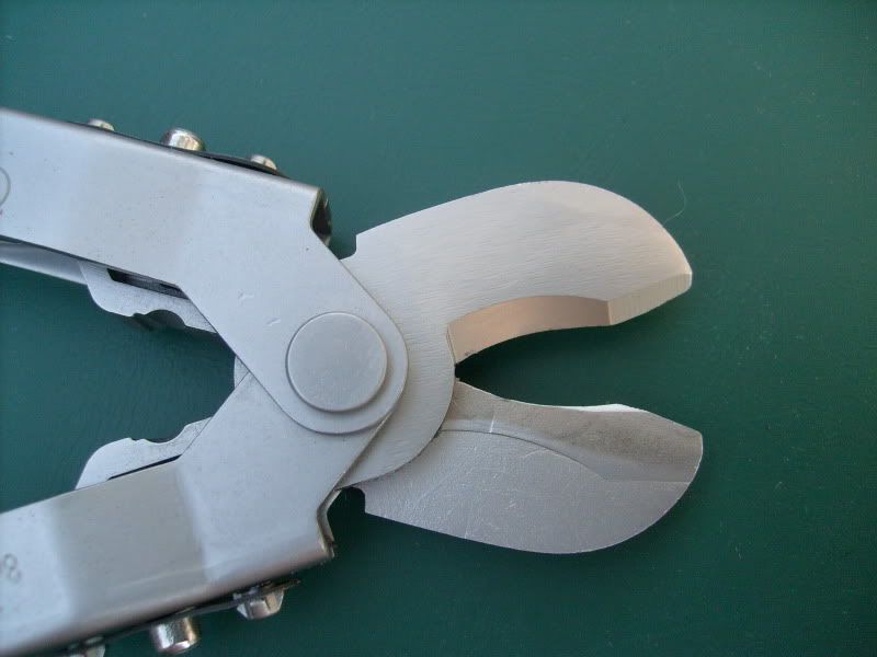

So how does Gerber's Cable Cutter perform as a cutter  :think:................................................... Really badly  ::) :D :D :D.
I grabbed some scraps from my work bench , some very light duty flexible wire , the shaft from a used pop rivet & some thick coat hanger wire.

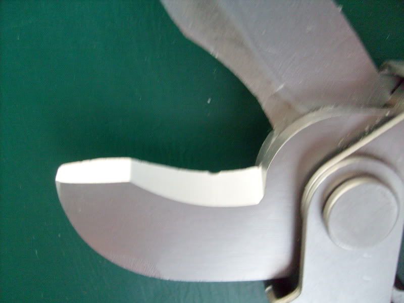

It cut the soft wire no probs , the pop rivet shaft I tried but found I was having to exert a fair bit of force & yet it did not cut. Worse yet it put a very small notch in the cutting edge(Bob is going to be horrified  :D). To prove I was not asking too much , I first used my BO MP600 too cut the scraps which it did(too a point).
http://i291.photobucket.com/albums/ll287/multimat426/Gerber%20Cable%20Cutter/S6303623.jpg[/img]]
Small nick from the pop rivet shaft , I did not attempt to try cutting the thick coat hanger wire with the Cable Cutter.
I think the Gerber Cable Cutter is very much a light duty cutter that performs at a lower level than most plier's wire cutters. Mad isn't  :think: :think:.

My poor old BO MP600's carbide cutters died in the name of my wee test , one shattered & the other cracked.(Dennis will not be happy with me  ::) :D).
The coat hanger wire that caused the damage was quite hard & 2mm/0.08inch in diameter.
http://i291.photobucket.com/albums/ll287/multimat426/Gerber%20Cable%20Cutter/S6303616.jpg[/img]]
Interestingly I had used the MP600 yesterday to cut the same wire when hanging some Elk Horn ferns  :think: :think:.
I then decided to try cutting the offending wire with my LM Surge's hard-wire cutters & my SOG PowerAssist's hard wire cutters. Both the big boys had no trouble but I suspect if I was too constantly repeat the process they would soon become blunt.

The cutters on the Gerber are for copper wire only.  That's why the Powercut was such an interesting tool.  :cry:

In fairness I think the Gerber cutters look like electrical cable cutters.

To answer some of the OP questions:
1.  Yes the Evo 650 had the cable cutter head as an option.  I have it mounted on my 650 as it happens.
2.  Ben is right, it's meant for copper or Al wire only.  It works pretty well upto 12/3 wire cable.
3.  The tools on the 650 differ a bit too, with a jigsaw blade holder built in.

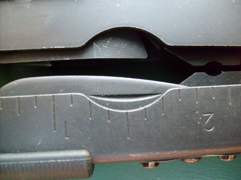

Hey Mat, how about a close up of how well that new nail nick lines up with the cutout in the handle. ;)

No, I meant the nail nick one. (that's why I used the rolly eyeball dude) ::) :D

Oops, now I feel foolish. :-[ Mat I was trying to poke fun at the way the Gerber blade doesn't line up properly with the handle cutout, but they went and changed blades on me. :P Yours lines up just fine!
Here's a pic of mine from a year or so ago. Notice how the fingernail slot in the blade is way off?

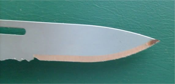

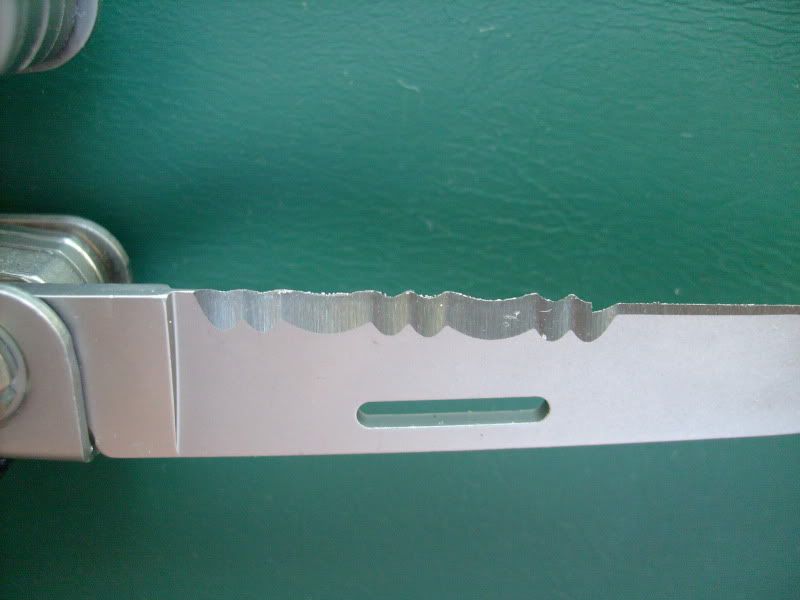

Do not feel bad Bob :pok: :D, have a look at my NEW  :ahhh MP400(corkscrew) serrated blade  >:( >:(
Really badly unevenly sharpened & a notch thrown in for good measure on a new tool  >:( >:(
On the other-side of the blade at the tip there is a blackened bit like it has been burnt  :think: :think:
