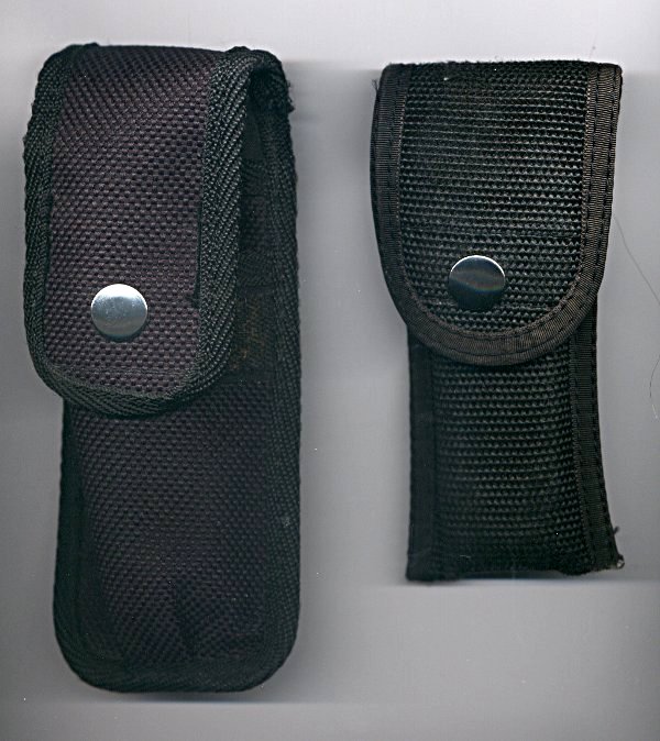

I am not a fan of noisy, lint attracting hook and loop ("Velcro") fasteners used in holsters.   So when the hook and loop wears out, I drill holes through the nylon fabric and install metal snaps.
Too, I use a black felt tip marker to subdue the brand labels or remove the labels completely, as done with the Nite-Ize Mini-Pock-Its shown below.

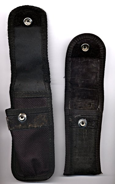

There are two basic types of snaps: post style and prong style.  The best type for use on nylon holsters is the post type which requires making a single hole in the holster cover and another mating hole in the holster body.
Each snap is composed of 4 pieces (see attached photo):
  • cap
  • stud
  • socket
  • eyelet
There are a few ways to make the holes in your nylon holster to accommodate the snap post.  I used an electric drill, but you might melt a hole with a heated awl or nail instead.  Be sure the hole isn't larger than the snap's post diameter or else the snap will fit too loosely.
I placed a small block of wood inside the holster before drilling to avoid drilling through the entire holster and out the back.  :D
Some inexpensive snap assortment kits come with a pin punch-type installation tool which you hit with a hammer.  I found that difficult to use and easy to smash your fingers.  Instead, I use a pliers style tool similar to this Dritz® Mighty Snap-A-Plier For Heavy Duty Snaps:
http://www.joann.com/joann/catalog/productdetail.jsp?CATID=cat2851&PRODID=prd34657
I have 2 sizes of snap, each with different length posts.  If the nylon material is too thick, the shorter post snaps won't reach through.  If you have snaps with a post which is too long, you can either shorten the post using a Dremel tool and cutoff wheel, or just install a washer as a shim.  The latter workaround is easier, though using a shim washer can cause the snap to protrude a little further from the material.
Suggest you practice first on a scrap piece of nylon or leather.
