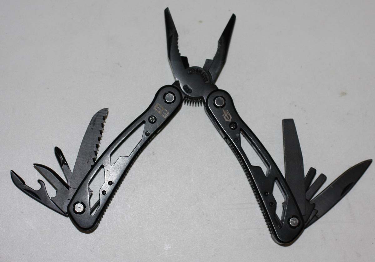

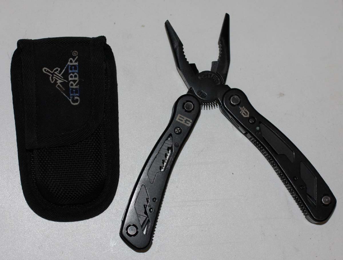

Earlier this evening, I was trying to cut a hairpin - I needed a flat end and this particular kind of hairpin, has drop-shaped ends. I figured that would be no match for the might Suspension; after all, it is a Gerber tool.
So I get the hairpin in the plierhead and press down on it and suddenly... snap! I was kinda surprised that I took so much force, just to break a damn hairpin, but at least I got it. I released the handles and took the hairpin out, only to see that it practically hadn't got a single mark. "Hmm, weird", I thought. "Let's try again". Put the hairpin back in the plierhead, press down on the handles...
Felt wrong - took a look, and realized that the handles closed alot more, than they did before. Took an even better look, and saw that one of the tabs, that locks the plierhead in place, had bend, pretty badly. Not just that, it had actually severed, into two pieces.
On top of that, it seems like there's a hair-split (is that the proper term?) right where the two halfs of the plierhead are connected.
After that failure, I pulled out my MP600 and started snapping away at the hairpins - they practically cut themselves, as soon as they see the mighty MP600.
I'm guessing that I'm far from the first one to experience this, so I'm wondering what your advice would be? Sure, I could send it to Gerber and most likely get a new tool back, but if I have to cover the shipping cost from Denmark to Oregon, I might as well just keep this one and buy a new one from England.
So, what do you say?
P.S: Sorry about the long post - I'm frustated, that my primary EDC-tool has been defeated by a single hairpin...

When I got the plier rests of the pliers, I inspected them and saw that the one which failed, has a hairline fracture, at the point where the pliers meets the handles. Might have been an old damage or maybe even something that slipped through QC at Gerber? The fracture goes all around the post-area, making it look like it's two pieces of metal stamped together. The other plier rest still looks fine, except for a bit dirt and residue of lubricants.
So, at this point, I could just attach a new plier rest and assemble it all again, but as mentioned earlier, I'm kinda interested in making a Gerber-ized version of Kampfer's PLSK. However, the screws at the tool-side are starting to seem like they've been welded together in the middle. I just can't get them loose. I can turn them individually just fine, but when I try to turn both sides together, in order to loosen them, they're stuck. I'm having the problem on both handles. I've tried heating the screws with a lighter, in order to loosen up any Loctite that might be in there, but with no effect.
Well, with a bit of effect... I've ended up partially stripping the screws.  :facepalm:
So, in order to get any further, I problably need to "change" the head of the screws (I don't know the right word, sorry), so I can get a better grip.
I'm guessing the screws are aluminium, since they seem rather soft. Would it be possible to cut a groove in them and then remove them with a flathead screwdriver?
I'm guessing it's either that or carefully drilling them out and either replacing them with something else or see if I can get the originals, either from Ger :gimme:ber or from one of their dealers.
Lastly, I'm sorry about the purple hue in some of the pictures - I had to take the pictures with my phone...
And I'm sorry, if it seems like I'm rambling.  :ahhh

After a minor setback yesterday, regarding some stripped screws, I'm back in action. I used a vise grip and a hacksaw to carefully cut grooves in the screws, so I could loosen them. It ain't pretty, but it works. Right now, the tool is completely disassembled and I'm about to start putting the puzzle together.
I might be able to have tools at both ends, similar to the PLSK, but I don't think the handles are long enough for that.
I'm taking pictures along the way and, if people are interested, I'll make a post with pictures and descriptions. :-)

After fiddling around for a couple of hours, I got the first prototype ready. It took me a bit longer than it should, because... Well, I'm stupid.  :pok: Had a bit trouble, understanding the tabbed washers, that went between the tools and it took me some time, to figure out how to get all the tools and washers on the screw-post, but I made it work.
Still got some work on this prototype though. The Philips driver, right next to the PE blade, is impossible to get to, unless I unfold either the blade or the large flathead next to it. The small flathead might need a new position as well and I'll need either an extra washer or a thicker one, between the small flathead and the scissors, so they'll stay in place.
For obvious reasons, this hasn't been tightened all the way down yet, so I don't know yet if the rattling is due to everything being loose, or a lack of a washer.
I chose to reuse one of the old plier rests, in order to give the handle some stability - in this setup, the plier rest is pretty much the only thing, that makes sure the handles won't get smashed together, if I were to squeeze hard on it.
The tools I've omitted so far, are the saw, the serrated blade, the combo opener tool and the lanyard ring. The serrated blade and PE blade wouldn't be able to work together, unless I drilled a few holdes in the handle and had tools on both ends.
