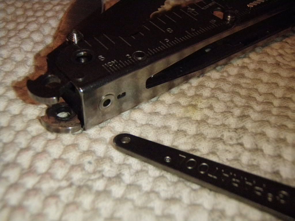

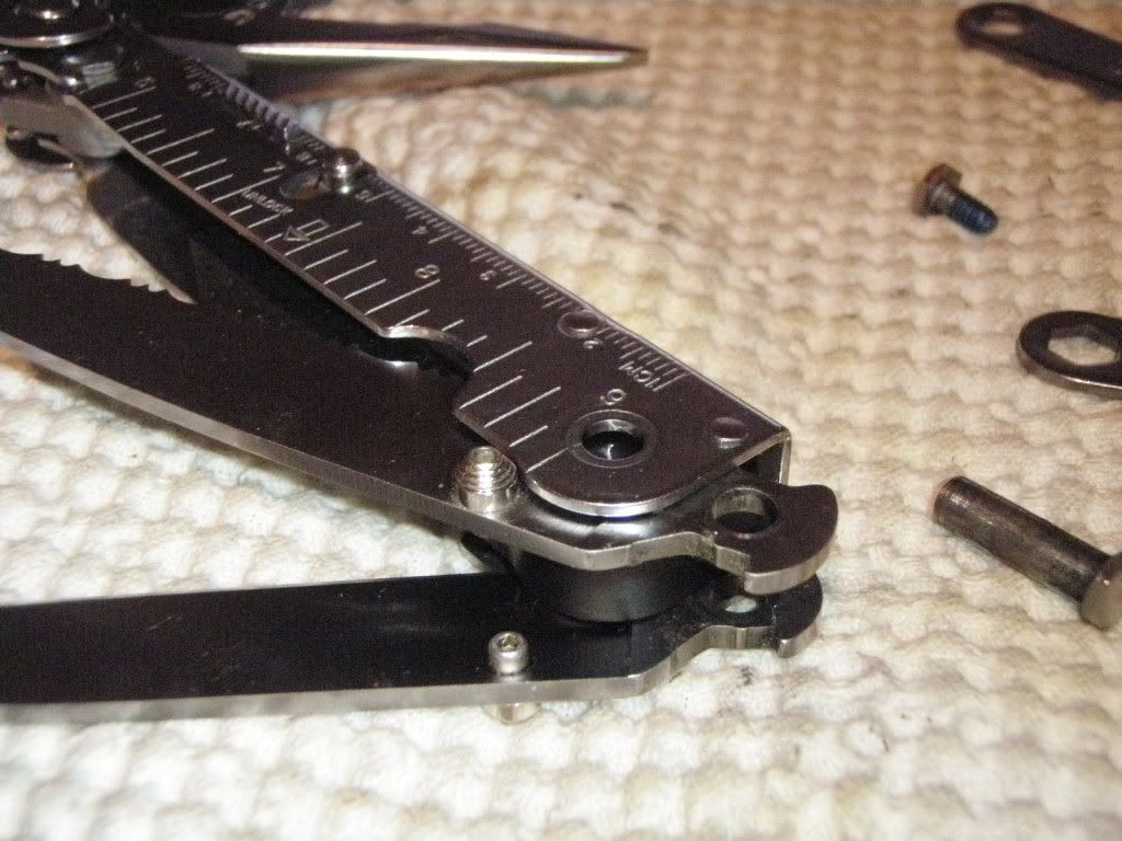

It's a bit difficult to describe, but I'll have a go!
The plastic doesn't appear to be a casing, more a curved shaped "spacer" drilled for the bolt and spring to pass through.
When I removed the bolt, the blades both jumped out as you can see in the first pic. They wouldn't move any further though (i.e. I couldn't remove them from the position you see) presumably because each end of the coiled spring are attached to the blades (I could see the ends of the coil protruding out from under the blade tangs at either side of the plastic). I think that if the permanent rivet (that you can see in the second pic) was removed, the whole plastic, spring and blades would fall out - still attached to each other. I don't think there's any sophisticated mechanism in the spring loading, just a coil passed through the plastic piece. In fact, it's a bit crude.
Does that explain it any better - it's a bit tricky to describe....

Good find jzmtl - that's pretty much what I think was going on inside the Powerassist. I couldn't tell exactly, but I suspect that each end of the spring coil attaches to a blade, and the purpose of the plastic spacer is to hold that spring around the bolt. Simple, but effective.
I wasn't able to see the pin-hole where the spring attaches to either blade though, and didn't want to pull the blades away from the handle for fear of stretching the coil.
A picture speaks a thousand words as they say.
