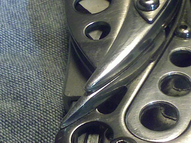

Here is a close-up of the scissors closed. Scissors and liner shaped to match the original scale. I pressed a nodule/bump onto the liner which holds the scissors in closed position, similar to the way the handles are held closed on a Leatherman Crunch. Also, I fabricated a new low profile pivot bolt washer to compensate for some of the added thickness.....
Here's a top view of the two layers while scissors are in closed position.....
Here is a view of the backside while the scissors are closed. Exposed is an extra deep nail nick to easily deploy the scissors.....
