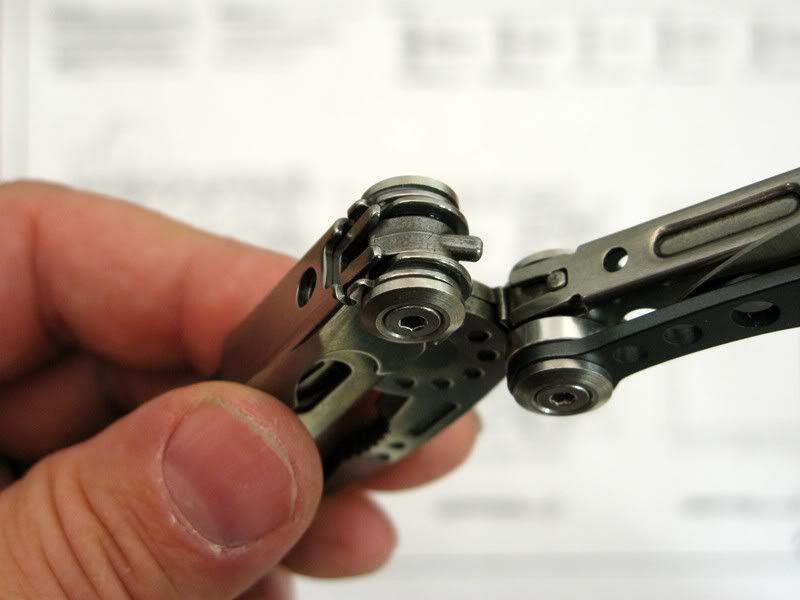

Of interest to multitool engineering geeks (like me!) :P :D it also has a rather clever way of "locking" the handles open. Leatherman pioneered the use of a cammed surface on the plier pivot, which gets tighter as you unfold the handles. When fully deployed, the handles on a Leatherman "snap" into place over a lip in the cam surface, and come up solid against a step in the plier head casting.
On the First Ascent, they solve this problem another way. A "post" is cast into the plier head, which engages a "slot" stamped into the handles. When the handles are fully deployed, the post snaps through into a wider portion of the slot, and at the same time comes up solid against the back of the slot.
Handle on the right hand side being opened:
Handle on the right hand side in fully opened position:
Clever it may be, but I was a bit worried about the strength. :-\ So far though, I've done a fair bit of heavy squeezing on the handles with no ill effects. :)

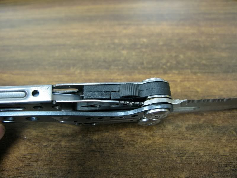

By request, a couple more photos.
Liner lock, and LED switch
Knife closed. Note ball detent on liner lock (and dual ball detents on bottle opener) 8)
