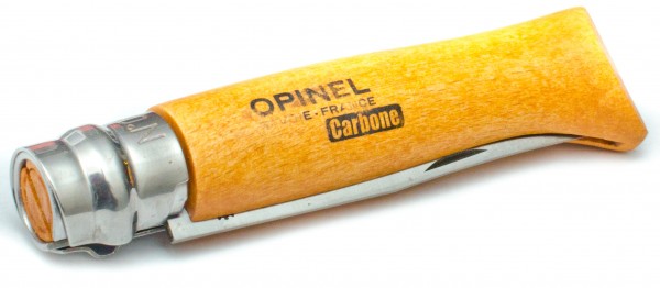

on: August 29, 2011, 09:55:33 AM
I bought a Opinel for $1 that has the tip of the blade missing. I am going to clean it up tomorrow but am thinking I should reshape the blade to give it a point again. I have a Dremel that I plan on using for this. Can anyone give me some tips or is it pretty straight forward? Thank you in advance.

Reply #1 on: August 29, 2011, 10:55:53 AM
Think about bringing the spine down to meet the existing point or you might end up with a sharp bit when the blade is closed, maybe  :think:
Make sure you don't get the steel too hot or it will loose its 'temper' and the steel will be soft
It might be better to use a stone
Good luck Captain  :tu:

Reply #4 on: August 29, 2011, 09:14:40 PM
Thank you sparky415 I did not even think about that. I am going to think about it while I am cleaning it and then make a decision. I will most likely end up doing it the way you suggested. Thank you for the great visual with the photos it helps incredibly.

Here is what I did to it in the last hour. It was my first time reshaping a blade and I do not have a clamp so I had to hold it with one hand and grind with my Dremel in the other. It is much better than it was before so I am happy. I accidentally touched to the tip with the dremel so that's what that mark is on the tip.  What do you think.

Well just tried and that will not work. You cannot close the lock when the blade is in the handle as the blade blocks the lock form sliding past. Any other ideas?
You can see here how the blade blocks the lock.

Yes, it sounds like an older Opi without the additional notch in the Virobloc ring. I use a pair of C-clip pliers like that shown in the link...the jaws spread when the handles are closed. The opening the blade trick on a locked knife never worked well for me.

I just pried it off like in the YouTube video and it worked perfect.  :tu:

Sure do. Putting it back on was the hardest part. It is still tight. Any ideas anyone. Should I take it off and bend it open a bit?

Still tight as in hard to turn? It may be the heads of the pivot pin may be a little high or rough. Have you tried greasing the inside of the locking ring?
