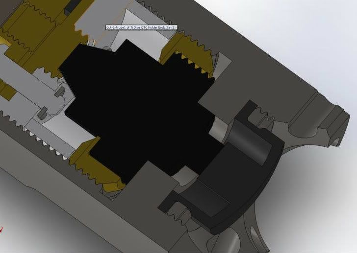

Thanks Muddysuki, should look even better finished.
Your right, the boot placement is not indicative to a good waterprrof seal, especially under pressure.
The render isn't too clear as the boot wasn't modelled hollow as it should be and intersects with the switch unit, but it shows how the boot is held in place by the switch and it's retaining ring.
If pressure is applied to the boot from outside thje boot will deform and possibly compress away from the metal surface it rests on, creating a gap. Therefore alot of compression needs to be applied to the boot, through the switch by the retaining ring. This could cause damage to the boot leading to failure.
THis has worried me for a while so i decided to redesign the tail/switch assembly so that the boot sits on the outside of a solid metal surface with a threaded ring compressing it's base from outside so that external pressure will only force it onto the metal surface harder creating a tighter seal.
When i've done some more work on it i'll do some more renders to show the difference.

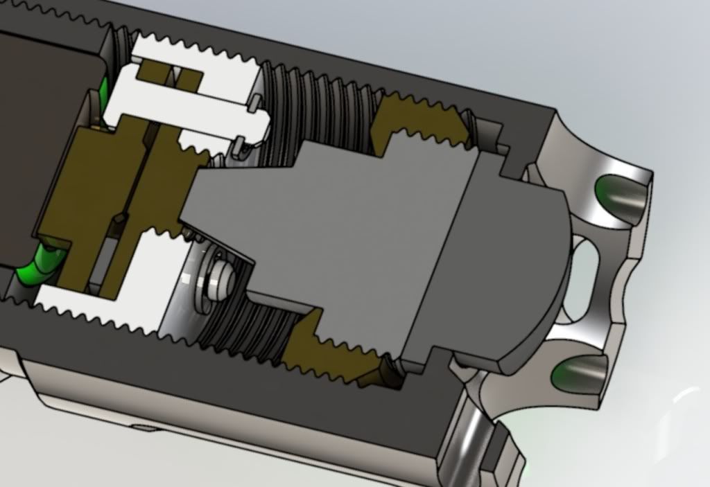

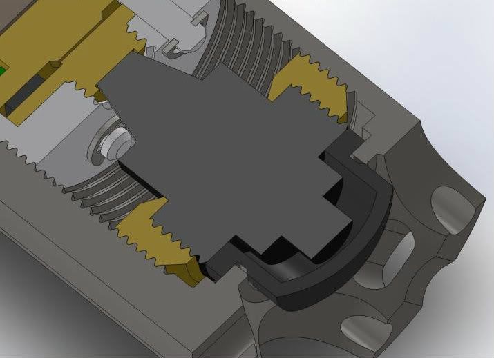

As promised some comparison images of the tail cap seal.
Ver. 1
Ver. 2
The new design comresses the switch boot with a nut ring and when the boot is under pressure it is forced more firmly onto the solid metal backing increasing the seal.
