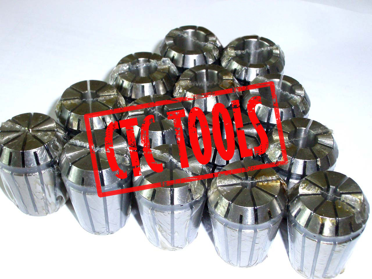

I have the standard collets which is what Im using now, but I did order a set of ER25 ones with a holder.
I didnt quite understand what they were at first, but then when I clued in, I was like.. oh that makes sense.. so I ordered some.
