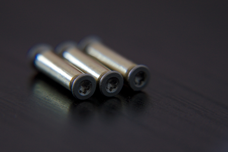

Thank you very much crackout for helping me with the pivots of my new blue Pioneer  :salute:
The standard silver scales have been sandblasted and anodized in blue. Really like this knife  :cheers:

Are those pivots 3mm each?

Yep, they are.

Sad thing. 2x 3mm and 1x2.5mm would have been the non plus ultra to me. In that case, my Sea Ranger would have gone pivot...  ;)
