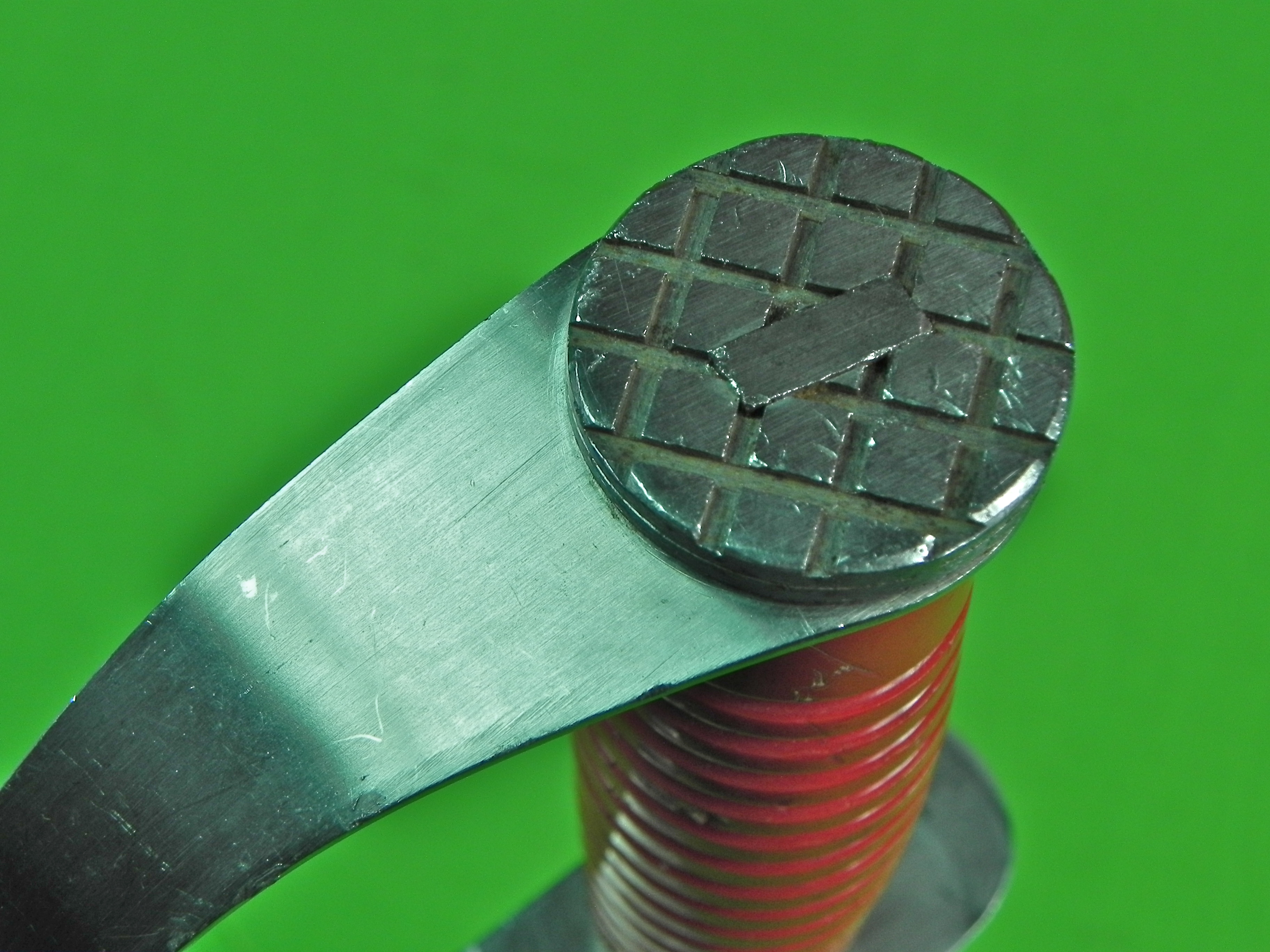

a quick bit of google-fu and it looks like the grip was one pc plastic of some sort. Red for civilian market black for military. But we all have seen the "military issue" claim as a market tool, misrepresentation, or flat out guess before.
I would say find a local knife maker or maybe a gunsmith would be willing to try. I say this because the skill and care of finish is a similar prerequisite for both.
 But see if the pommel can be removed and reinstalled without damage, it looks like it was peened or riveted in place. If it can a new 1pc handle in the original style could be turned on a lathe. If it cant a 2ps pinned/screwed handle is going to be your best bet.
Either way I think micarta would be your best option both for the range of color and durability.
Here's a link to my local knife supply there are dozens of others on the web and around the world if you search I just have this one bookmarked already. But you can have a look at some handle materials to get an idea of your options. They aren't the best on they're color selection in some of the composite and synthetic though, but its a start.
http://www.texasknife.com/vcom/index.php?cPath=587_826
also there's 4 of these currently on ebay all with great photos
Seems these are quite valuable when complete and though "damaged" yours would still be a great collectors piece. But no amount of money can separate a family knife. I know, I still have one of my grandfathers folders packed away with what few albums I could save from my family and the dumpster they rented.
Great knife and his albums too those and what they mean to your family history cant be replaced. So good luck on the project and keep your head up thorough it all.
http://www.ebay.com/itm/RARE-Vintage-FROGMAN-German-Germany-Solingen-PUMA-WERK-Diving-Diver-Knife-/400607654965
