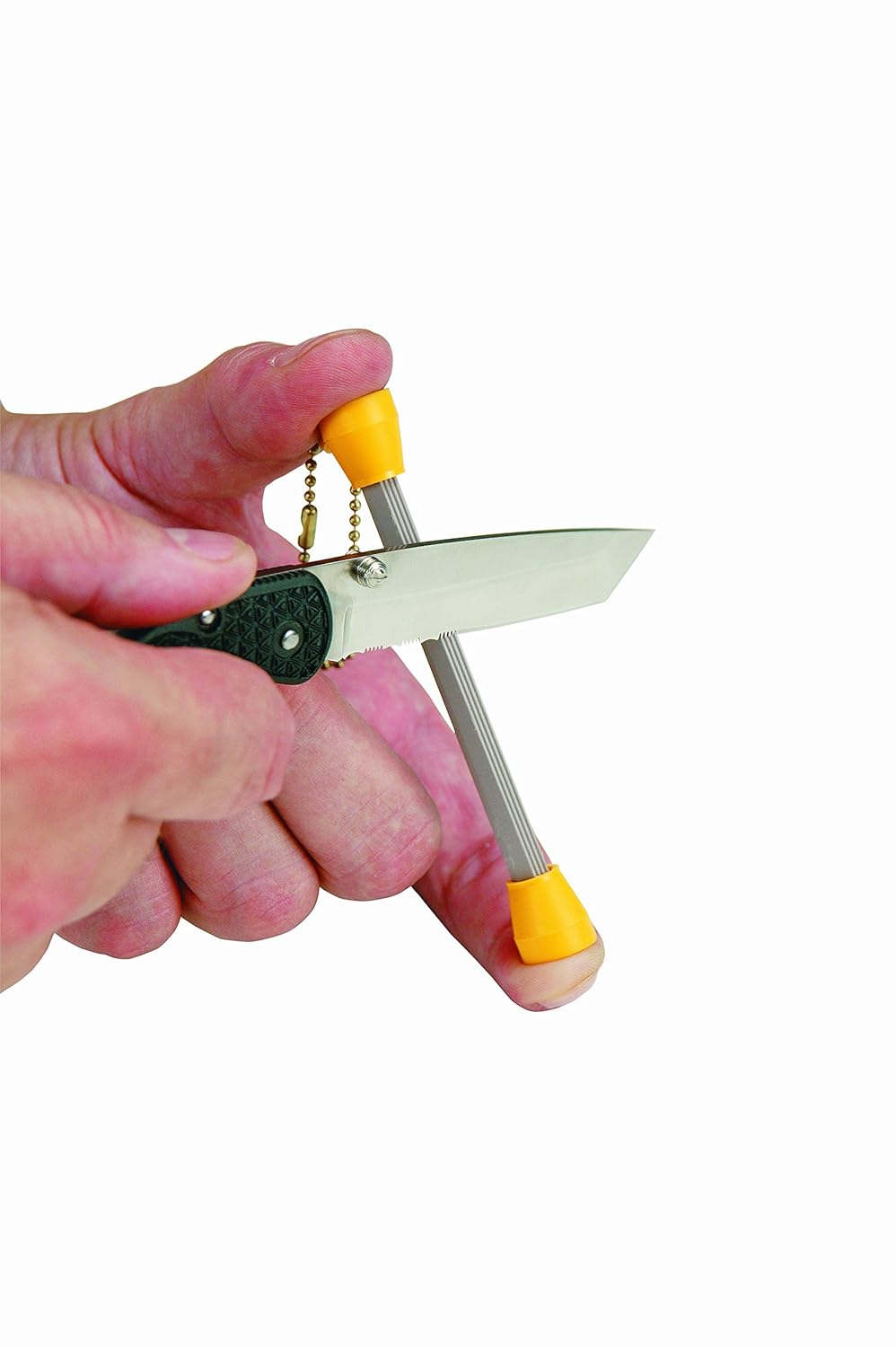

A while ago i bought an old Cold Steel Land&Sea Rescue folder which is a fully serrated sheepsfoot. It has the infamous Cold Steel Microserrations. I would like to sharpen it using one of the system i own, that is Sharpmaker and Lansky (stones for serrated). Any tips? Do and don'ts?
Thanks in advance
Antonio

Lansky sells a Cold Steel serration sharpener for around $8 that works like a charm and fits the serrated pattern of the brand's knives perfectly.
I used the Sharpmaker and similar methods to try and sharpen them but always round the very tips of the finer teeth off. that was until I tried the Lansky specific sharpener. Everything else didn't work perfectly, just meh.
Now it's really easy to get the serrated folders I have from Cold Steel in a couple minutes.
Give it a try!

http://www.amazon.com/Lansky-Steel-Knife-Sharpener-Colors/dp/B001DZFBHS
I found a couple of those for sale on ebay... I ask, of you can help again: is there any difference between different colors? I have found some red ones and it says medium grit, but i also have found grey ones for sale and it is not specified.. ...?! :think:
Antonio
It appears the one you linked is the one speciifcally for the cold steel micro serrations while the others are rods with different grits or multiple grits.

Looks like the grey one is what you want
http://www.ebay.com/itm/Lansky-80999074053-Rod-Steel-Cold-Steel-Serrated-Blade-Knife-Sharpener-4-1-8-/262312485422?hash=item3d130ae22e:g:opAAAOSwG-1WwCOn
