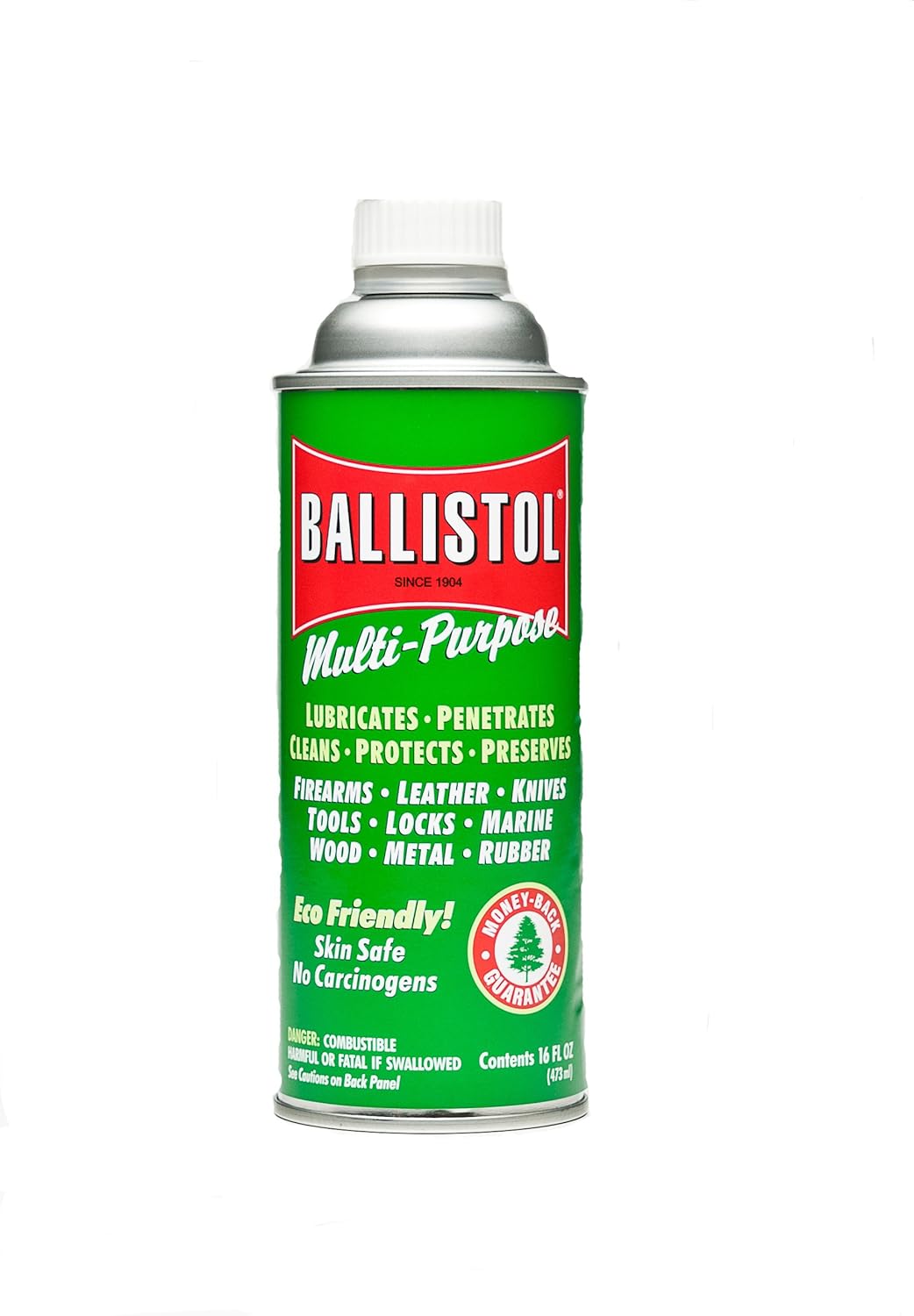

Nice looking set of knives, Barry!
I usually sharpen and strop as I go. If I use a knife, I'll strop it....if I have the chance. I like to keep my knives ready for use at awl times.
For lubricants, I like mineral oil or Ballistol. The drawback of Ballistol is that it can dry and become gummy, so thin coatings are recommended. The upside of Ballistol is that it cleans as well as lubricates--it is sort of the original CLP. It is also non-toxic, so you can use it to clean your knives (and firearms) and not worry about then using them on food or game. Same for food-grade mineral oil.
If I get some real gunk on my knives, I'll clean them with alcohol, kerosene, or WD-40. But, after the gunk is cleaned off, I clean them with soap and water, and then Ballistol.

That Balistol looks great...
US product?
Never seen it here.
Re: Maintenance Day!
Reply #5 on: August 26, 2018, 10:19:48 PM
US product?
Never seen it here.
Mechy, the original formula is from.....Germany. I think that's a country in Europe. So it may be hard for you to find. Let me know and I'll see if I can smuggle some to you.  :cheers:

From the MSDS (Material Safety Data Sheet):
Quote
Most corrosion inhibiting lubricants can only protect against  normal oxidation. They do so by covering up the surface,
which they are supposed to protect, and prevent contact with water and air. Due to its alkalinity Ballistol can also protect
against galvanic corrosion, acidic corrosion and salt water corrosion. Ballistol contains oxygen binders. They make the
oxygen,  contained  in  water  or  air,  unavailable  for  oxidation.  Due  to  its  low  surface  tension,  Ballistol  is  capable  of
creeping into the smallest openings even against gravity. Accordingly, Ballistol provides not only passive but also active
protection against corrosion. However, Ballistol is not a permanent coating or paint. Its protective effect will be the stronger the more often it is re-applied.

Thanks guys!  My yellow scales are my users but I still like to keep them looking good!  I have check out that Ballston Nix.  There's plenty of uses for it around out house!
