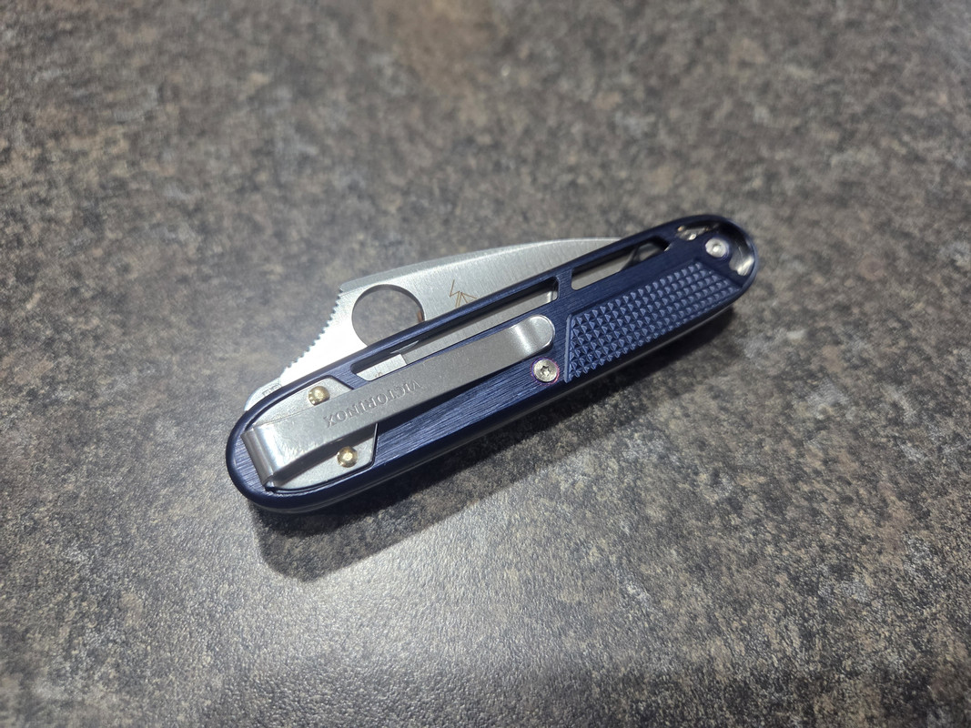

Going be attaching the pocket clip back on, but the hole size in the scale is 2.5mm and the hole size in the pocket clip itself is 1.6mm.  They had the pin step down in size to go through the pocket clip.  Im just going to drill out the pocket clip holes to 2.5mm and not mess with having a step down in size in a super short pin.

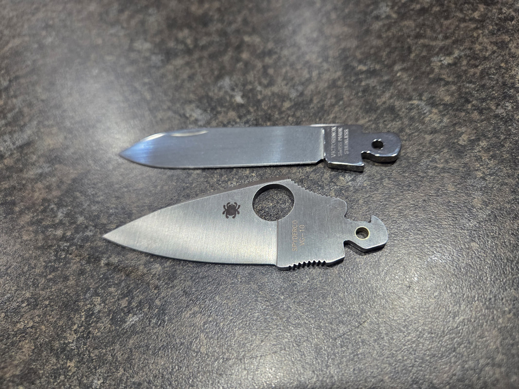

Peened brass into the pivot of the Dragonfly blade and drilled to 3mm.  Also finished shaping the Dragonfly blade for the liner lock, tested the function and works perfect.

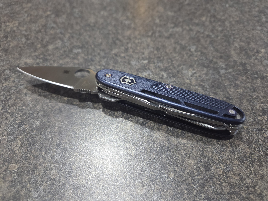

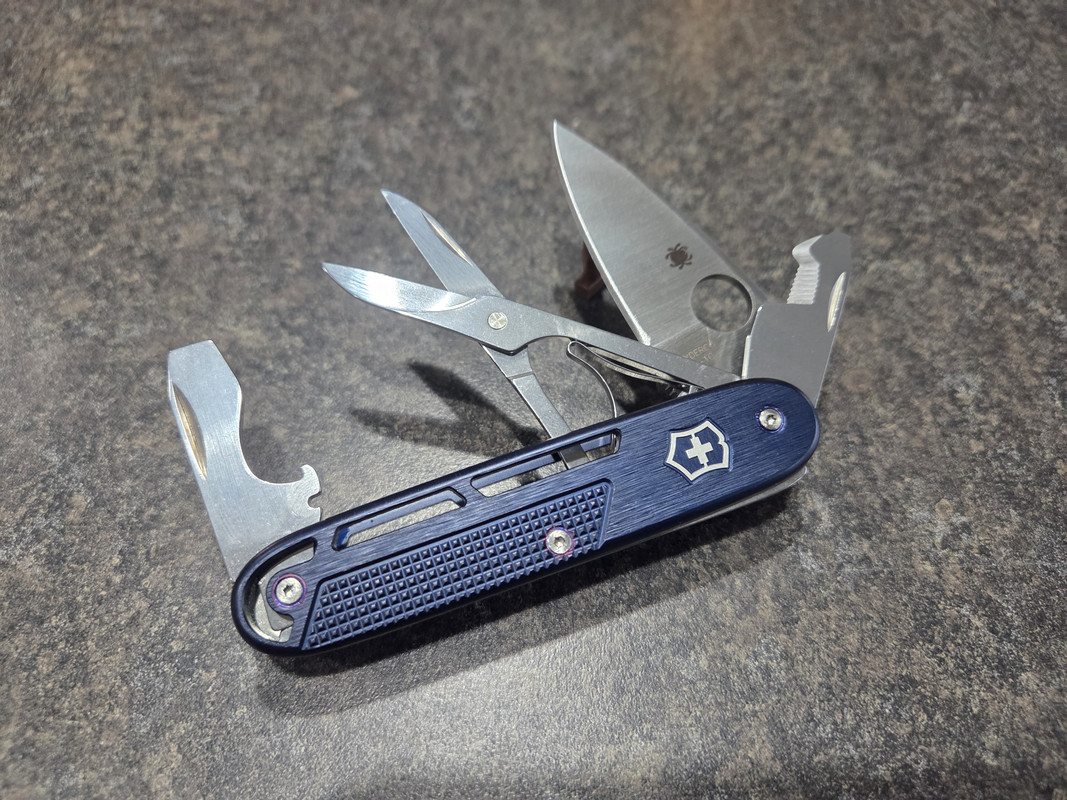

Got the pocket clip riveted to the scale and she's all assembled!  Blade lock works perfectly with the Spyderco blade too!

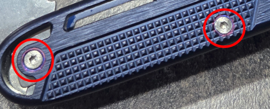

Question though.  What's this different coloration from?  Is it from the rivets and the Victorinox riveting process?

That looks awesome!!
That's a good question, I'm not sure.  When I look at it in person I don't see that.
Heat from drilling rivets affected the anodization?
Eitherway very cool mod and looks like the blade requires less modifying than regular 91mm
Well, when I look at the pics on the other side, it's there too.  I drill the rivets out at low speed, it's not from heat, otherwise it would only be present on the one side.  But again, in person that weird coloration is not present.  I take these pics under multiple light sources, LED, Fluorecent, and  traditional Filament.  Maybe it's just the lighting?
Lets call it character and move on. Its actually kinda cool detail, Id want it to show on eye
