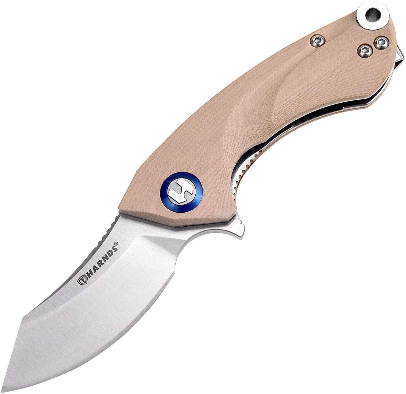

  Amazon likes teasing me. Today it's a Harnds Ballet Folding Knife, made from Sandvik 14C28N, with a flipper. Odd looking knife design, but I'm no blade guru. Not sure if this one is worth $42. Searching says the steel is good, claims to have a ball bearing pivot.
  Comes in Black, Champagne, and //shudder// Pink!
  To save on disk space am going to use Amazon's LARGE photo. Forget the parameters to show it in smaller format.
  Does it look decent :think:, or junk and run away? :ahhh

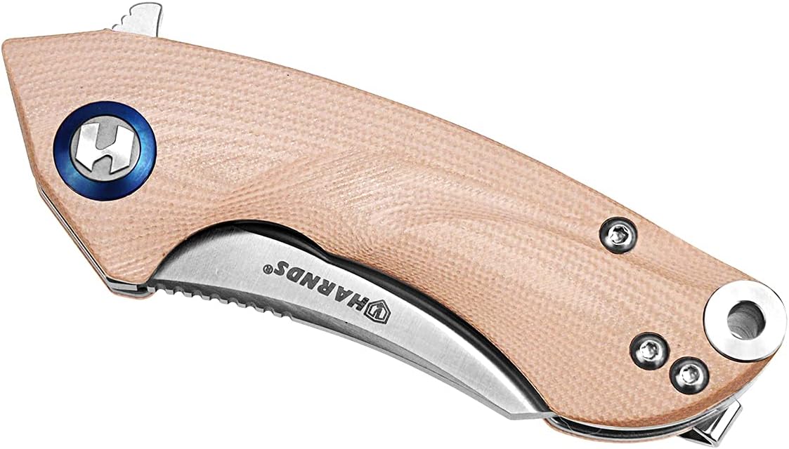

  I really need to look and watch out for measurements. Chinese vendors alter photos, and are always misrepresenting something to make it seem better than what it is
  This Harnds knife is smaller than expected. The hand in their photo must of been one seriously long fingered tiny person, or they enlarged the knife. Had actually expected a hand sized knife. While the Harnds Ballet looks good it does have two flaws IMHO.
  Bad stuff first.
  The size. Blade Length: 2.17" (55mm), Overall Length: 5.71" (145 mm), Closed Length: 3.50" (89 mm). Light Weight of 3oz.
  The sizing is a tad smaller, unless they are reading from the base to the tip.
  Here's the photo they used. Deception!
  Held my my four fingered hand...  :rofl:
  It is an attractive knife for what it is, and flicks open quite easily. But that is where another issue crops up... the liner lock...
  Or am I being too picking and expecting a full lock from the liner lock??
  Please tell me if I am being to critical here. I did have a couple of deploys out of a dozen that the liner did not lock the blade well and the blade was loose.
  So worked the linger lock in and out with a Spirit X flathead screwdriver. There is a lot of friction here, and obviously metal is scraping hard against metal. I did send a message to the vendor and they are expected to reply in a couple of days. Did not mention the size of the knife as it was clearly depicted in the text. Their photo is NOT an accurate size representation - and to me it is misleading.
  [/url]
  And will continue with glamour shots.  :)

  Is it possible the liner lock will eventually wear in? Should I take it apart if I do not hear back from the vendor and see if I can lessen the friction?
¬ Outback Idaho

  Can see where the lock liner is scraping. Bad QA there.
¬ Outback Idaho
