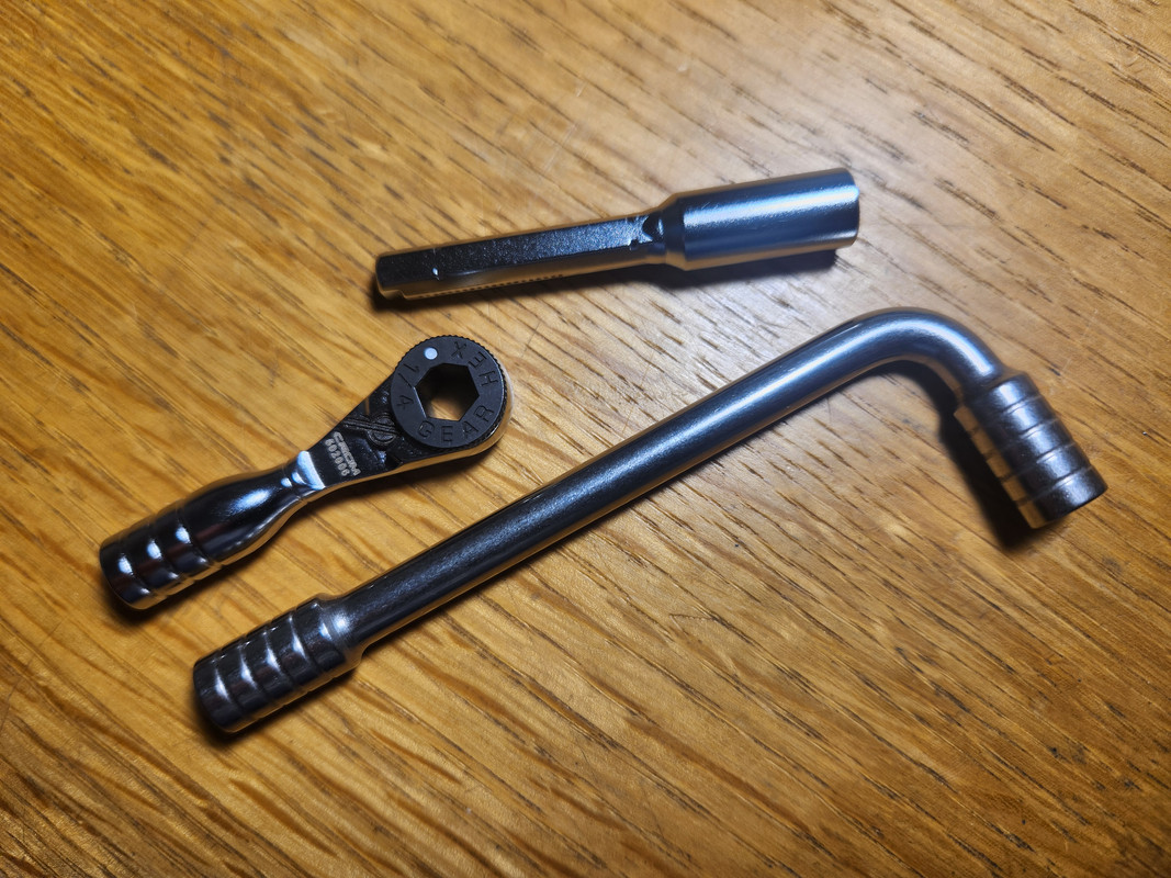

My Crom ratchet came in today.  This thing is tiny.  Pictured next to the Vic driver.  Comes with the extension that can also be used as a T handle, very cool.
    • Posts: 11,957
Re: EDC Bit Ratchets
Reply #256 on: April 12, 2025, 03:02:20 AM
Same dimensions as the 711L, same price, but comes with t-handle extension and has more teeth! I love it already! :cheers:

Couldn't find one of these shipped to the UK so ordered a "KS Tools 918.1590 1/4 Inch Bit Joint Reversible Ratchet Set with Plug Adapter for Sockets, 3-Piece" for $42. The price is a bit steep compared to other fixed head options but I wanted a flexible head.
It's got a 60 tooth ratchet, the total length is a tad shorter than the Rujoi, at 117mm.
Overall the mechanism is nice and I'm pretty happy.
I've got pics but I think I need to upload to an image hosting site first? Visually very similar to the Rujoi, the 1/4 bit to 1/4 drive adapter is good.
