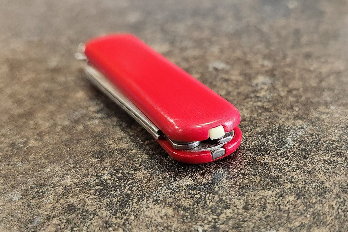

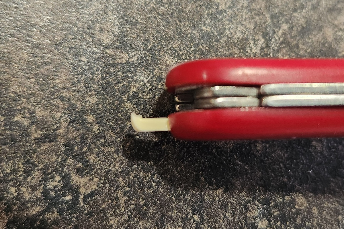

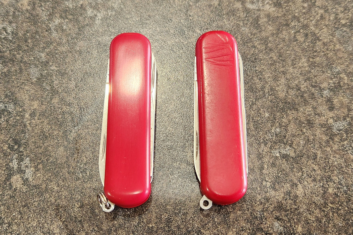

Also, restored one of those Wengers.  It was missing the toothpick, so I modified a Vic toothpick.  I put a notch in it just like the Wenger one so you could access it and reprofilled it to sit flush.  Cleaned it up and oiled it, everything opens and closes with a snap.  Also sanded the scales and somewhat polished them, didn't spend a ton a time on it.  And sharpened the blade.  Everything works great.
Restored Esquire on the left
Thanks to whoever donated them!

Nice job!

They look new! :cheers:

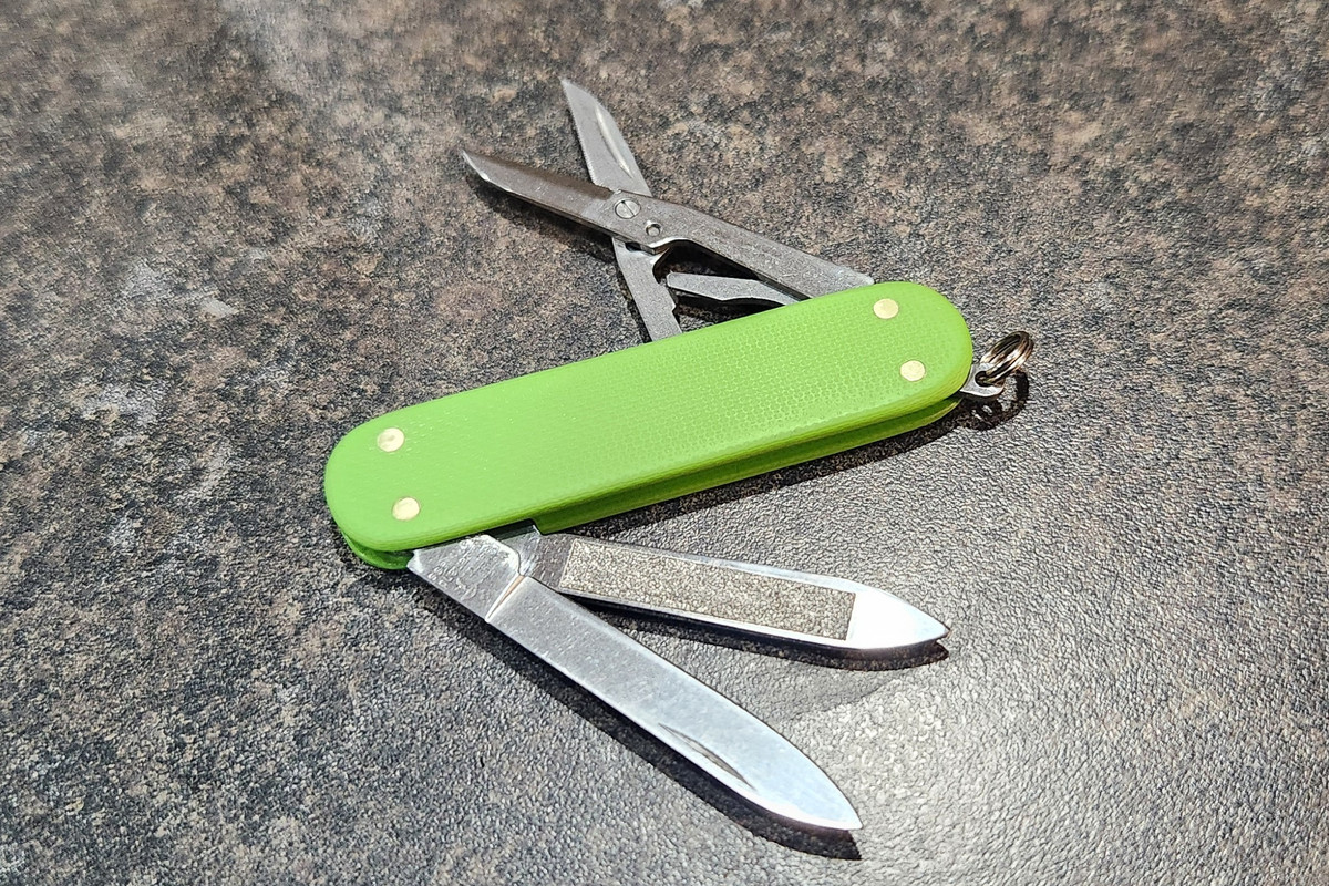

Took apart that second Wenger Esquire.  Made some scales out of bright green G10, peened it shut, and sanded down the rivets flush with the scales.  No tweezer or toothpick, just a nice thin SAK.
Alan, you next?
Enjoy the pics!

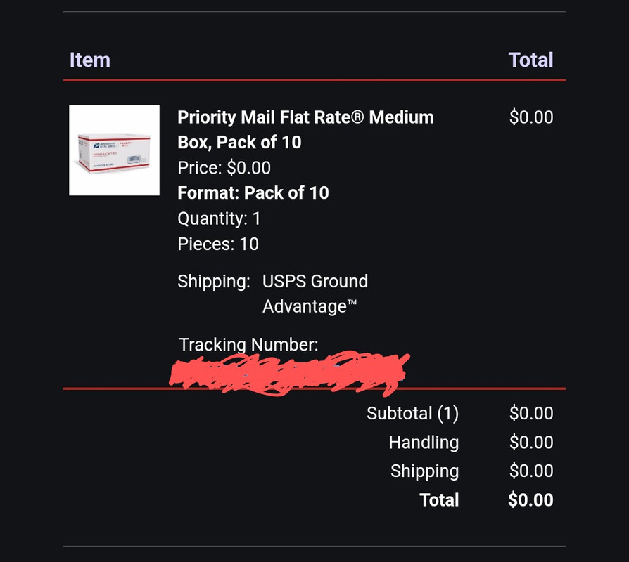

I didnt know this until recently, but you can order any size usps box from usps.com for no charge.  Its very helpful, as my local post office never has small or medium flat rate priority boxes.  They will ship them to you and even provide a tracking number!
Re: Revived Sos Surprise Box GAW ( US edition ).
Reply #1274 on: October 10, 2024, 12:17:40 AM
There was one downside when I did that: the boxes took forever to arrive. Hopefully they managed to get that sorted (it was during the peak of Covid, if memory serves me correctly).
