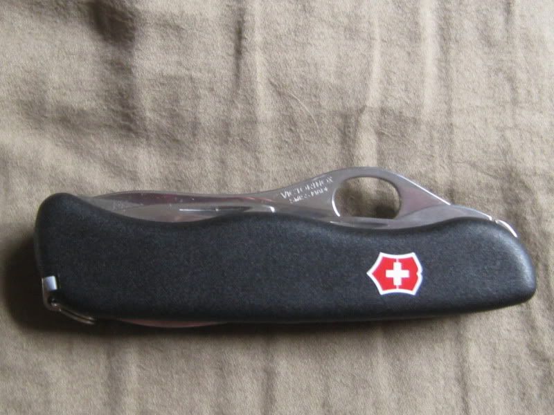

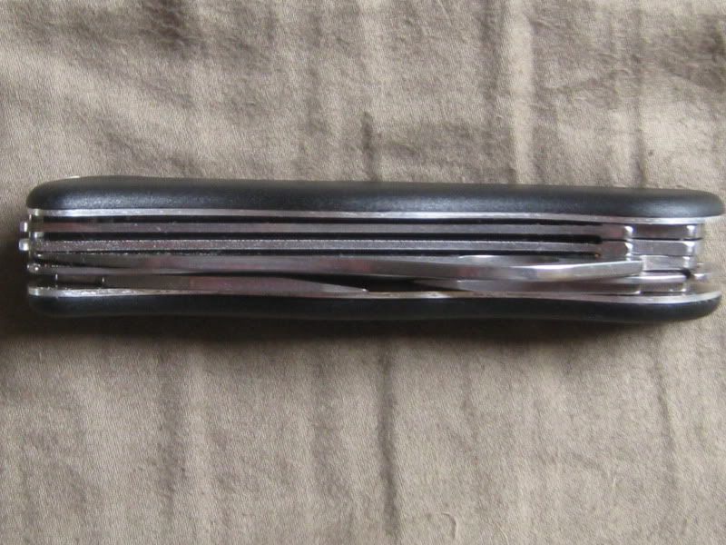

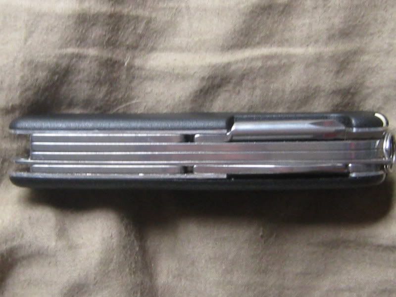

Pics:

What a great job  :cheers:
That is a really useful bit of kit... how much you want for it?  :D

Re: OH Locksmith
Reply #7 on: August 08, 2009, 02:31:10 PM
OMG that looks awesome!
I want...I want!

Reply #8 on: August 08, 2009, 03:50:22 PM
What a great, useful tool.  That is a very very useful mod, great job!! :drool: :drool:
Re: OH Locksmith
Reply #9 on: August 08, 2009, 04:04:02 PM
Hats off to you sir  :salute:  Looks good  :tu:

Reply #10 on: August 08, 2009, 05:02:49 PM
really sweet job :tu:
(now do it again with pics of each step! :pok: )

Reply #11 on: August 08, 2009, 05:51:10 PM
Very nice mate, that looks like an extremely handy SAK. :tu:
