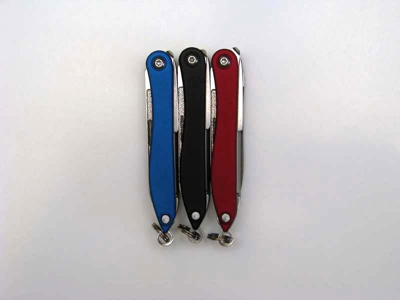

I know have 3 Styles for my collection varying only in colour. The Leatherman Style is a neat minimalist tool in a very tiny package. I dare say the Style is Leatherman’s smallest tool to date. I cannot imagine anything getting any smaller, and still being useful. And therein lies the problem with me, as I will explain my issued with the cute little Style.

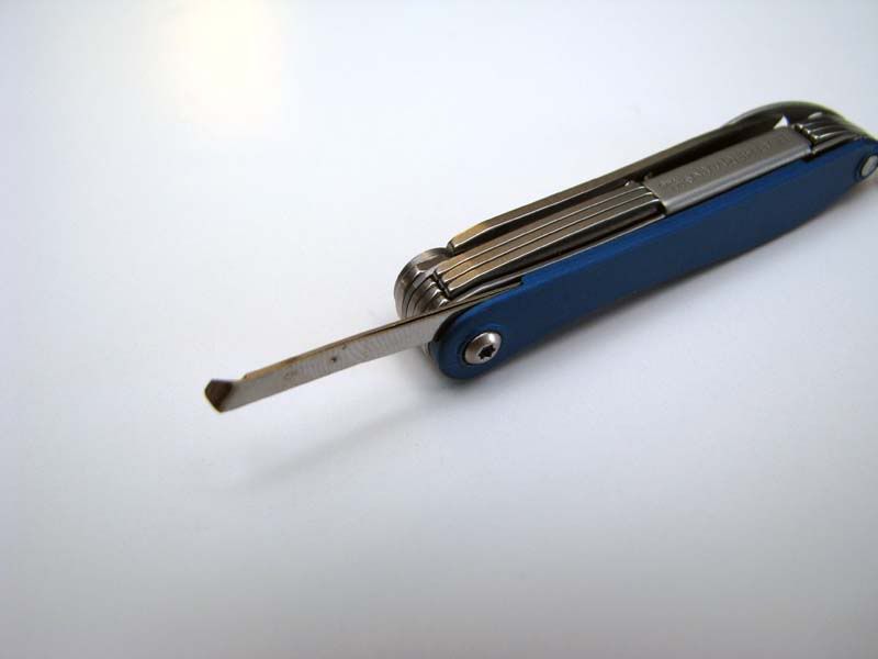

The Style does have good functionality in its tiny form factor. You get a knife blade, a pair of scissors, a combo nail file and cuticle cleaner/flathead driver, and removable tweezers. I sort of think of the Style as a Leatherman Classic or Esquire minus the toothpick.
(Note the tweezers are angled, and the Style does have plenty of style)
(The removable tweezers)

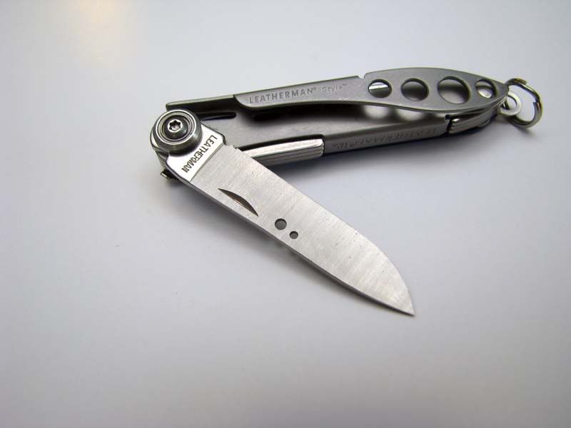

I want to like this tool, but I just can’t. My reasons are many fold, and most of them stem from lack of ergonomics and usability.
The knife blade is rather stylish with all those holes. Mind you, I have some serious issues with where they decided to place the nail nick. It is too close to the rotation point. Its location means you have to use a bit of force to open the blade. Now if they exchanged the location of the nail nick with those holes, all would have gone much better. I read somewhere one here that someone modified their style with a thumb screw through one of those holes in the blade. It gets even more puzzling when you consider that the liner was cut adequately to put that nail nick anywhere on the blade.
(A case of style over function)

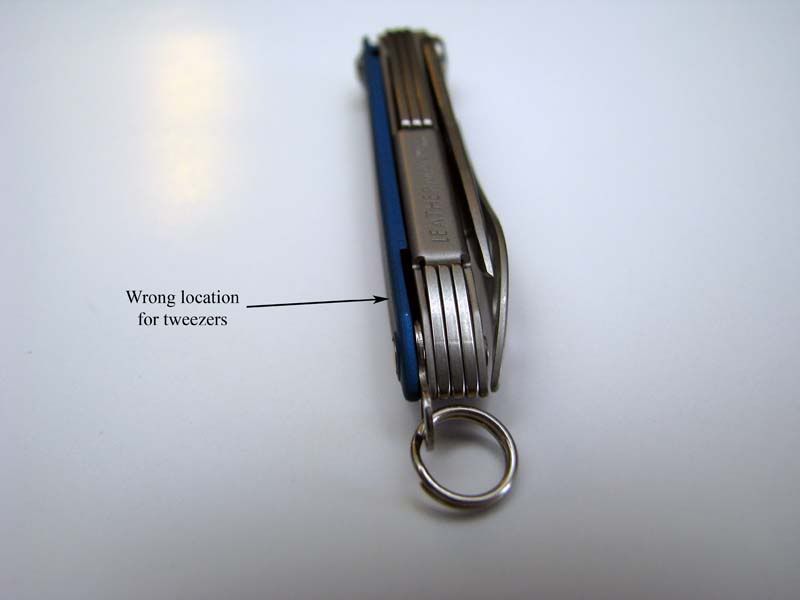

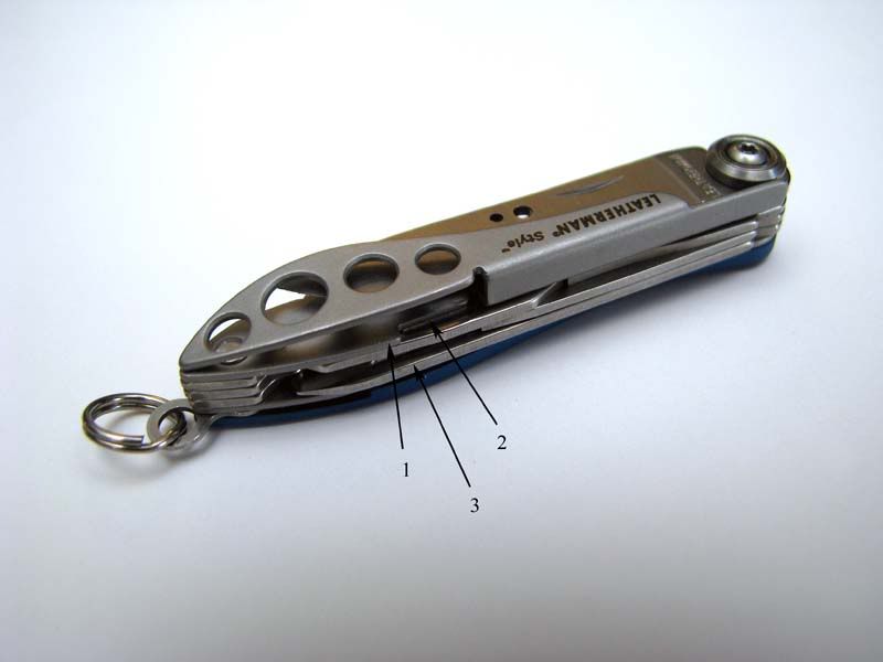

Another issue stems from the location and design of the tweezers. Don’t get me wrong, I do like removable tweezers. I had no issues with their implementation in some of their Juice models. On the Style however, it is a different matter. I believe it stems from 3 things that I find annoying.
1.   The tweezers on the style are jammed like an afterthought between two aluminum liners, unlike the smooth as butter plastic holster type found on the older Juices. Metal on metal only serves to increase friction, thereby making them harder to get out then they should be.
2.   The tweezers bent fingernail end fits too tightly to the body of the Style if you jam the tweezers too far, or heaven forbid, have them in your pocket and something hits them home. Once this happens, you will need another tool to get them pulled enough away from the main body to be able to get your finger nail under it. Couple this with item number one, and you can see how attempting to pull out the tweezers can be a fun exercise.
3.   The Style has what would appear at first glance, two places to put the tweezers away. Please don’t laugh, but I managed to jam one of the tweezers into the “other hole” unwittingly while not paying full attention. I only realized what I had done when I couldn’t push the tweezers past the half way mark. Once I looked at the Style, I realized what I had done, gave a silent curse to the designers, and attempted to pull them out again. Another MT came to the rescue with no damage to anything other than my patience .

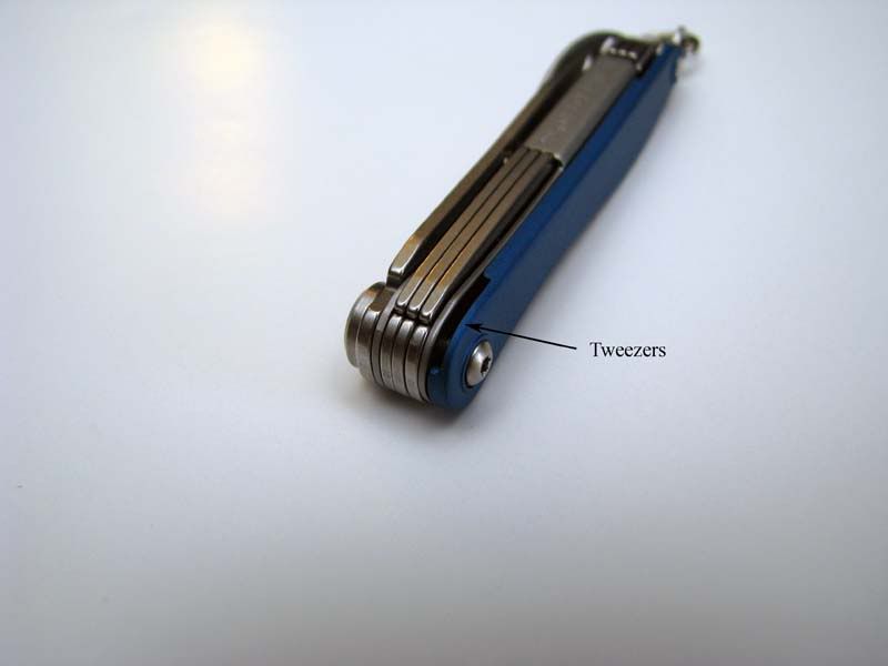

(This is the right slot or hole for the tweezers)
(On the same side of the Style, but on the opposite end, lies a trap! Only hardy fools should venture forth)

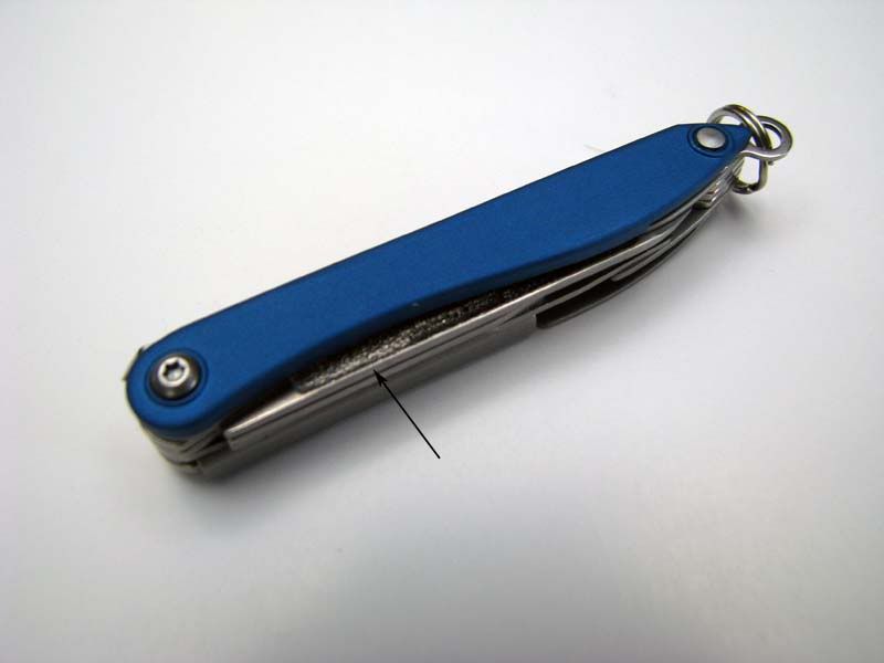

My annoyance didn’t end there. I will admit the tweezers gambit was my fault for not paying attention to the critical operation of ramming those tweezers home in their right spot. But this next one had me further wonder just who designed this tool. The nail file has what I shall call, a fake nail nick on the file side. I figure this was included just so you can hand out the Style at parties and laugh at your friends when they can’t open the tool. Yeah, that must be it. Anyways, the fake nail nick gets me every time. This is probably because the real nail nick on the back is harder to get at then the fake one.
(The arrow shows you the fake nail nick. It even is partly indented enough to fool the eye into thinking your nail has to go there to open the file. Of course, the shallow indent’s file texture only makes you think you have enough grab to open it when you don’t. Now that small indent might make a neat little hook sharpener, but if that was the case, why didn’t they put it somewhere where users won’t think it is what it isn’t)
The nail file isn’t the only tool that causes me grief. The scissors also give me grief. I find the scissors very hard to open. They partially hid the nail nick for this tool under a liner. Why they did this is equally puzzling from the standpoint of ergonomics. Likewise, the real file nail nick is hard to get likewise.
(See 1 above..the liner has that wonderful non cut away section just to make opening your scissors more challenging. 2. Here is the partially hidden scissors nail nick. 3. The equally hard to get nail file nail nick found on the opposite side of the fake nail nick)
(A better look at that protective liner at 1, the real nail file nail nick at 2 which is a bear to get at when the scissors are stored away, and the odd placement of the nail nick on the knife blade at 3)
