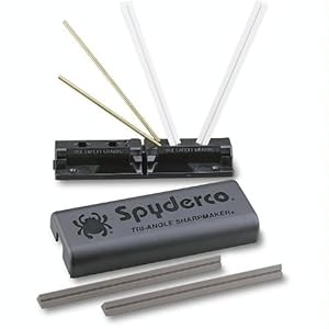

Could those serrations actually be the grain of the steel?
Myself, never have paid attention to the grain as have been using the Sypderco Tri-Angle Sharkmaker for several years now.
Grabbed my 10x jeweler's loupe and inspected the blade edges. All the blades still show the grain.
Looked at the Charge TTi, Skeletool CX, Juice KF4, and the 0893 PST and all have that same grain like your first photo shows. Even the serrated blades on the Juice KF4 and Charge TTi show the grain; although the KF4 shows some saw-tooth-like area towards the end of the blade.

Up until recently I've favored the ceramic rod style, in the "V" configuration for pocket carry. I like being able to sharpen "on the go" :) That is until I got my first flat diamond stone...
I had always thought they were a little gimmicky, and more of a gadget that anything else. But I picked up a folding pocket one, just to have something flat to keep in a Maxpedition organizer. Now, after using one, I am converted. They are amazing, I don't think I'll ever be able to give them up.
