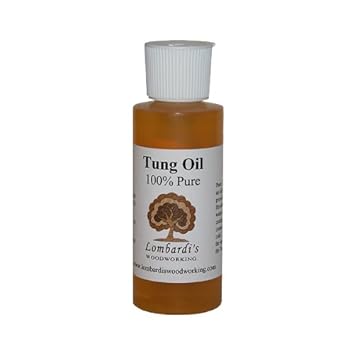

  Trying to find Tung Seed Oil proved elusive today. There was that fake Minwax stuff at Home Depot, yet no one here had the real juice. Two stores did have boiled Linseed oil. Yet to get the real McCoy had to place yet another online order. Found a 2 ounce bottle of it on Amazon, for $4.
  While at Home Depot picked up a few supplies: Locktite epoxy gel, drill bits, sandpaper, Elmer's wood glue (mix with sawdust for filler if needed). Also found a manual sliding caliper in mm & inch measures for $8.
A bit off topic but if anyone in the US needs supplies for finishing wooden scales like these, let me know.  It's what I sell for a living, and I can get a good price on all sorts of stains and finishes.  :tu:  Sorry but I'm sure I wouldn't be able to ship overseas....  :(
us Offline Outback in Idaho
    • Posts: 5,319
Re: Wanted: Detailed Diagram of the 91mm Plus Scales
Reply #45 on: February 11, 2013, 04:55:58 AM
  Rats, wished I knew sooner. Live in Idaho myself. Only my inner essence lives in Australia.  :D

  Now the fun begins. Hopefully the 100% Tung Oil will arrive by the weekend.
