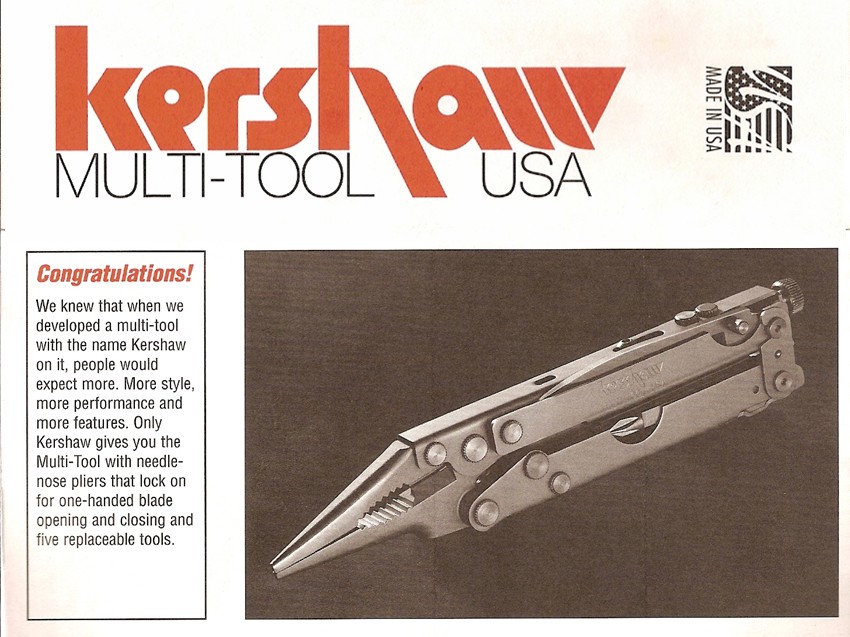

Reply #23 on: June 18, 2008, 03:44:28 AM
Hmm. I could swear I saw one once with all hex hardware but I can't find any evidence to back my claims up. It could have been a pre-production catalog image or a different tool all together that I am remembering.  ???
I did find this picture but I'm not sure what the fasteners actually are since you can only see one side. It looks like a catalog promo shot from Kershaw.
http://www.multi-tool.org/a100flyc.jpg/a100flyc-full;init:.jpg
Re: Kershaw A100 (spoonrobot photo essay format)
Reply #24 on: June 18, 2008, 03:46:49 AM
Very interesting. Those screws look the same as the rear two shown in the user's manual.
