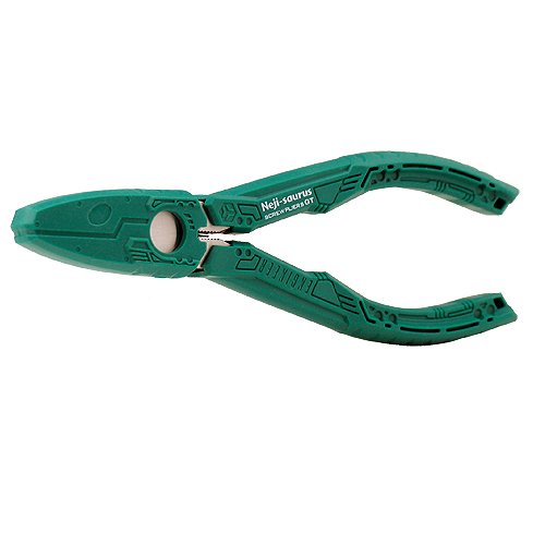

I also ordered 2 of These Pliers

well, that just proves I did the right thing and ordered some of these
If I can help, let me know
Vladimir got a pair of those not too long ago. Maybe he could let us know how they work until you get yours.
Breezy has two of them too, He said they work great.
I ordered them from amazon, but the estimated delivery was a month out,  even though the seller in in the US?   :facepalm:
they are fantastic! my only regret is not buying them sooner. ;)
they not only make it easier to undo the knurled screws, but they also get the job done cleaner. if you're careful, you can get a tool disassembled without marring the knurled screws at all, and even if you're not careful, the damage will be minimal... MUCH less damage than you get from a Crunch/Vise Grip combo (my previous method). :tu:
