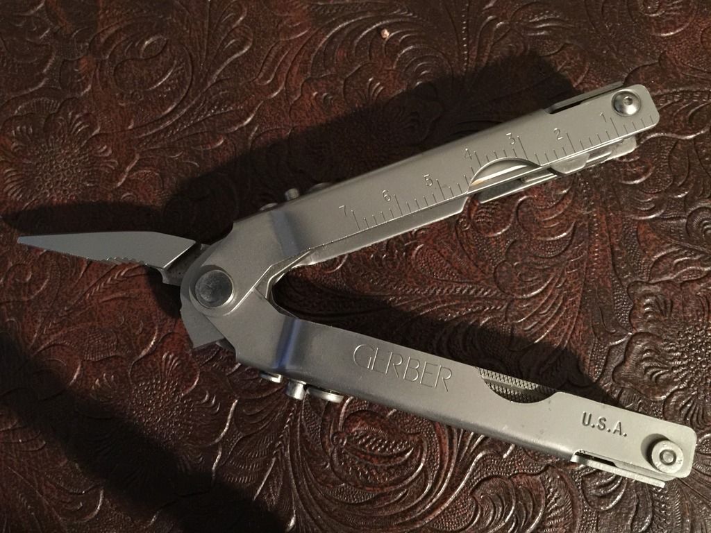

Re: mp600 question
Reply #6 on: May 14, 2015, 01:54:13 AM
It isn't difficult to lego one together.
My lastest version of FrankenGerber.
Pic from yesterday.

Re: mp600 question
Reply #8 on: May 14, 2015, 01:04:14 PM
So what is involved in the mod?
You have to find a combination of tools and washers that fit the handle and clear the pliers.
So you can't just buy parts, you have to cannibalize them from other tools?
Correct.
What's needed to take them apart?
I did the first one with pliers.
Now I use an empty handle as a spanner.
And a lighter to heat the loctite.
Has anyone snubbed the nose on a BO Diesel?
I don't know about the Diesel but with the MP600 the stock needle nose has a smaller nut gripping area.
What you really want IMO is the stock blunt nose.

Re: mp600 question
Reply #10 on: May 14, 2015, 04:44:18 PM
Thanks, Z.  Same story for washers as parts?
All good mate.  :tu:
Yes the washers also come from the donor tools.
Get three MTs.
From these you can make two MTs, one you want and one for backup.
The third gives you extra washers, some spare replacement tools and a handle to use for a spanner.
So I will end up with a blunt nose mp600 and the previously mentioned mp400 to be cannibalized.  Please explain using the handle as a spanner.  Is it the plier side of the handle or the tool joint side?
Have a look at this thread.
FrankenGerber Kit and Gerber maintenance tool
If it still doesn't make any sense I'll attempt to explain it.
Re: mp600 question
Reply #29 on: May 18, 2015, 05:02:39 AM
Here's another one.
Gerber Multiplier mangling
I didn't bother making actual spanners, I left the handles complete and just pull the locking tab back when using it.
