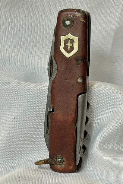

SAK? Spartan set. Got to be over 100! Has a shield but.....

au Offline Huntsman
    • Posts: 5,344
Re: SAK / Swisstool dating and identification resources
Reply #104 on: September 19, 2025, 04:31:50 AM
Interesting SAK ........ But probably not a SAK    :pok:   ;)
us Offline UscgSal
    • Posts: 1,110
  • JOIN Knife Rights!
Reply #105 on: September 26, 2025, 07:01:08 PM
I have heard that Hunts, I spite of the shield.... Noted the crown on the blade?

    • Posts: 2,816
Reply #106 on: October 01, 2025, 05:40:10 AM
Are there any other markings anywhere?  It don't think it's a Queen Cutlery tang stamp but I can't tell too well.

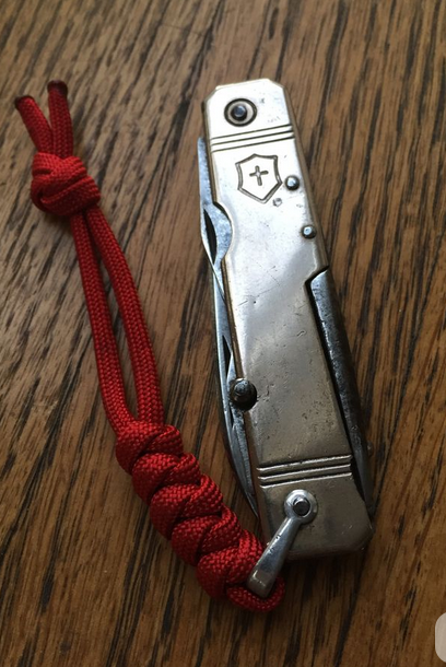

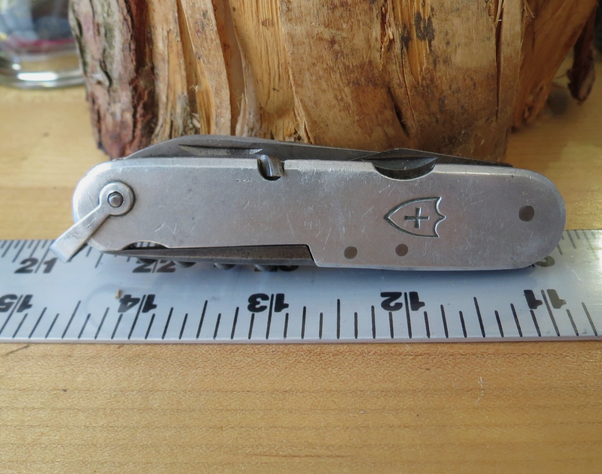

    • Posts: 2,816
Reply #107 on: October 09, 2025, 11:58:27 PM
UscgSal's SAK-A-Like really grabbed my attention so I went digging to see what I could find.  The scales remind me of a Pradel so it may be French knife.  Other companies copied the cross and shield as well.  If you click on the pictures it'll take you to the links I found concerning them.
