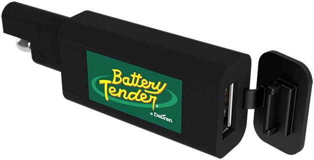

Also... 12v USB port? :dwts: Pretty sure thats not a good idea.
12V source. Basically I wired a pigtail adapter from the backup unit's connector to a 12V SAE battery tender connector, so I can use this:
