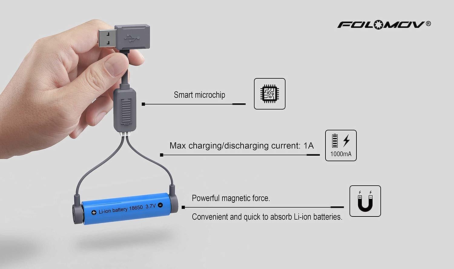

Thanks for the responses, my idea was to buy a 21700 flashlight because of the high capacity and the model I have in mind (the Fenix PD36R) has also a USB-C port which many older models do not have.
My reasoning was that ofcourse I can bring a seperate powerbank or a seperate charger with powerbank functionality but this means carrying around another device. I rarely use a powerbank so it's more for an emergency, that's why I really liked the concept of a dual use flashlight/emergency powerbank.
In the meantime I think I have found a solution that works even better. Because I read the AceBeam cells are not of bad quality but they do have less protection built in then Fenix cells.
I found this device that is called the Folomov A1 and there is also a Nitecore version called the Nitecore LC10. These magnetic cables with a built-in microchip can both charge and discharge almost any size Li-ion battery. It is actually perfect for my use I think.

I like that Folomov device...seems like a great idea. I have one of the Olight chargers that is similar, but it doesn't allow it to be used as a powerbank.
I have the Xtar BD2 smart charger and it has the ability to be used as a powerbank. I have used it to charge my Asus tablet before so it puts out pretty good power.
