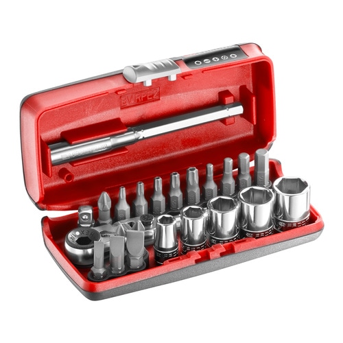

I just got the FACOM R1PICO-NOR in the mail today.
I won't make a dedicated review of it as it the ratchet is basically the RUJOI that RP already reviewed.
all I can say is : it's not worth twice the RUJOI if you don't have use of the box (that is of good quality, much more compact and really well engineered).
(above is the R1PICOPB)
I got this one for about 85€ including tax and shipping (it was like 50£, but UK being no more part of EU, taxes are not forgotten :twak:).
the set is based on the FACOM R.180A:
Official product description of the ratchet :
    The compact head allows access to difficult areas when us ing bits 6-point 1/4".
    Flexible head 180 °.
    The button to lock the head in position. 13 locking positions
    60 teeth mechanism for a recover y to 6°.
    Reversing lever: easy even gloved hand. Allows visualisation of the direction of rotation.Use with square sockets 1/4 “through ECR.1 ada pter.
    Comes with a through ma gnetic extension 100 mm for use “T-handle” (EF.R180). Weight: pawl 70 g, 40 g extension.
Por whose who are interested, here are descriptions and part numbers of the content :
  • 1 x 1/4" ultra-compact flexible ratchet: R.180A.
  • 5 x 1/4" metric 6-point sockets: R. 6 - 8 - 10 - 12 - 13 mm.
  • 1 x extension: L 100 mm (EF.R180).
  • 15 x bits - 1/4" drive bit - 6.35 mm - L 25 mm:
    - EP.1T for Philips® head screws: PH1 (EP.101T)- PH2 (EP.102T).
    - ES.1T for slotted head screws: 3 (ES.133) - 6.5 (ES.136,5) mm.
    - EH.1 for metric 6-point hollow head screws: 2 - 2.5 - 3 - 4 - 5 - 6 mm (real part number is build like this : EH.102,4 for the 2.5 mm bit and EH.106 for the 6 mm bit).
    - EXR.1 for vis Resistorx® screws: TT10 - TT15 - TT20 - TT25 - TT30 (EXR.110 to EXR.130).
  • 1 x socket holder bit: ECR.1.
  • 1 x BV.RPE2 yellow box, the bit holder is actually made of a semi-rubberized injected plastic that won't come out: It comes through the main frame and works both as box shell and bit holder
main difference between the "Special Cyclist Edition" and the R1PICOPB:
  • in PICOPB that is not in PICO-NOR:
    - ED.1T for Pozidriv® head screws: PZ2.
    - ES.1T for slotted head screws: 4.5 - 8 mm.
  • PICO-NOR that is not in PICOPB:
    - ES.1T for slotted head screws: 3 mm.
    - EH.1 for metric 6-point hollow head screws: 2 - 2.5 mm.
NB: The box has a very nice shade of yellow.
NB2: The box alone makes it a good alternative to the RUJOI if you can afford it.
NB3: I wouldn't be surprised to find other Stanley-Black&Decker's brand that would be exactly the same as the FACOM R1PICO, but I couldn't find any yet.

Apparently, FACOM ratchet and extension alone, without box or bit/sockets can be found for 40€, about the price of the whole RUJOI set.
I'll try to find a RUJOI ratchet and extension, to make an indepth head to head comparison.
A very similar ratchet can be found under the KS Tools brand, either stand-alone or in several sets reminiscent of the Facom.

Reply #126 on: August 10, 2022, 09:14:12 PM
You are absolutely right : it is even cheaper than the RUJOI (25€ on amazon)
Bits visually seem of much lower quality though
PS: I ordered one so I can make the comparison.

As expected with a bit of research,
Another Stanley black&decker brand does sell the same tools as you can find FACOM branded : USAG (Italian brand apparently): 606 1/4 SK, can be found for 50€ on Amazon. (If you don't need sockets, it looks like a much better deal).

Reply #128 on: August 14, 2022, 05:21:15 PM
Ok, got it today : the KSTOOLS kit is of MUCH MUCH lower quality.
  • The ratchet looks similar, even a few mm longer than the FACOM
  • The extension/T-handle is almost identical
  • The box feels cheap, the bit holder part is of added material and not as grippy (and it's black, not read as on the box pic)
  • The ratchet mechanism isn't as clicky, the hinge isn't as smooth and presents some visual defects
Is is cheaper, and... it is cheaper, should be okay for most work though  :dunno:

Reply #129 on: August 14, 2022, 05:33:08 PM
The handle is a little longer on the KSTOOLS, but the heads are visually almost identical, so are the T-handles.
There's a nice feature on the FACOM that is missing on the KSTOOLS : the socket adapter is much shorter.
Overall, after that comparison, I feel the FACOM is still too expensive, but it looks like it is still far better than the 25€ KSTOOLS product  :facepalm:

Reply #134 on: August 15, 2022, 09:06:00 AM
Damned, I just can't understand the marketing : KSTOOLS ratchet+extension+adapter alone are nearly twice the price of the whole bit set (40€ against 25), AND it features the same low clearance socket adapter that you can see on FACOM/USAG !
That makes no sense to me >_<

Below are FACOM/USAG kits I found
FACOM R.PEJ31PB (doesn't offer the R.180 A ratchet, extension and short socket adapter)
FACOM R.180J31PB (offers R.180 A ratchet, extension and short socket adapter) ==> I didn't found that one before, I'll edit above posts. (can't edit, too old post  :dunno: )
FACOM R1PICO (less bits, but offers sockets)
FACOM RXPICOPB (sockets kit and R.180HX ratchet, only compatible with provided sockets)
USAG 606 1/4 SK (R.PEJ31PB bits set + R.180 A ratchet kit, in fact it is the same as  R.180J31PB)
USAG 610 1/4 EFK (sockets kit and ratchet, only compatible with provided sockets, same as RXPICOPB)
