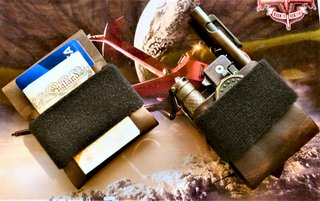

The photo below is my finished result.

When assembling your pocket organizer place the EDC item in each slot as you thread and tighten the One-wrap thru the leather slots.
Below examples of how the wallet and pocket organizer could be wrapped using the 1.5” One-wrap.

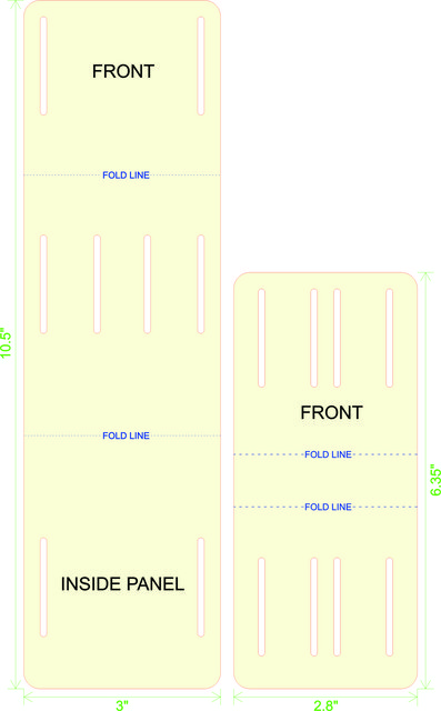

The wallet and organizer pattern is shown below.

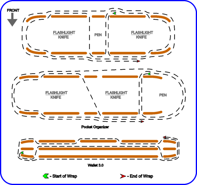

I will try to give some clarification:
The design layout are two different items, the short leather piece is a pocket organizer folded taco style with the one-wrap threaded thru the slots to make the compartments.
The longer leather piece is folded into it's self to create a top and side pockets. The side pocket can be access from the left side or right side depending which way the one-wrap is threaded thru. I attached another example of how one can thread the wrap. To access the side pocket you would pull back the one-wrap to expose the side compartment, keep those item(s) in that pocket secure until needed.
The green is where you start your wrap ending at the red indicator, but this is suggestions as there are many ways it can be threaded to create the usefulness one would want.
The reason my friend needed a side pocket is for his pocket medi-kit that he carries.
Another option for the wallet is to cut at the bottom fold line and just have a top card pocket, to create a very slim wallet.
