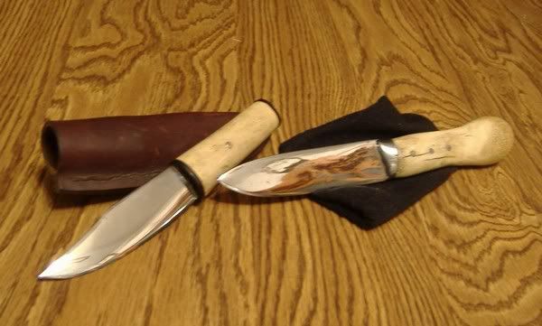

And here I was worried about the most controversial discussion being serrated blades vs non serrated! And for the record I really don't like serrated blades much except for specialized tasks such as this. IMHO they are always closer to a saw than of a knife so if you need to saw something it's one thing but not a clean cut like a knife.
Here are a couple ones I forged. The one on the left is 420 stainless and the one on the right was made from a coil spring from a truck.
Lastly, anyone who has ever been involved with owning a website is always trying to collect pennies to keep it going and I can't fault them for holding the line. I don't know the full story nor do I care to but hey, I've already made a donation to here last month to help out as well.
Hoping everyone is having a nice day!
    • Posts: 3,304
I'm with you on the serrated blades.  I've used them to cut rope and such but beyond something like that, I prefer non-serrated if I only have one blade.
I'm always impressed when someone can forge a knife from some other tool or piece of metal that was deemed for the scrapyard.  I saw a video short of someone that forged a good looking knife from a broken crescent wrench.  He left the handle as is to show what it came from.
You have an more pictures of your forging?
Like AzteCypher, I'd like to see more forged blades. It's something I consider getting into, but the lack of funds to pay the startup costs is holding me back. The two you showed look damn good! :tu:
Offline WoodButcher
    • Posts: 9
Unfortunately most of the forging was done back in the 35mm days so if I find some negatives at some point I can get some prints to post up but don't hold your breath. I've recently unearthed a trade knife blade that still needs a handle that I might get around to this summer. I have a daughter in art school who is getting into glass work and has been suggesting to me about coming home for a few days and we can make up a set of glass working tools, if so I'll be sure to make a complete knife start to finish and document the entire process for you guys. Meanwhile I want to sharpen these serrations LOL!
