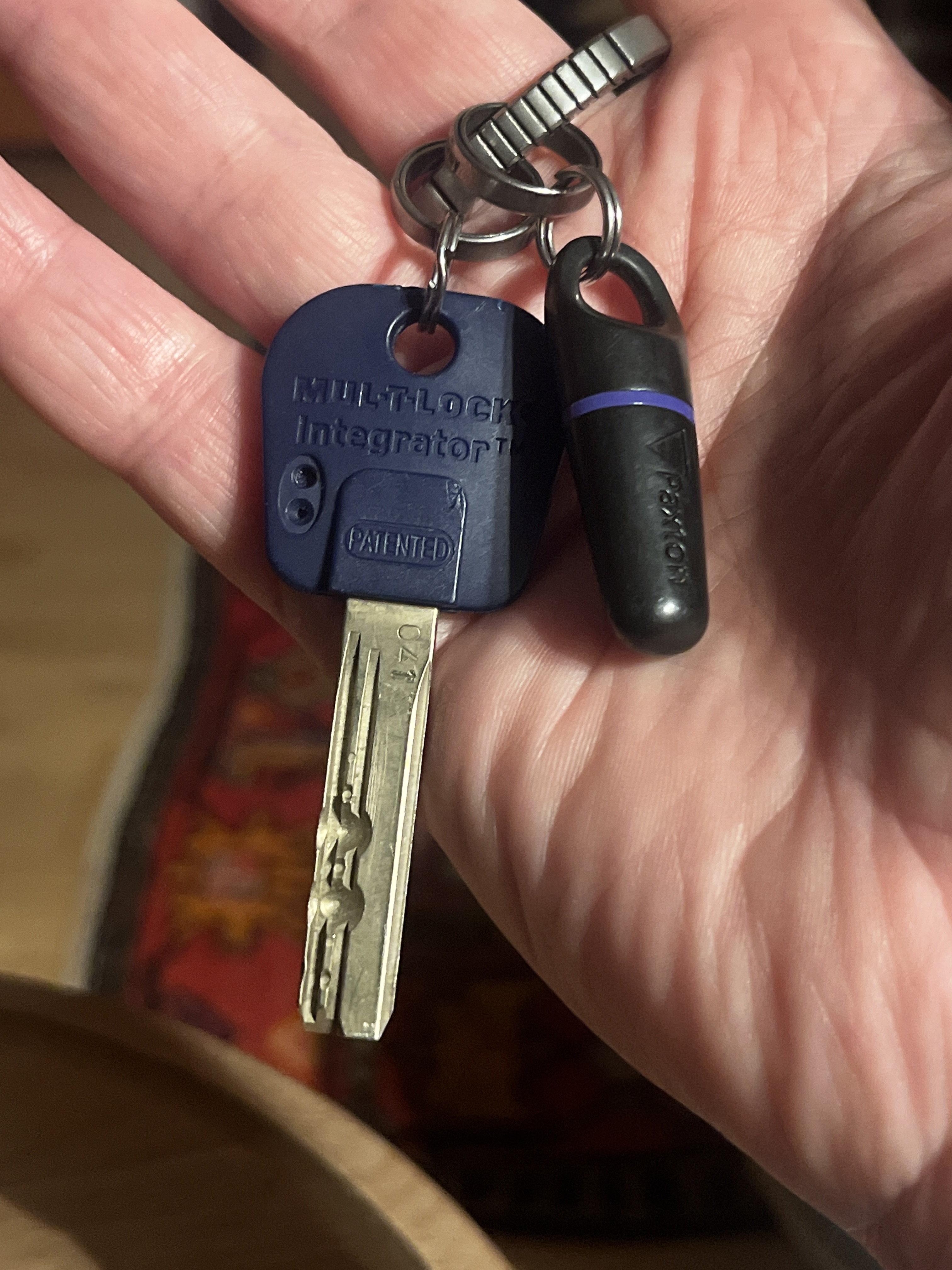

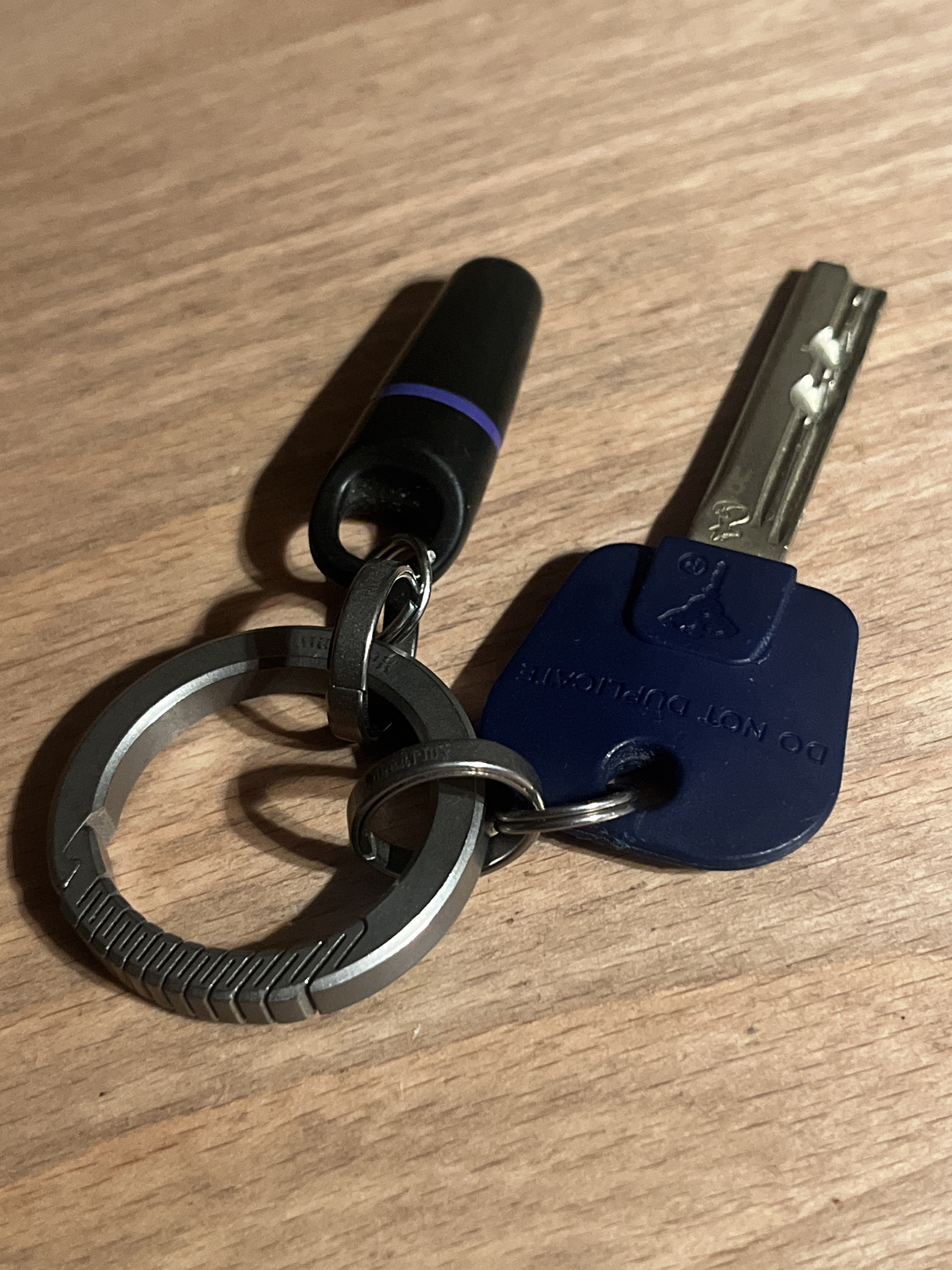

I missed this earlier.  I use it for my work keyring, which has a key for the building a fob for internal doors:
The size of the 'carabiner' means I can slip it onto a finger, or even a thumb if I want:
Comes in handy, because if I let the key and fob hang at the back of my hand, I can use the fob to open doors when I have both hands full of a laptop and a coffee. Nothing ever came off the ring when it wasn't supposed to.
I kind of hate having a big keychain these days, so keep it minimal: carry a single house key generally and keep this in my work bag. My days of having six keys, a Minichamp, a Photon light and a mini Sharpie bunched up on a keychain in my pocket are definitely over.
