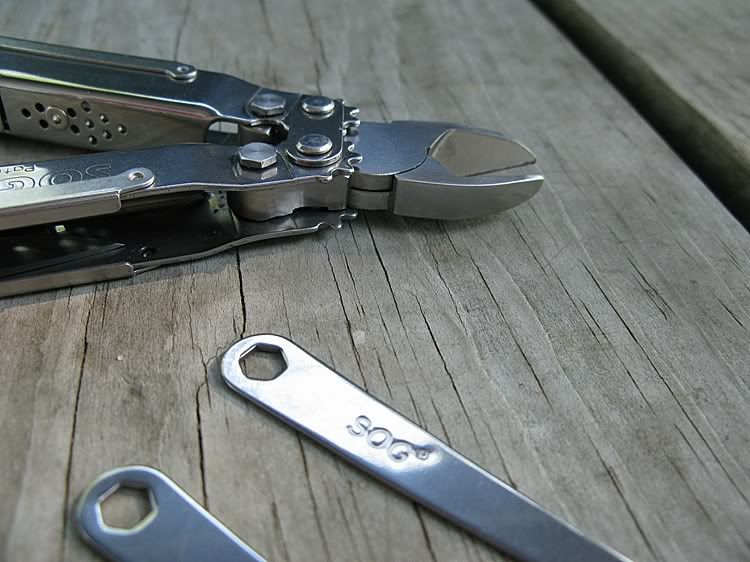

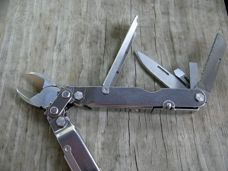

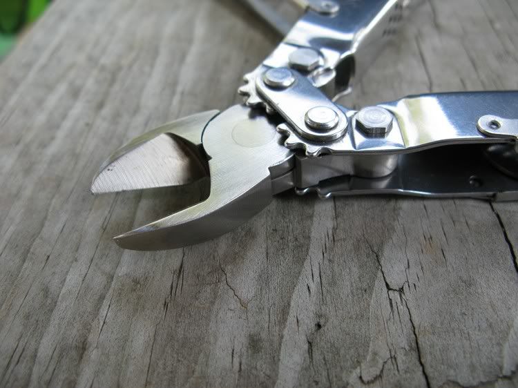

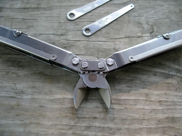

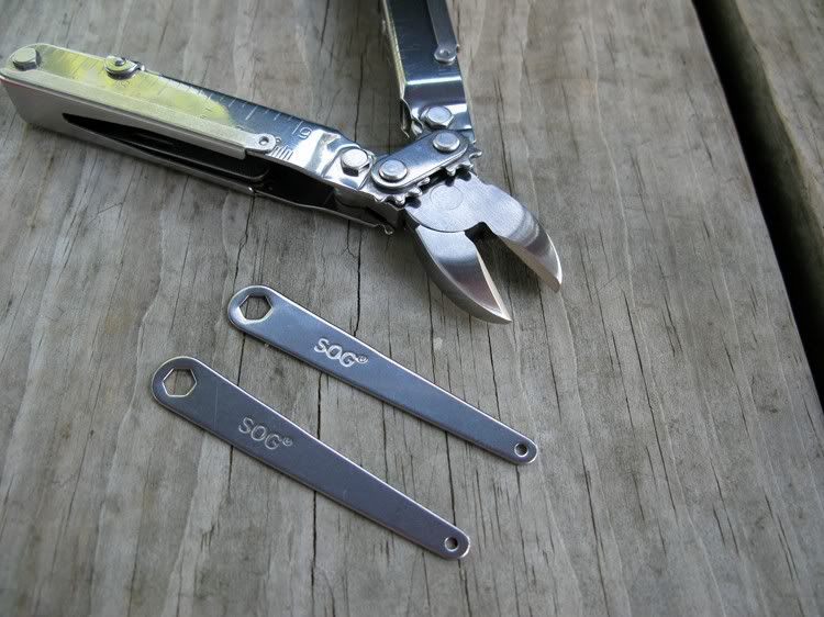

Re: If you want something done right....
Reply #33 on: March 16, 2009, 06:15:02 PM
pics
spam Offline scrappy
  • Turd Bucket
    • Posts: 2,633
Reply #34 on: March 16, 2009, 06:16:02 PM
pics
Reply #35 on: March 17, 2009, 02:42:54 AM
Hoo-boy, those really are fat aren't they? :-\
I'd want the tool to fold up, so that means the entire thickness of the Saber Tooth cutter head would need to be ground down. :(  I wonder if the pivot would fall apart then?
  • Turd Bucket
    • Posts: 2,633
Reply #36 on: March 17, 2009, 03:59:57 AM
actually it would fit if you remove the longer impliments. sorry about the spelling. you will need to grind below the pivot or remove the gears. the handle is fine but the gears will get in the way

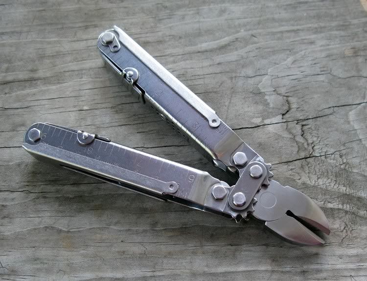

Reply #57 on: September 05, 2009, 07:33:07 PM
Whew! It took 5 months to get done, but was really only a few hours of actual work. Sorry I didn't take more photos in-process. :-\ The final product came out pretty well I think: :)
Reply #58 on: September 05, 2009, 07:57:54 PM
Wow, that looks great!  :tu:
