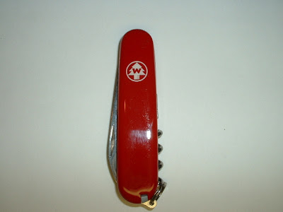

                              My Wenger 61 w/clip before Christmas:
                              After opening 3 bottles of red wine:
                              My Vic waiter after opening a dozen bottles of red wine:
                              The Vic corkscrew has not changed a bit.
                              I somehow regret buying the Wenger.
