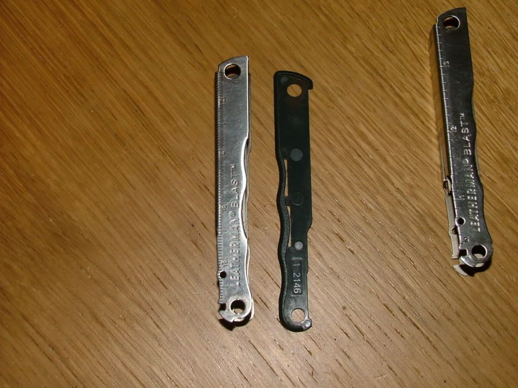

I'm pretty new to the forum, and modding, though I've been taking apart my leatherman's for years.  I really like my wave, but don't like that it doesn't have locking tools, it's heavy, and I can't put a clip on.  I also really like the fuse that I recently lost (anybody find one? it had a kick clip on it), but I like OHO on an external blade and I could use a file.  I've been dreaming of LM making a wave like tool, but with only two external tools instead of 4.  I don't really need two blades, and definitely don't need a 3" saw.<br />
So my plan is:  buy a newer used wave and fuse on ebay, chop off 1/4 of it (not sure what side yet, but plan on losing the serrated blade and saw), cut off and grind down the unused side, then swap in phillips and small screwdriver out of the fuse, and put the bit holders into the fuse.  I might end up putting one of the SOG files into the fuse and keeping it one of my toolboxes.  A quick search revealed that it doesn't look like anybody here has tried a mod like that on a wave.  Obviously, I'm not too worried about warranty, so I might drill it out to lighten it some more.  I'll post some pics of my dream tool, or an epic failure in 2-3 weeks.</p>
<p dir="auto">The current mod is my S2, I can't really get into how the two sides are a different width.  Sure, I like a bottle opener, but a little skill and most any other tool on the S2 will open a bottle.  I don't really open cans often, and I can strip wires with a knife or scissors.  So, I drilled out the rivets, went to ace, found out that the holes are a tad smaller than 9/64th that the closest bolts are, so I drilled out everything to accept #6 (I think) bolts.  After I do all of that, I search the forum here and see the knife supply that would have something much better.  I'm going to get some (only did one side for now) and see if the drilled out side is too big, of if the tolerance will be acceptable.  I'll have to do the other side to get rid of the aluminum cover, in due time.</p>
<p dir="auto">My background: (Maybe not the correct location, but here it is) I'm a mechanical engineer by education, currently serving in the US Air Force... in a cube farm!  But, at least I'm doing real engineering work, though it's not really hands on.  I keep searching for design engineer jobs at LM, but I have a while left before I want to get out.</p>

<p dir="auto">I did remove the little peg, it's amazingly weak.  One little twist with a pair of pliers and it popped right out.  I'm thinking it's a part for the manufacturing process?  Maybe so they can accurately place the spring before riveting it down.  There was an indent on the side also which doesn't appear to affect the phillips, as I switched it from what the picture shows already.  I found that the can opener was tapered the wrong way, and the nail nick wasn't accessible, so I swapped it.  The way it's pictured the can opener doesn't interfere with the indent, but I thought the phillips would, apparently it doesn't, as it closes just fine.</p>

<p dir="auto"><img src="http://lh5.ggpht.com/_-m4cmQfIsCU/S_cdi24aVPI/AAAAAAAAAN8/pO0nd3Fdffo/s800/100_1970.JPG" alt="" class="img-markdown  img-fluid" /></p>
]]></description><link>https://forum.multitool.org/post/377516</link><guid isPermaLink="true">https://forum.multitool.org/post/377516</guid><dc:creator><![CDATA[wvucyclist]]></dc:creator><pubDate>Sat, 22 May 2010 00:05:15 GMT</pubDate></item><item><title><![CDATA[Reply to 3/4 Wave anybody? on Fri, 21 May 2010 01:51:49 GMT]]></title><description><![CDATA[<p dir="auto">Ok, I've been waiting for the 5 point torx to get here, and it finally arrived today!  So, I got to work and took it apart.  The wave I bought needed rebuilt anyways, it was in rough shape, but for $33 what can I expect.  I did the slice and dice, initial impression is that the edge is sharp, so more work with a file is required.  I left my kick at work for whatever reason, and I'm planning on robbing it of some tools, so I'm not completely done, but in the mean time, some pics.</p>
