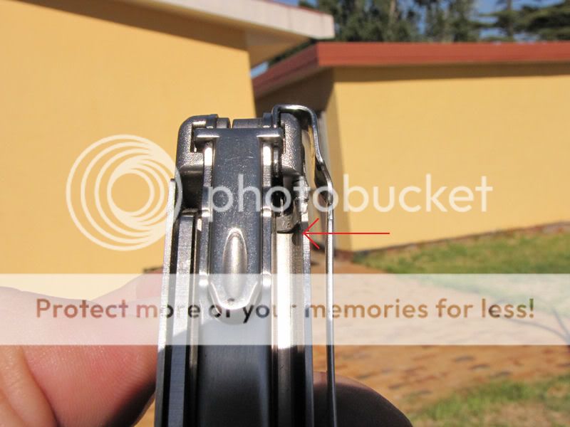

<?xml version="1.0" encoding="UTF-8"?><rss xmlns:dc="http://purl.org/dc/elements/1.1/" xmlns:content="http://purl.org/rss/1.0/modules/content/" xmlns:atom="http://www.w3.org/2005/Atom" version="2.0"><channel><title><![CDATA[Surge pocket clip sideways play solved]]></title><description><![CDATA[<p dir="auto">I have been plagued with the sideclip of the Surge moving sideways because of the fact that there is a gap between the pocket clip edge and the little block on the inside of the Surge's bolster.<br />
See my review, that give an explanation at:<br />
<a href="/topic/25332">/topic/25332</a></p>
<p dir="auto">I have added a very small stainless steel part. See the arrow:<br />
<img src="http://i798.photobucket.com/albums/yy261/Boerseun1/Problem1.jpg" alt="" class="img-markdown  img-fluid" /><br />
The part does not touch the scissors and it is almost invisible. The part was glued with epoxy glue and can be removed without damage and if you ever have to send your multitool in for repairs, Leatherman can not complain.</p>

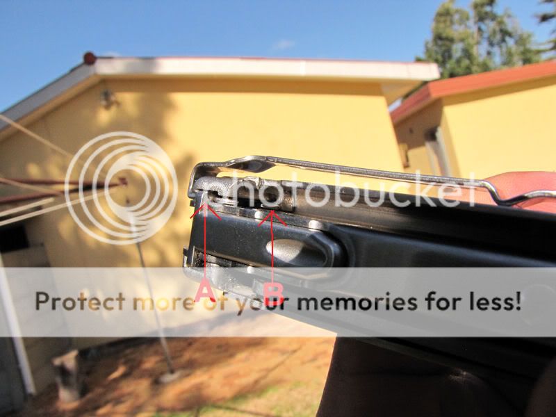

<p dir="auto">In the second image you can see the part in more detail:<br />
<img src="http://i798.photobucket.com/albums/yy261/Boerseun1/Problem2.jpg" alt="" class="img-markdown  img-fluid" /><br />
There is also a further 3mm piece extending underneath the clip's edge.</p>

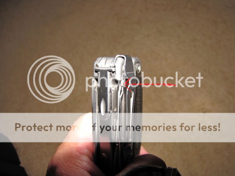

<p dir="auto">Here you can see the part from another angle:<br />
<img src="http://i798.photobucket.com/albums/yy261/Boerseun1/Problem3.jpg" alt="" class="img-markdown  img-fluid" /><br />
The problem occurred where the pocket clip, after inserted swiveled at point A because of the gap at B. Now with the piece of metal there the pocket clip has no sideways movement at all and the clip is even more rigid than on the Wave.</p>
<p dir="auto">Now the lanyard clip also can be used without any play.<br />
Even the sawblade mods can now be applied.</p>
<p dir="auto">There is a more permanent hack option, and tht is to build up metal with a TIG welder on the inside of the bolster and shape it with a Dremmel.</p>

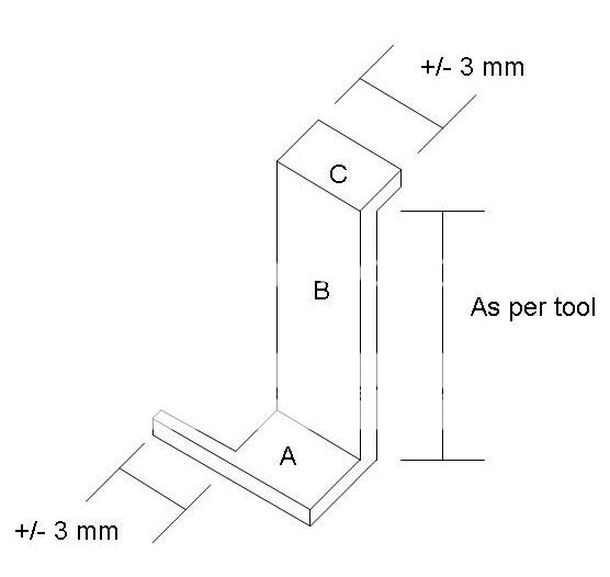

]]></description><link>https://forum.multitool.org/post/496081</link><guid isPermaLink="true">https://forum.multitool.org/post/496081</guid><dc:creator><![CDATA[SuzukiGS750EZ]]></dc:creator><pubDate>Sat, 18 Jun 2011 05:05:53 GMT</pubDate></item><item><title><![CDATA[Reply to Surge pocket clip sideways play solved on Sat, 22 Jan 2011 12:49:11 GMT]]></title><description><![CDATA[<p dir="auto">Her is a simple sketch of the piece with approximate sizes:<br />
<img src="http://i798.photobucket.com/albums/yy261/Boerseun1/Problem4.jpg" alt="" class="img-markdown  img-fluid" /></p>
<p dir="auto">I made use of stainless steel straps, the type they use to tie bins to lamp poles. It is approximately 0.8 mm thick.</p>
<p dir="auto">The initial dimensions is 6mm wide and then you remove the piece left of part B.<br />
Bend A so that it will fit inside the tool and whil holding it with a shrp nose pliers bend part C and file til flush with the edge.<br />
Glue then with epoxy glue. the sides of B on the right hand side can be filed round to prevent the scissors to touch it.<br />
Also the part C can be rounded to save your fingers.</p>
<p dir="auto">The thin part must be the same size than the slit it the bolster and the up and down thickness as required.</p>
<p dir="auto">Unfortunately I did not photograph the item before installation.</p>
