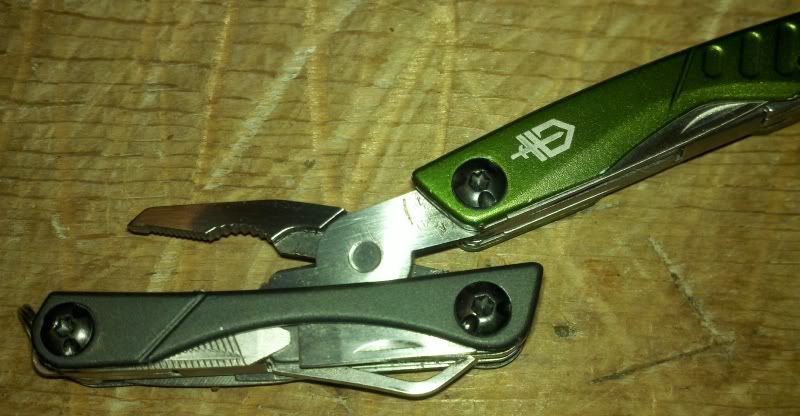

      I've been carrying and loving the Gerber Dime since I received it last Saturday. I thought I'd finally found something that would knock the PS4 off my keychain. Well tonight I decided to test the wire cutters and remove an obsolete sign held to a fence in the garbage area of my building. The wire was just a bit thicker than bailing wire and while I didn't think it would be an easy task for the Dime, I didn't expect to ruin the tool. I was using about moderate hand pressure when I thought it had snipped the wire but instead had bent one of the back springs.
      When I closed the pliers one of the jaws became locked closed by the bent spring.
      I have done a heck of a lot worse things to my PS4 with the only discernible damage being some minor denting of the cutters.
      I wonder if this one has a manufacturing defect or if the design is not as strong as the PS4 :think:
      1 Reply Last reply

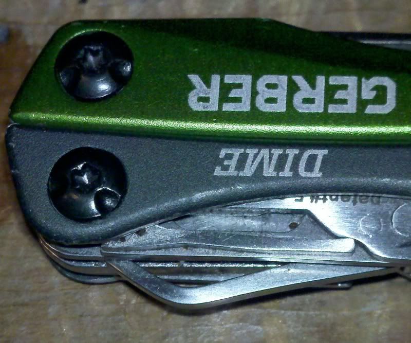

              The size of that backspring looks delicate compared to the size of the plier head it's supposed to be supporting :think: Well maybe not the spring itself as the forces would be in-line, but the amount of support it has (or doesn't) to prevent it bowing out like that :-\

                      Um. that looks like the steel wasnt heat treated for proper spring temper. Its quite a process to turn regular steel into good spring steel, and I bet they skipped steps. Spring steel cant do that at all, it would snap not bend. Garbage if you ask me.
                      I'm not a gerber fan at all, and its hard to not bash them openly, trying to be nice here, but really that doensn't surprise me. All the gerber cheap stuff Ive ever handled or seen is just garbage. I couldnt find sometone to give my cheap gerbers to, and they just ended up in trash. This looks about the same.

                                      So I don't quite understand....what made the backspring bend? Does all the pressure of the plier fall on that one little piece of metal? ???
                                      1 Reply Last reply
                                      • theonew Offline
                                        theonew
                                        Posts: 1,294
                                        theonew Offline
                                        theonew
                                        wrote on last edited by
                                        #9 Quote Reply

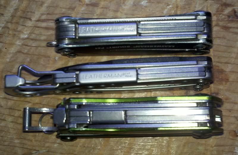

                                          Well I don't believe that the little spring is taking all of the force but it is definitely being stressed.
                                          This setup appears to be very similar to what LM uses for their mini-pliers. But there is a noticeable difference in geometry as the photo below shows. Top - LM Squirt PS4, middle - LM Style PS, bottom - Gerber Dime.
                                          The little springs on the LMs are noticeably shorter than on the Dime, which I would imagine creates less opportunity to bend :think: The tips of the little springs on the LMs are also beveled a bit which may be to counteract certain stresses :think:
                                          1 Reply Last reply

                                              Okay, I see what you mean now. :salute: I don't have a Dime yet, but looking at a Squirt or a Juice I can see how it works. And to be honest, I believe the backspring IS taking on the entire force of the plier. :o That is a great deal of pressure for such a small bit of metal.
                                              All the more reason they should make doubly certain to get the heat treatment on them done right.

                                                          I got my Gerber Dime yesterday and I have been really impressed with it. In many ways, I think it's better than the Squirt. The bottle opener and pliers jaws are much better. I've only cut some copper wire, but haven't seen a problem.
                                                          And I love the knife blade shape. I think it's great that it's not a chisel grind (like the squirt).
                                                          Looking at the springs, it looks like the pliers only act on ONE spring. The other "leaf" is part of the pliers "recoil" mechanism. Put another way, the base of the pliers only rest on the one spring.
                                                          I really like this little tool...I hope this is a "one off" problem. :(

                                                                          I'm starting to think that leatherman bevels the ends of the springs to help stabilize the longitudinal forces.
                                                                          1 Reply Last reply

                                                                                  I suspect that if all the forces are acting on that one small spring, we're talking a design issue not a materials one. The concept of the tool is excellent, and I hope Gerber's designers are working on this as we speak otherwise they are going to be facing an ocean of problems down the line.
                                                                                  For me they either need to increase the supported length of the spring, tie the two springs together somehow to double the strength, or drastically increase the cross sectional area. This could potentially be the best keychain pliers out there if they can resolve this.
