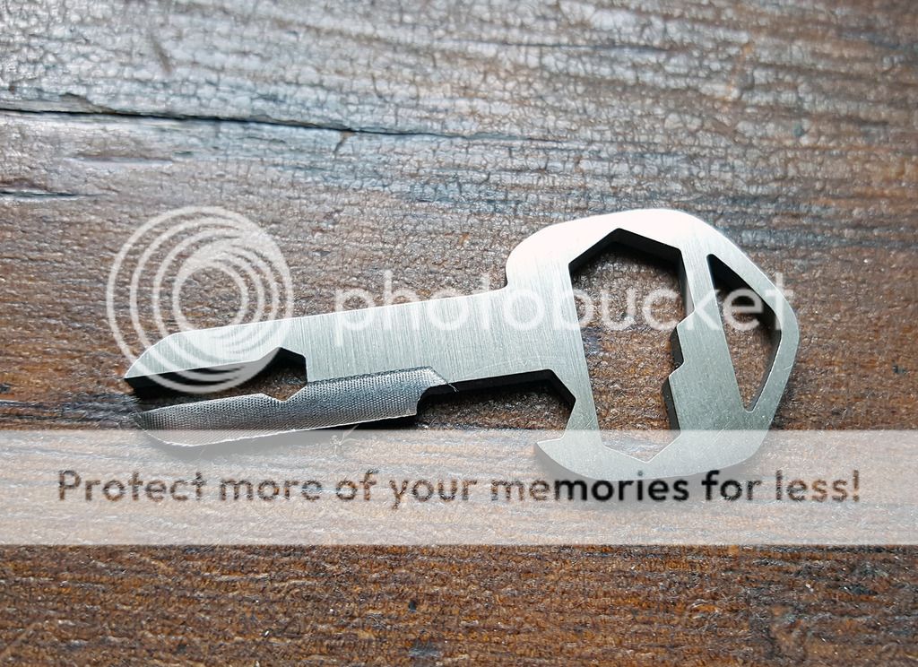

Here is the KEBOOP : KEyring BOx OPener<br />
It's main purpose is to open boxes (break tape mostly) so it has a corner that is sharp enough for the job, but dull enough not to accidentally cut the user.<br />
Secondary functions are : cap lifter, belt cutter and wire bender<br />
*Vic Sentry (84mm) for scale :)<br />
*<img src="http://i1271.photobucket.com/albums/jj631/m47mu74nt/4774-01/v1ct021n0X/KEBOOP-Functions_zpsmlaybna8.jpg" alt="" class="img-markdown  img-fluid" /></p>
<p dir="auto">Ti has been anodized at 57V, but this time i could achieve a light blue that even has some yellow accents (in the very right side)  <img src="/assets/uploads/smileys/angel.gif" alt=":angel:" title="angel" class="forum-smiley emoji" /><br />
<img src="http://i1271.photobucket.com/albums/jj631/m47mu74nt/4774-01/v1ct021n0X/KEBOOP_zpsyayb88m5.jpg" alt="" class="img-markdown  img-fluid" /></p>
<p dir="auto">Hope you like it :)<br />
Feel free to build one based on this and improve my simple design</p>
<p dir="auto"><em>Here my main limitations were the material: the Belt cutter can't be used many times as the Ti grade 2 can't be hardened enough to hold sharpness for long, and the 2mm thickness prevent the tool to be used as pry bar. But, it is extremely lightweight!!<br />
The main hole took me ages to drill (needed to use 2, 4, 6, 8, 10mm drill bits one after the other!!)</em></p>

Raw material:<br />
<img src="http://i1271.photobucket.com/albums/jj631/m47mu74nt/4774-01/v1ct021n0X/material_zps1ux18hrt.jpg" alt="" class="img-markdown  img-fluid" /></p>
<p dir="auto">It took me ages to drill that hole, to prevent the piece from spinning and ruin my hand i fixed it with an home made ghetto clamp:<br />
<img src="http://i1271.photobucket.com/albums/jj631/m47mu74nt/4774-01/v1ct021n0X/Piece-holder_zpshzwwkkub.jpg" alt="" class="img-markdown  img-fluid" /></p>
<p dir="auto">Testing the belt cutter (before anodizing):<br />
<img src="http://i1271.photobucket.com/albums/jj631/m47mu74nt/4774-01/v1ct021n0X/test_zpsfmxpz803.jpg" alt="" class="img-markdown  img-fluid" /></p>
<p dir="auto">Usage feedback:</p>
<ul>
<li>Box opener works extremely well to break tape seals</li>
<li>Belt cutter works better than expected to cut the PET packing belts (no wearing signs after a few days of intense usage)</li>
<li>I didn't even tried the cap lifter btw...</li>
</ul>
]]></description><link>https://forum.multitool.org/post/1220996</link><guid isPermaLink="true">https://forum.multitool.org/post/1220996</guid><dc:creator><![CDATA[m47mu74nt]]></dc:creator><pubDate>Tue, 02 Feb 2016 17:55:11 GMT</pubDate></item><item><title><![CDATA[Reply to The KEBOOP : KEyring BOx OPener on Sun, 31 Jan 2016 11:16:55 GMT]]></title><description><![CDATA[<p dir="auto">Thanks guys  :D</p>
