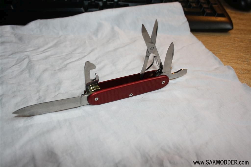

Reply #454 on: September 24, 2012, 12:40:27 AM
My problem right now is the broken spring inside the scissors.
I have replacement springs, but the little curl on the one end is too big for the hole on the scissors. :ahhh
Victorinox must have changed the size of the holes on their current 84s compared to the old ones like the small Climber...
Guess I'd have to drill the hole bigger because I see no way of slimming down the curl on the little fragile springs without breaking them.

Reply #455 on: September 24, 2012, 10:44:02 AM
I´ve got 2 spare springs which i suppose to come from older 91 vics with screwed together springs (as they came with a spare screw). shipping is cheap, so i can ship one of the m to you and you can test them. Or you measure teh curl on your springs and i check mine.
BTW: I did not find any older screwed together Scissors on any of my donor knifes.

Looking great Syph, love the snap you are clearly getting. :cheers:  Can the same spring be adapted for use on the 84mm frame?
Sadly no.  The 84 has more in common with the 91 as they share the center hole position (different size but some location).  That's how I was able to use 91 springs on 84s to get scissors on.  The 93s are completely their own beast as far as hole spacing for springs go.  This spring I made up should work for a number of components though. I can even completely grind down the one end and use it for 2 tools.
If I run out of the old scissor backsprings from 91s that I got from Tom, I may have to make some springs up for the 84 scissor mods.  I got a pile of them from him at the time, and I think i have 20 left, but he said he was running low on that old style last time I asked.
Ah well. :-\  I rather thought that it was a long shot. :shrug:

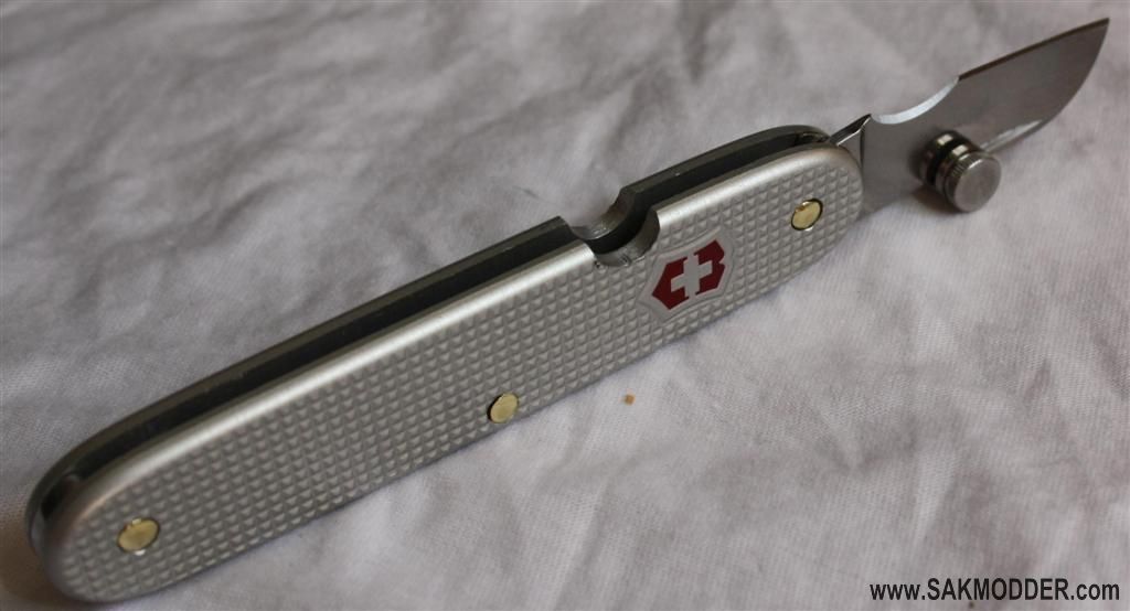

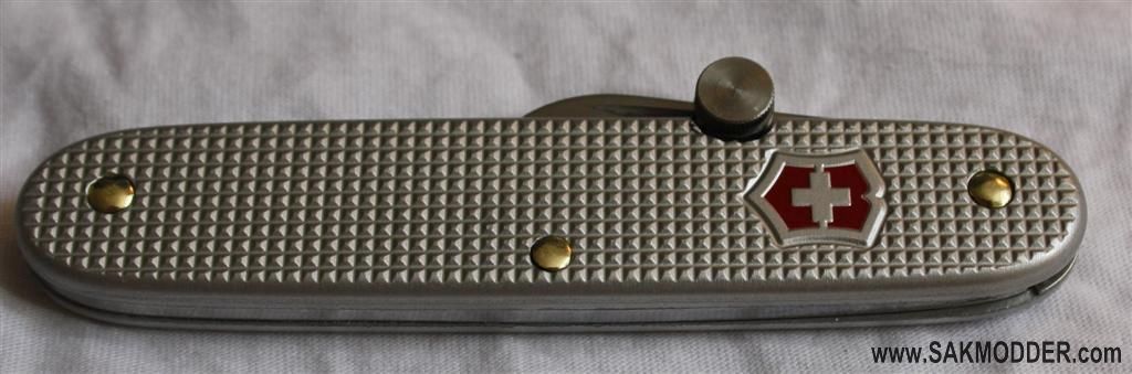

Reply #457 on: September 27, 2012, 10:15:56 PM

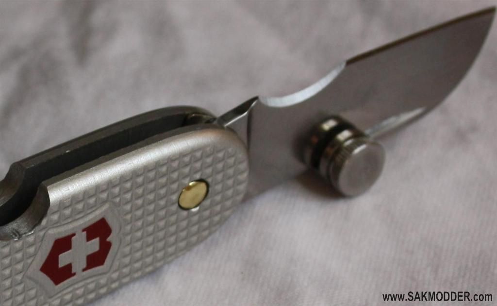

Here's a very different one from my typical jobs.  It was a request by a user with the use of only one hand.  He wanted a one hand opener but just the electrician blade and nothing else.
This uses my custom spring for a type of solo electrician.  The blade was straightened out as normally they are bent to fit with the cap lifter.  I also rounded out the hump on the pivot on one side to require less force to start the opening process since the blade is shorter and there is less leverage.  I also peened this one.  Crazy I know...  :D   The customer wanted it so I obliged.
My cat and I took some video to show the action. (He was just taunting the neighbours dogs which is why they were barking)
Cheers

May I see the other side? :D
Crazy mod!

Reply #459 on: September 27, 2012, 10:22:20 PM
Crazy mod!
The back side doesnt count! :D  It looks the same but not polished.  I spun those rivets and buffed them before I peened the back.

Reply #460 on: September 27, 2012, 10:24:23 PM
That's great. I like the idea of OHO blades on SAKs but thought they would ruin the over all look... not so! :tu:
us Offline nj2656
    • Posts: 145
Reply #461 on: September 28, 2012, 03:15:46 AM
It doesn't look like it but is the thumb stud drilled and tapped or does it just go over the top? Reason I'm asking is as I mentioned to you I would like that mod but in a multilayer.
ca Offline Syph007
    • Posts: 9,842
  • SAK Surgeon
Reply #462 on: September 28, 2012, 05:01:11 AM
This type is just attached over the blade and you tighten with a set screw.

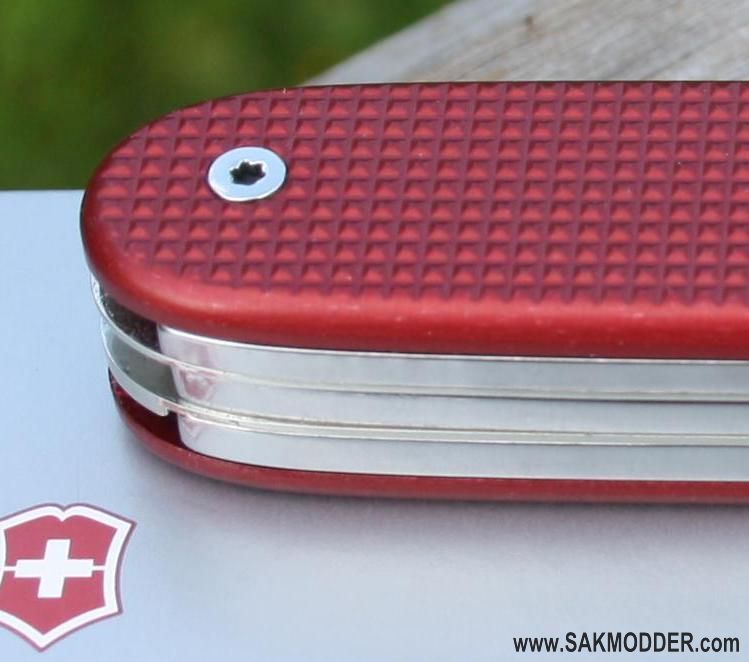

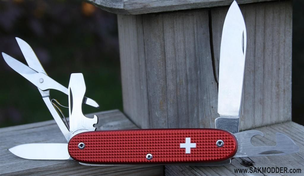

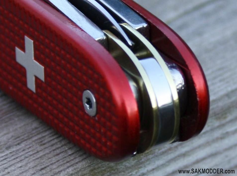

Reply #463 on: October 01, 2012, 02:54:58 PM

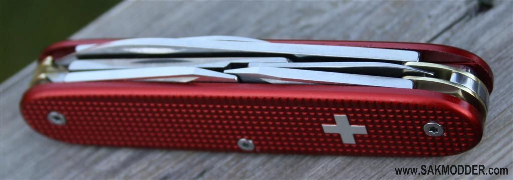

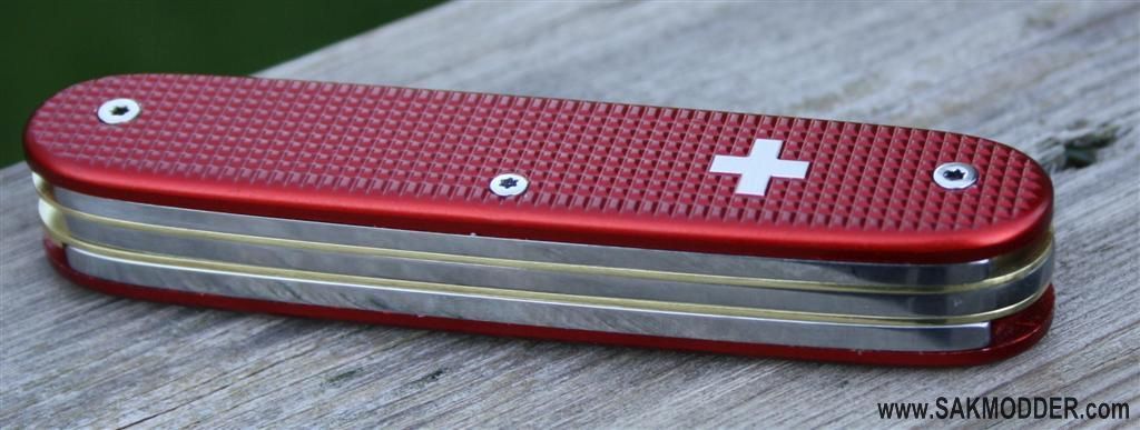

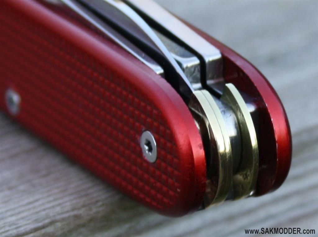

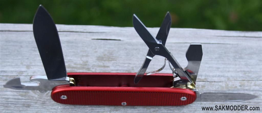

I just finished delicate surgery to upgrade a red old cross pioneer.  This is my first colored stock anodize mod.  They are much trickier to work with than say silver stock anodize, or my hard anodized scales.  I cant countersink the center hole from the outside as I don't have the benefit of being able to re-anodize.  If I tried to countersink in these scales there would always be some rough edges showing around the screw and to me that's not acceptable.
So to do these type of mods I drill 1/8 from inside the scale in the center hole, careful to not go all the way through, then use smaller head screws from the outside.  It works out perfect, it's just much more fiddly.  Im reminded when I work with stock ones though how much I prefer my redone scales.  I take the time to edge sand the inner edges of the scales that Vic does not and leaves sharp.  That sharp edges is prone to chipping much more than mine does after gentle rounding.
You have to love the look of the old cross though, it's by far my favorite of the alox scales!

us Offline Marius
    • Posts: 1,544
Reply #464 on: October 01, 2012, 03:17:01 PM
Delicious! :salute:
 :drool:
gb Offline Dexter
    • Posts: 320
Reply #465 on: October 01, 2012, 04:27:41 PM
Have to agree with you on the old cross style. Love it.  :tu:
de Offline crackout
    • Posts: 864
Reply #466 on: October 01, 2012, 04:30:10 PM
Nicely done!

us Offline nj2656
    • Posts: 145
Reply #467 on: October 01, 2012, 09:20:27 PM
Looks great but not your first. My pocket clip Urban was factory black anodized. Every once and awhile I can feel a slight burr but can not see it. No big deal it'll wear off. Anodizing is starting to wear. Can't wait for the blue jean finish.

Reply #468 on: October 01, 2012, 10:54:23 PM
Oh you're right I'd forgotten that black alox.  The stock Vic anodize does wear pretty quick compared to the HA stuff.  I have one set of red scales with a ding on the finish Im thinking of sanding the top of them to get them a worn look just for fun.  Noone has carried one of mine long enough yet to get any natural wear.

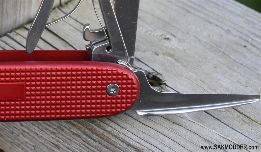

Just opened up the package containing my Syph007 mod.
It's so awesome!
I've dubbed it the Alox Climber. (Urban pioneer with small blade instead of the Awl.)
Syph007, thanks for all the hard work that went into making it a reality.

Congrats! I noticed the small blade being mentioned. Spear point, Settler style? Or another small blade? It looks we got at about the same time a similar custom from Robert  :) because I just got also an Urban Pioneer (Pioneer with scissors) with a small spear point blade instead of the awl. Could you or Robert post some pics or links to pics?
Robert, one more BIG thanks to you! :cheers:

Cool! So is that small blade from a Settler (93mm)? Seems a bit thicker than one from 91 mm like I got. Or is just the thicker spacer? Here:
« Last Edit: May 10, 2015, 04:31:00 PM by Syph007 »
ca Offline Syph007
    • Posts: 9,842
  • SAK Surgeon
Reply #475 on: October 03, 2012, 06:00:19 PM
Nope regular pen knife blade from 91mm SAK.  They are 0.015 inches thinner than the awl being replaced and I add a washer of phosphor bronze of that thickness between blade and spacer to compensate.  Same as I did to your mod.

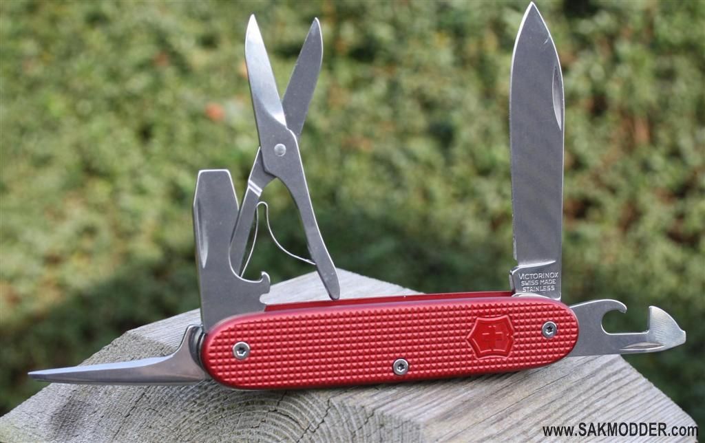

I finished up just a regular urban pioneer this morning... but I still love the look of the red every time I use it.  Nothing like a shiny Vic wearing hard anodized red in the light of the rising sun... :D
