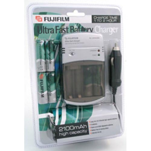

Hi,
I have received my Eneloop AAA batteries today  :mail: Now I had read that fast chargers are not ideal for these batteries, ok now and again but not ideal. Five seconds after I ordered I thought I'd check my trusty charger. It certainly did seem fast  :think:
Then I read the name of the charger 'Fujifilm Ultra Fast Battery Charger'  :oops:
Do I need a new charger then?
No big problem if I do; I could always get one the deals with an Eneloop charger with batteries  :tu:

Fast chargers are OK as long as there's a decent amount of breathing room around the cells so they won't overheat, and the charging current is 2A or less.  The recommended charge rate for Eneloops is .5C - 1C.  "C" is 2000mAh for Eneloops, so 1A - 2A is ideal.
Many folks want to charge at lower rates such as 200mA or 500mA, but the danger there is whether the charger can reliably terminate charge at those rates.  Higher rates terminate more reliably, so it's typically safer for the cells to charge at the higher rates (1-2A) than lower rates so that overcharging is avoided.
I would guess that the pictured charger has a 2A charge rate since the batteries are 2100mAh and it's a one-hour charger.  However, I wouldn't buy it unless I knew the exact rate.  The cells look very close together in the charger too, so I would be worried about overheating them.

On the rear of the charger is the following:
  • Input: DC12V 700mA
  • Output: DC6V 1000mA Max
Charging Current:
  • AA: 1000mA
  • AAA: 400mA
Does this help in whether it is a no no or not? :D

Yes, that certainly helps.  I like those charge rates, and they should work well for Eneloops.  However, you should monitor the charger while it's operating to be sure the cells don't get too hot toward the end of the charge.  Warm is OK.
Does the charger have 4 independent circuits, or two?  Another way to ask that same question is; can you just charge one cell at a time in this charger, or do you have to charge two at a time?  If it has 4 independent circuits, I would suggest you charge only two cells at a time, but put the cells in slots #1 and #3 to give them more room to breathe.  You will not be able to do that if it has only 2 independent circuits.
I don't really recommend using a charger with only two circuits, that can only charge two cells at a time (rather than 1 cell at a time).  That is, unless you ALWAYS use your cells in pairs.  This is because you should NEVER charge two cells of different charge on the same circuit.  If you do, the one with the higher voltage will be overcharged (and probably overheat) in the charger.

Ah.. waitaminute.  I see the charger has two slots for AAA and two for AA, right?  So, the only question to ask is; do you HAVE to charge two AA or two AAA cells at a time in this charger?
I also see that you're charging AAA Eneloops (I really should read better the first time).  400mA should also be OK for the 850mAh Eneloop AAA cells.  400mA falls into the .5C - 1C spec.

This charger can charge either AA or AAA in pairs only.
So my charger should be ok for the AAA's provided I monitor the charge towards the end?
What about as and when I get some AA's?

You should be fine with AAA or AAs in this charger.  Yes, just watch for heat toward the end of the charge, and be sure that both cells you're charging are at equal voltage/charge levels before recharging them.
