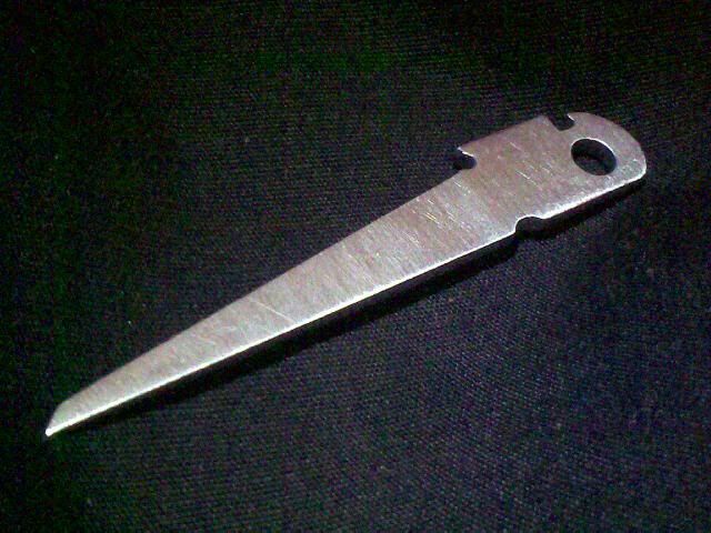

With the aid of all of your input and photos, I mixed and matched ideas and came up with an awl solution that I think will work great for me. I started off with metal better than that of the standard Wave blades, so it should be able to handle the abuse it will see. I went with a long, slender awl... just a hair over 2.5 inches. I noticed that the majority of awls sharpen the same edge so that it cuts when turned clockwise. In order to have clearance for the plier head, I had to sharpen the opposite edge (some SOG's are sharpened like this?). This turned out to be a blessing in disguise as I am naturally left handed. I tapered the thickness at the tip, similar to a Spirit, but not so much so that the tip would lose strength. The tip itself... I did a mild version of the beveled tip of a SOG (only 1/8 inch). There were definitely some clearance issues to deal with. If I wanted a short stubby awl, the process would of been straight forward. Since I wanted a larger, more substantial awl, I had to make a notch on one edge to get it to sit flat inside the tool. It is so long and wide that it overlapped the flat part of the scissors handle, which I will have to reshape tomorrow so there is no interference. It is a supertight fit but managed to utilize every bit of extra space in there. The large flathead driver (which I may still replace) got moved to the other handle next to the large bit driver. I wanted all things screwdriver related on the same handle. The awl is where the large flathead driver was. I am eliminating the small bit driver altogether as I will never use it because I have a complete set of double ended precision screwdrivers I made to fit the large bit driver. So... now I have the extra spot where the small bit driver was. Debating on what I will put there. Oh, also, anyone have any Surge scissors they are willing to sell or trade? Time permitting, in a day or two I will have finished and cleaned up the install. Afterwards, I will post pics. Thanks again you all!!

Hey gang! It's AWL done. I apologize for the quality of the pics, they were taken with my phone.....
Initial cutting and shaping to fit into the Wave.....
It is subtle, but the thickness tapers towards the tip. Cutting edge added and sharpened.....
Close-up of bevel grind on the tip.....
Installed.....
Yet another view..... this thing is huge!
All in all, I am quite pleased with the outcome. After dealing with the clearance issues, it folds up and locks perfectly. I put it through the paces today by punching holes and reaming just about everything in sight. It passed the test with no problems or issues. Thank you all again for your input and your photos. They helped a lot in the decision making process for making an awl that suits my needs perfectly.....
