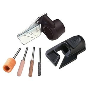

So ended up trying a Dremel Sharpening Kit, which none of the bits that came with my package was small enough. Ended up making the cutting area slightly bigger.
This sort of worked, but still not razor sharpened.

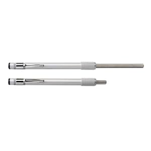

Today I went to BiMart and came up with two more items, one being yet another stinking diamond stone. And a way smaller ceramic rod to try out!
Smith's Pocket Pal Knife Sharpener - carbide & ceramic embedded draw sharpeners, with a rotatable tapered diamond rod.
Lansky Mini Knife Sharpener - The rods pop out.
Haven't tried either version yet as my cutting hook is sharp now.

My suggestions would be to use the Spyderco 701 Pro Files.  You can sharpen serrations, gut hooks, you name it with these things:

I have a few diamond rods -conical in shape . I only use these on abused tools . For my own stuff I use a leather bootlace loaded with polishing compound . The lace has a loop to go around the toe of my boot , left hand holds it tight , right strops the hook on the lace .
