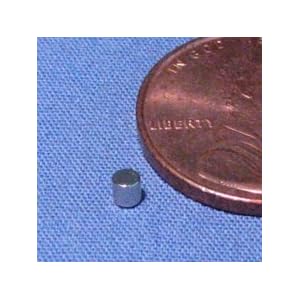

  Been using the small driver on a Squirt S4 as a chisel to cut square holes for the magnets. Then have to epoxy them in. Haven't put the pin in yet.

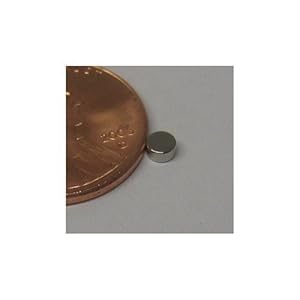

  Black spots are the teeny neodymium magnets. May have to add a secondary south-touching magnet for the pin groove since was unable to burn a straight groove through the wood, and that testing is showing the pin wants to launch upwards. If there's a slight gap between the scale and the knife, that will cause issues. Better to get it right the first time.

For the pin, having a recent issue with the pin getting caught on the corkscrew, had come up with the idea of putting a small magnet into the handle. This would also help keep the pin magnetized & held into place since my Climber has aluminum scales.
Debating between these two, unless someone else has another option. Have tried the flexible magnet inside the current plastic scale and it just does not do a thing. Not enough magnetic power there.
15 PC Neodymium Magnets N42 Dia 2X2mm Rare Earth NdFeB Magnets
50 Pieces N42 Neodymium Magnets Dia 3mm x 1.5mm Thick
Comments, suggestions, or... :pommel: ?

  The idea of the magnets was to a polarity on the needle so it would point north if ever needed. The magnets were a dickens to get in there and aligned.
  As much effort I went through to get the needle aligned North and South something changed... the North end was supposed to be the pointed end. I quadruple checked and verified the magnet placement was correct. But... when I tested it, the head of the pin became North, not the prickly end. Not sure what changed its polarity there. :think:
  The pin doesn't slide out on its own, one needs to use their fingernail.
