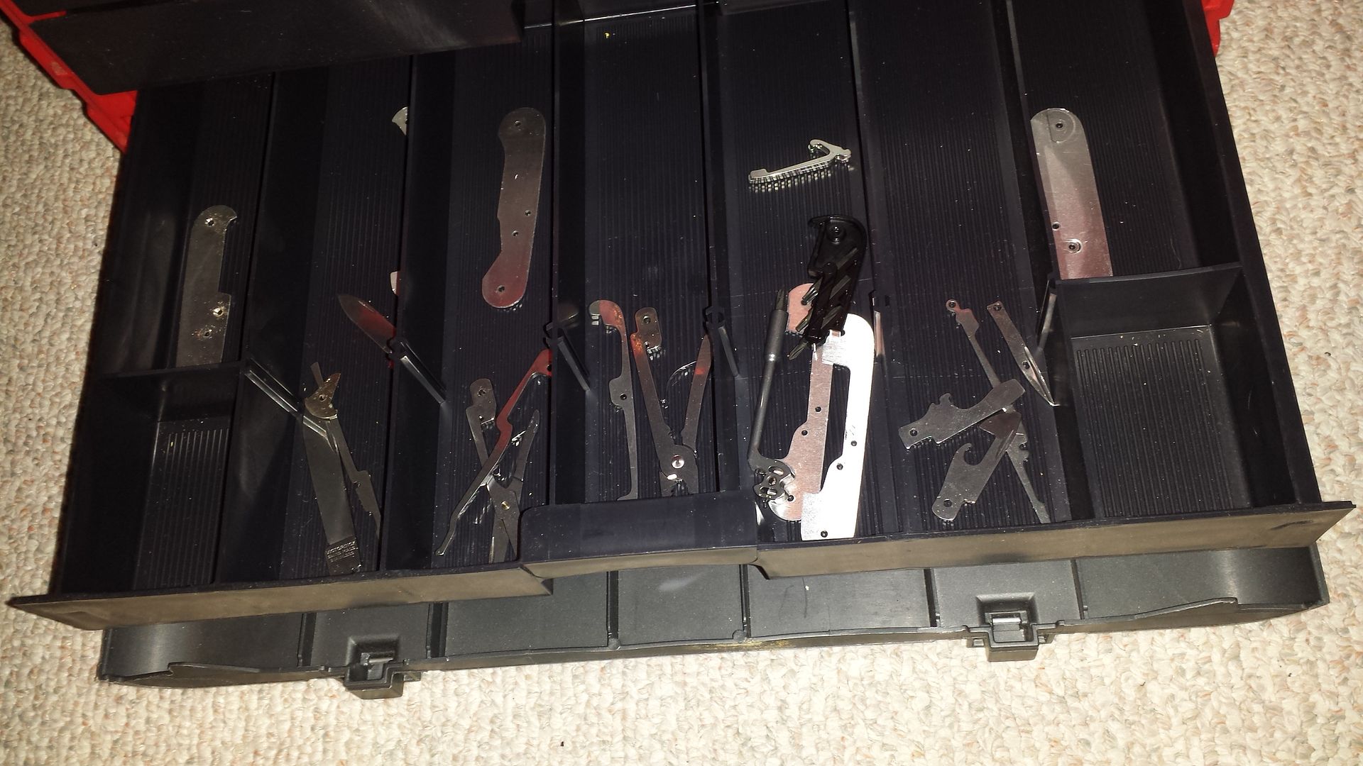

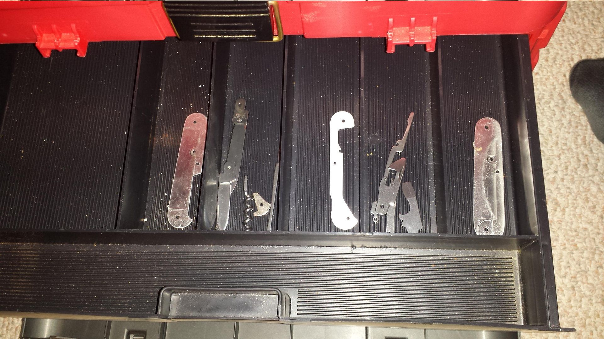

Knowledge Nugget #4
have a means of keeping the parts in order BEFORE you start taking things apart.
might save some hassle down the road.
I started with a nice flat surface and placed things in proper order,  but my wife moved it and shuffled everything together  :rant: (serrated spartan only luckily)
then I went to the divided plastic trays.  works much better
