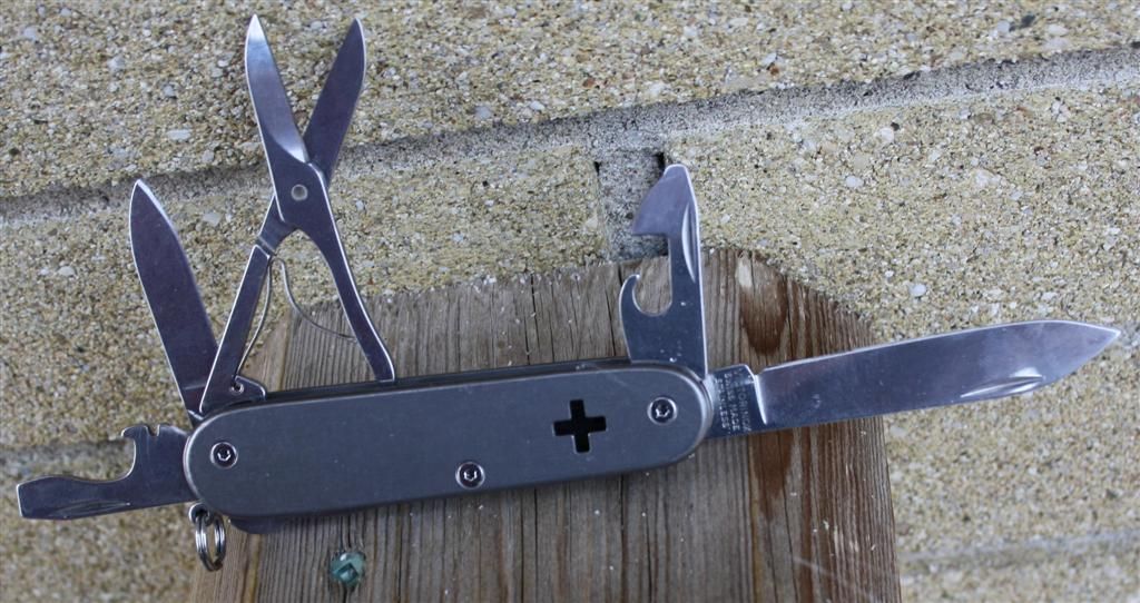

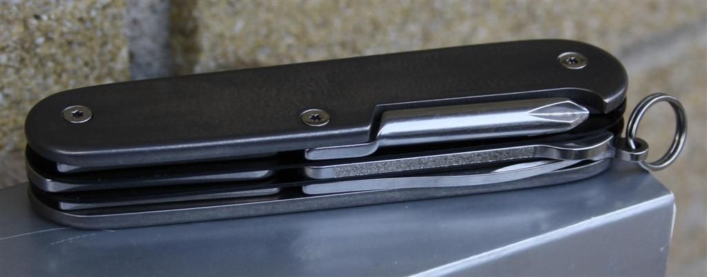

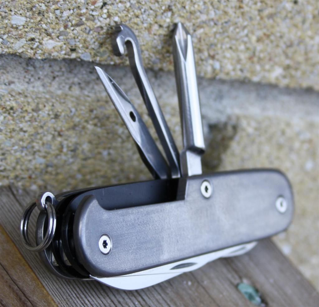

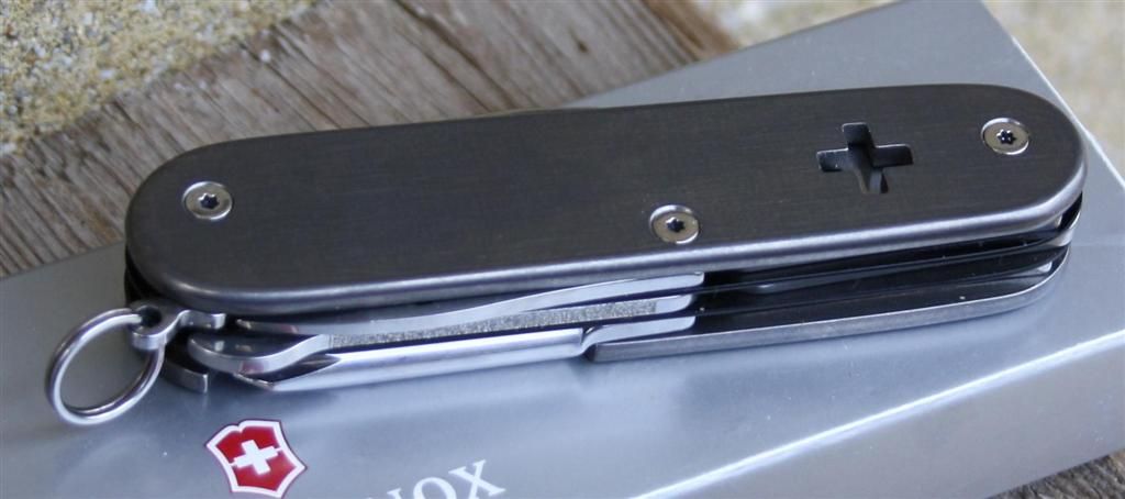

Finally... here we go!  Super tinker with black alox liners.
It was starting to snow when I was taking pics, so these are the best I have for now.

Wow, that a good looking SAK. :drool:

Looks great Syph...nice job!

My reply in Syphs other thread stands.
None of you should be eye balling my new SAK with thoughts of buying it.  :twak:
Seriously though great job man, very innovative.

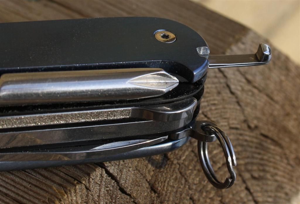

It was trial and error to get that hidden pin just the perfect length but it worked perfect.  I put a flat bottom hole half way through the scale and the thing is rock solid.  I'll take some video next to show the action of the tools as they work perfectly.  I was worried a bit about the back tools operating on the larger pivot diameter, but no problem at all, good snap and rock solid feel.

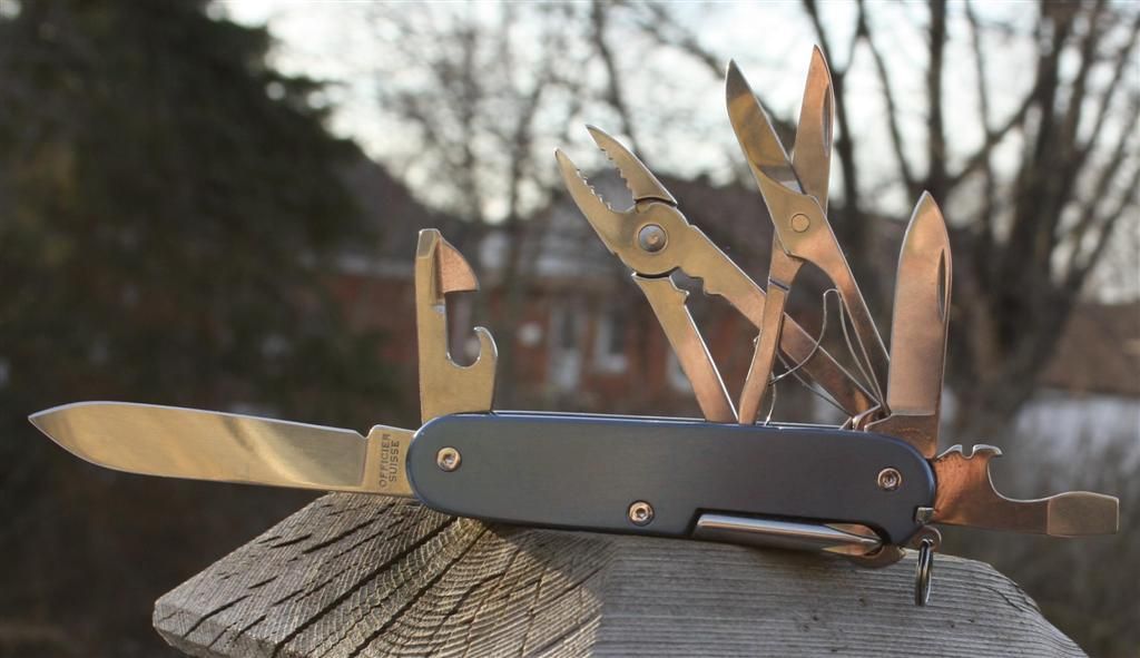

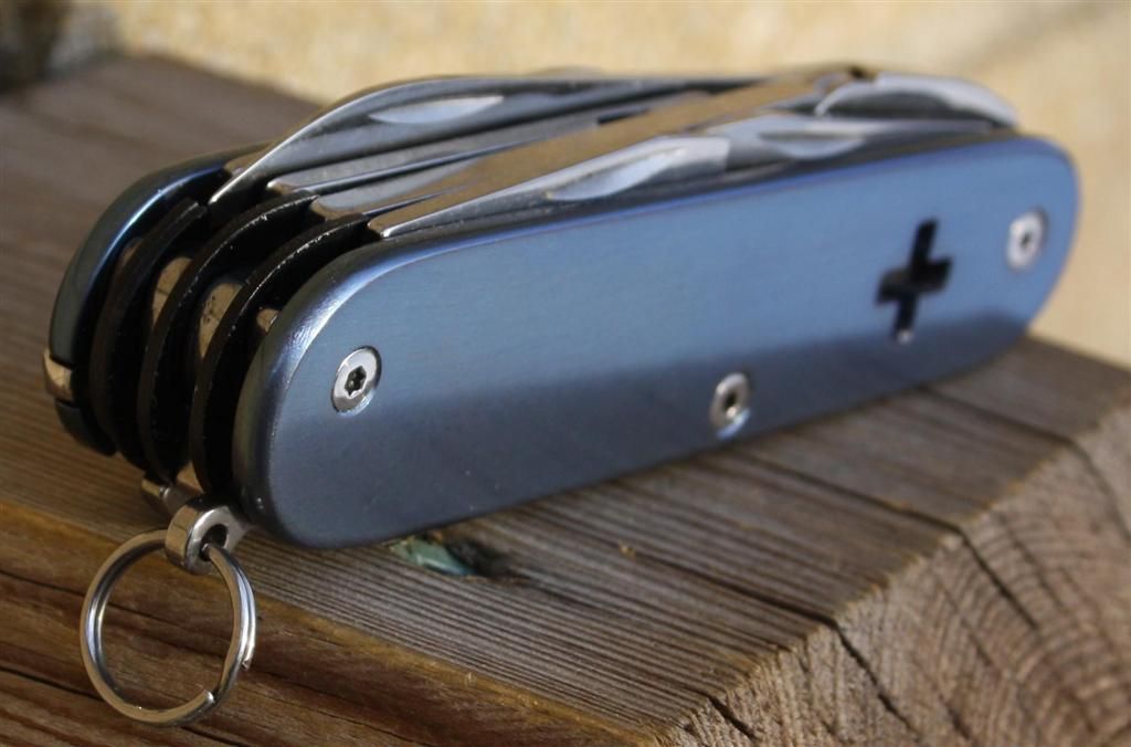

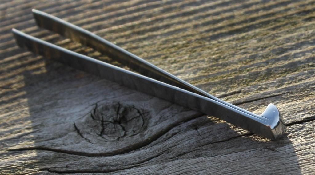

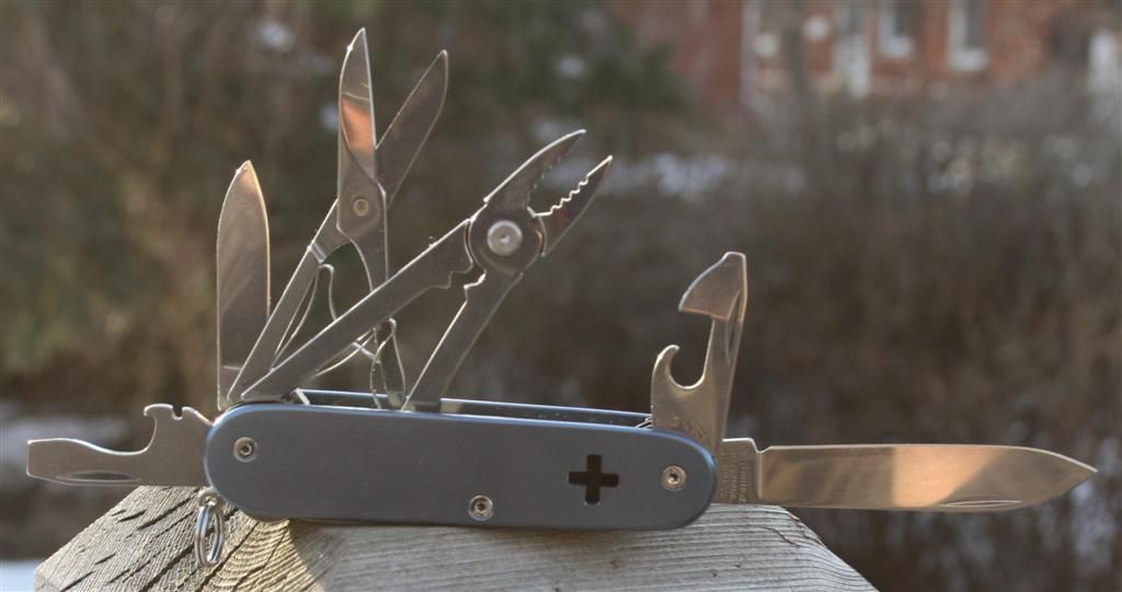

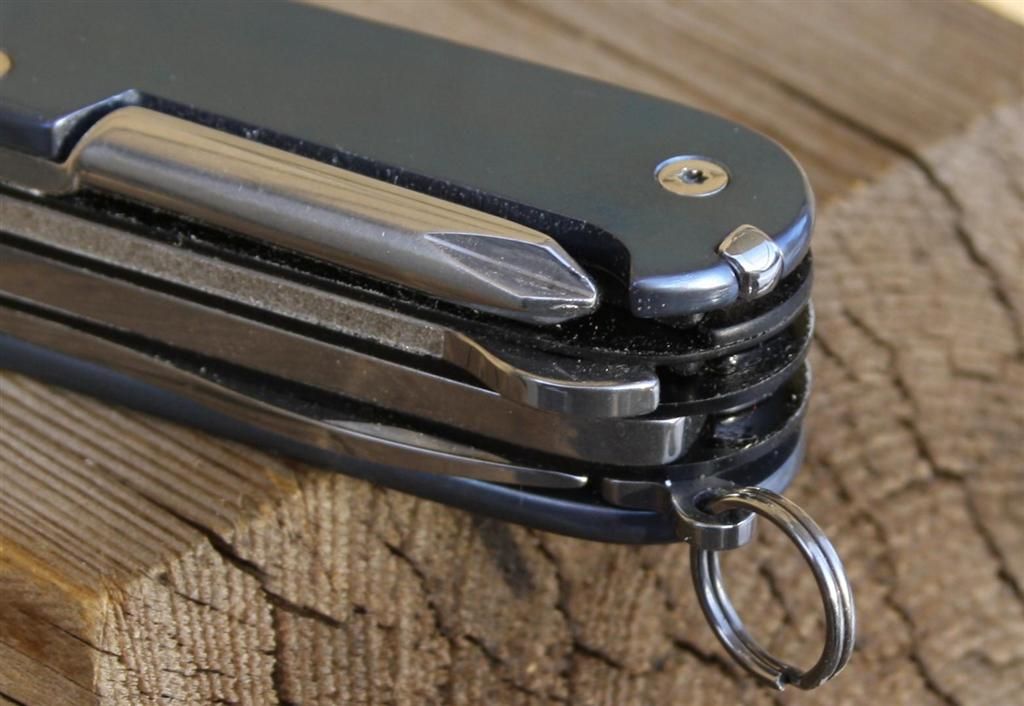

Well I did alot of debating and thinking and I finally decided on the tweezer and scale issue.  No toothpick option as its too hard to make them fit right, but I will offer a tweezer option.
Now I didnt want to include any scale tools originally but this was mostly because I didnt want to have the inner liners.  Well I solved that.  If I put the slot in just the right spot, the backspring acts as the backing for the tweezer so no extra liner needed.  Normally the tweezer is on the front, but I wanted to keep the front scale unaltered.  Win-win!

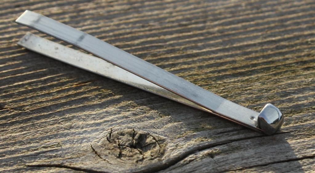

Oh also I removed the plastic nub from the tweezers and rivitted on a small piece of stainless (from a backspring actually) :D

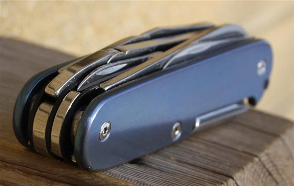

And here is the first build.  Ti deluxe tinker, blue scales and black alox liners.  Tweezers on back scale.
Took me awhile, but I am very happy with it!   :tu:
