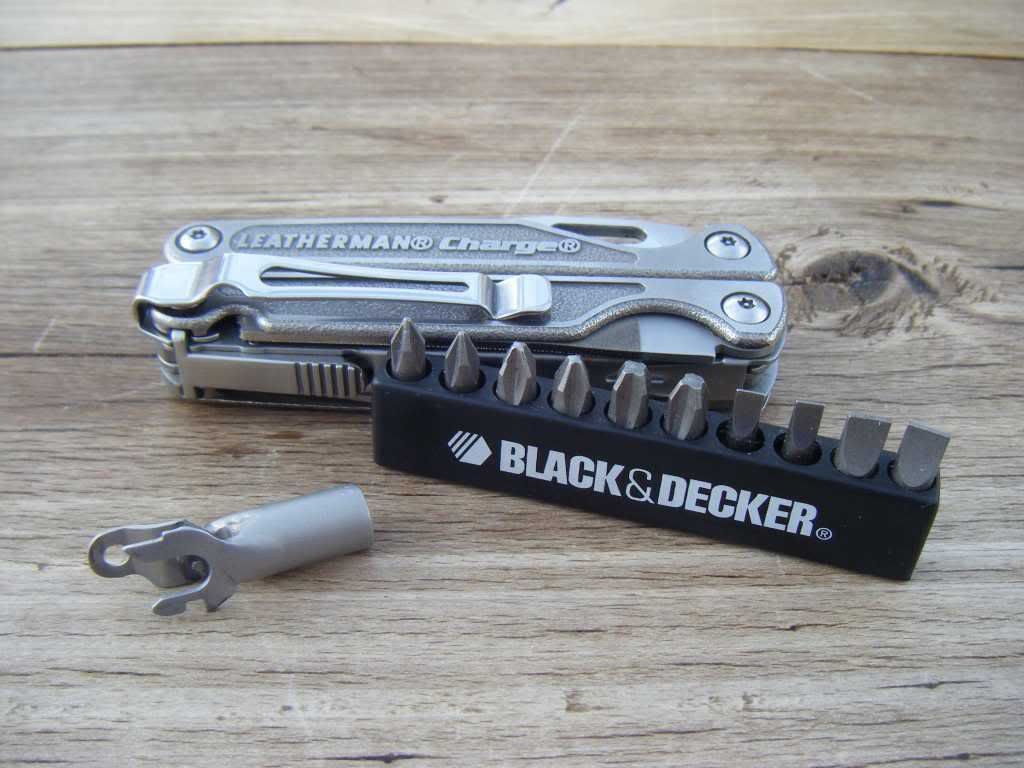

This looks as good a place as any to show off Tarrodemierda (Mikko's) handywork:
Works really well!

I like that mod. What I think would be truly neat is if SOG released a tool much like that one people have been apparently fitting from the nameless multitool. Granted I'm not one for small easy to lose pieces, but I don't worry about 1/4" bits because with something like the SwissTool sheath they fit neatly and snuggly in a little card right in it's own little pocket.

How much torque could it handle, Dave?  ???
A fair bit I reckon. It's pretty solid.
Re: Why no 1/4" drivers?
Reply #16 on: October 14, 2008, 01:59:32 AM
That's an excellent mod!  Now to try and fit one into a SAK  :P
