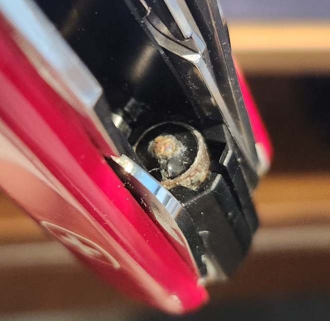

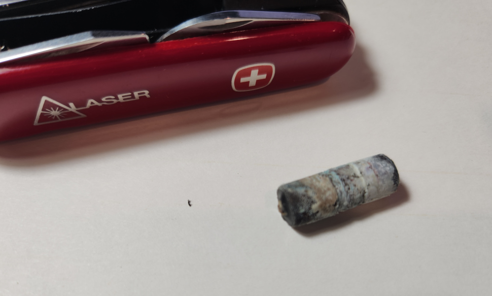

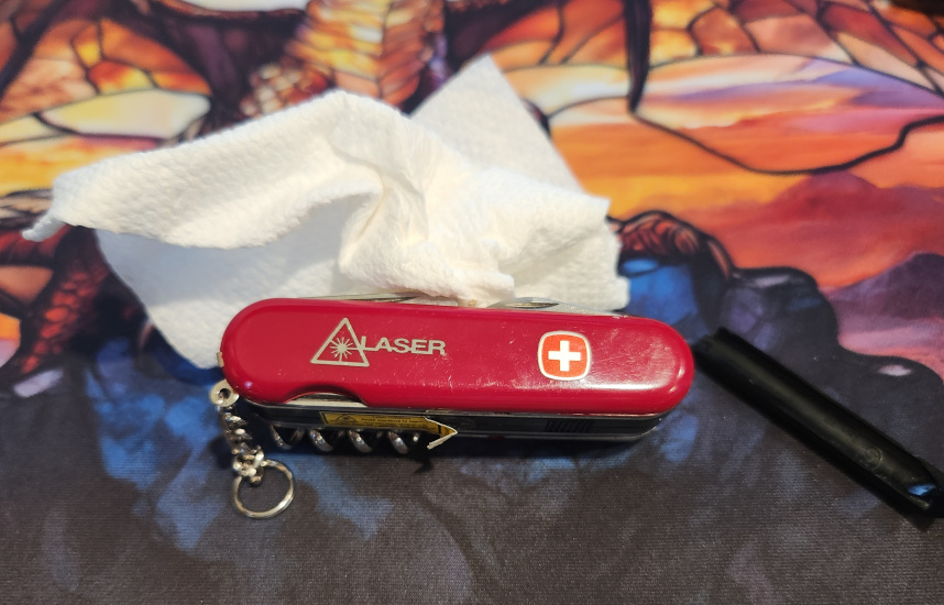

So, this one looked sadder when I first started cleaning it.  Previous owner had left the batteries in there for who knows how long.  Suffice to say that they leaked horribly and I tried to give it a baking soda wash with a brush.  You can still see the corrosion on the bulb.  I doubt the laser will work but I want to give it a try.  Need to finish cleaning it up.  Anyone know if I can find a replacement laser module?

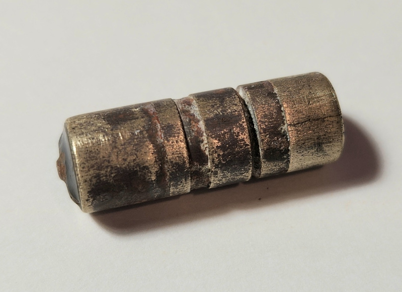

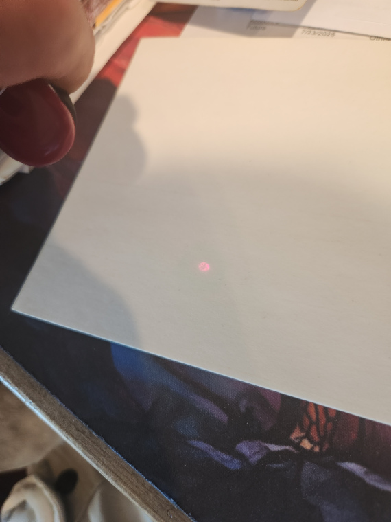

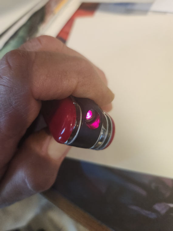

Success!!  It's not such a Sad SAK after all.
I was able to clean a lot of the corrosion off the laser module, by scrubbing it with a baking soda mix, brass bristle brush, and 400 grit sand paper.  The lens shows a bit of damage when you look at it up close but it doesn't seem to affect it past 2ft.  I'm pretty happy with the results.  Not too bad for a $40 investment on an unknown condition knife.
