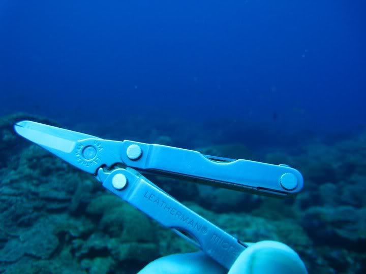

Photo by Cam Stanley, taken at the Flower Garden Banks National Marine Sanctuary, depth 80 feet:

I am sure most multitools can go underwater as shown in turnsouth´s picture, but how many can remain operational after they have a few days of sea salt exposure dried on them and not rust; Also, will they need oiling again, or, can they have a special , possibly dry, lubricant.

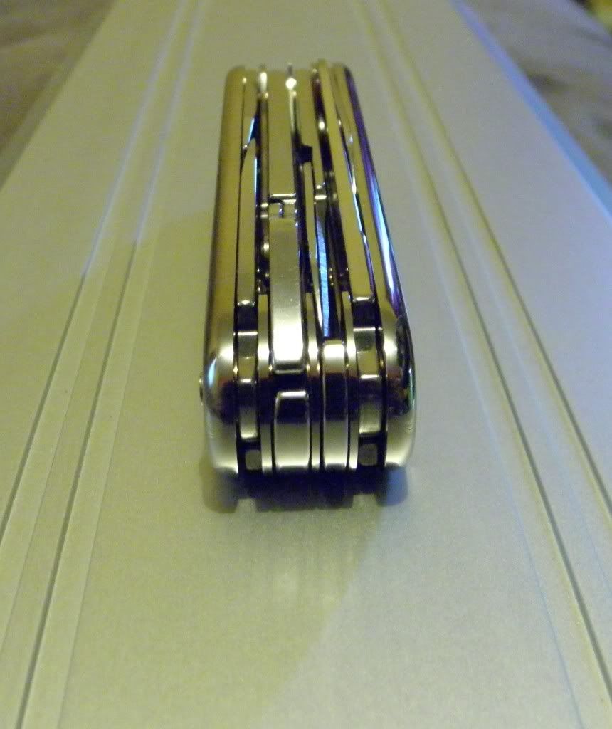

The handles should be fine. The rest of the tool not so much:
How difficult would a H1 one piece tool be to make?

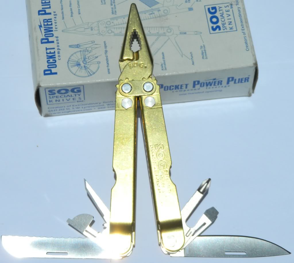

It's too bad that the SOG TiNi tools had only the pliers and handles coated but the other parts are much easier to clean anyway.  I would think that a TiNi Sog would provide a very good amount of corrosion resistance.  The TiNi Coating is a ceramic and very durable.  I have a few of these salted (pun intended) away for someone who wants to either use them for their corrosion resistance or make them shelf queens.
The picture does not do the tools justice.
