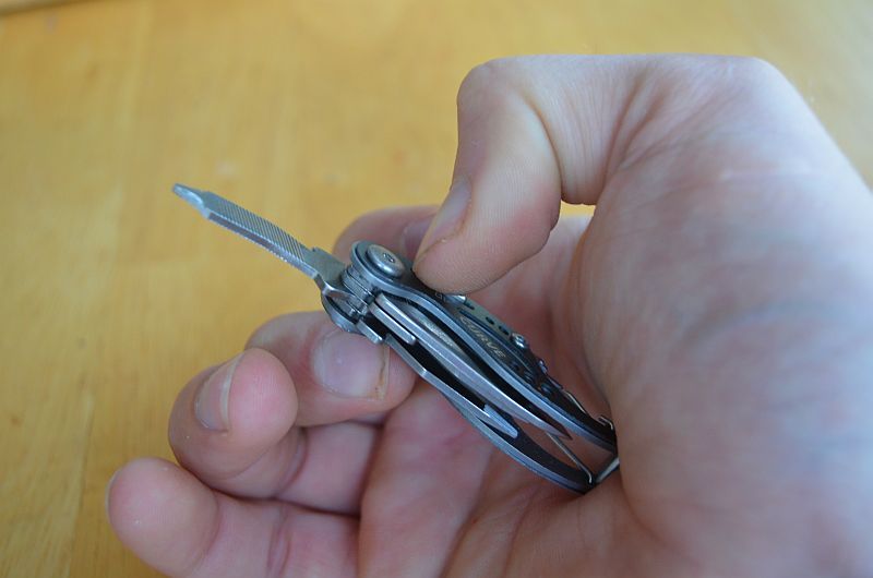

My first instinct on how to unlock the tool is depicted in the picture below.  The issue with this method is that the spring is considerably stronger than you may think.  Also, due to the tiny size of the tool, you have to hold it in an awkward manner and use your fingernails to pull back on the lock.  The bottle opener portion of the handle also is pressed quite hard against the palm of your hand in the process and is uncomfortable.
After playing around with the tool, I found this method.  The tool is grasped near it’s base between the thumb and index finger of my right hand.  With my left thumb and index finger, I press the lock back, and use my left ring, or pinky finger to swing the implement back into the handle.  This method is much, much more comfortable.
