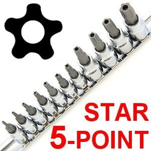

OK, trying to get these pictures was a serious pain in the ass. After messing with a bunch of tripods and different types of lighting, this is the best I can do. The ruler markings are millimeters.
You can see that in addition to the left side screws being smaller than the right side ones, they're also slightly shallower. The overall shape very definitely has squared off ends at the furthest extent. This is unlike an official pentalobe which has round concave cutouts at the furthest extent with the sharp convex points between them. It's not a torx, since torx doesn't have squared extents, and it's not exactly a polydrive either, as the convex dividers are clearly rounded instead of having four distinct sides. (Although a five-sided polydrive might fit anyway. I'm less convinced that a pentalobe or five-sided torx won't strip since there's limited contact area at the important spots).
The center pins are close enough in size that the difference is probably just machine tolerances. A driver small enough to fit the smaller screw might have enough contact area to also work the larger screw without stripping, but I'm not sure.
Offline Quartz
    • Posts: 240
Re: How do I tighten my old Wave?
Reply #22 on: September 18, 2014, 07:41:31 AM

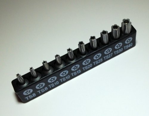

The name of the screwdriver is TS10.
HA! Got it! From Wikipedia:
    * A Torx successor, Torx Plus®, was introduced about 1990 when the original Torx patent was expiring. The lobes are more square to allow for higher torque and minimize wear. The name is shortened to IP (Internal Plus) with sizes ranging from 1IP to 100IP [16] (sometimes listed as IP1 to IP100 [17]) and EP (External Plus) with sizes ranging from 1EP to 42EP as well as smaller sizes ranging from H7EP to H2EP and includes five-lobed tamper-resistant variants.[16] The specifications for these licenses are held by Textron. Standard Torx drivers can be used to drive Torx Plus screws, but not to full torque because of the loose fit. Torx Plus drivers will not fit into standard Torx screws.
    * A tamper-resistant version of Torx Plus® exists having five lobes rather than six, plus a solid post in the center, and is used for security as the drivers are still uncommon.[18] Though Acument (formerly Textron) lists no designation,[19][20] TS [21] or IPR [22] may be seen.
http://www.amazon.com/Anytime-5-POINT-TAMPER-SECURITY-SOCKET/dp/B0026WMIV4/
http://www.amazon.com/Silverhill-Point-Tamper-Proof-Piece/dp/B002P4YCGM/
http://www.amazon.com/5-Point-TORX-Tamper-Proof-Bit-Set/dp/B007SOODHC/ref=pd_cp_hi_1/191-3738474-6837146

Unfortunately, although a normal torx might be able to drive a normal torx plus, the same can not be said for the center posted security variant. I just tried my T10H and it doesn't fit at all. :(
Oh well. At least I know what to buy now.

Yep I got some 5 point screw drivers for my original Wave from Ebay awhile back , they work fine. There is a issue with original Waves , already discussed but here is a bit more info on the topic ;
The early Waves are prone to developing looseness especially in the handles at the 2 plier pivots  :think: LM sorted it with the 'new' Wave.
