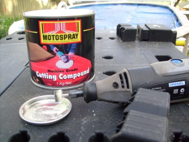

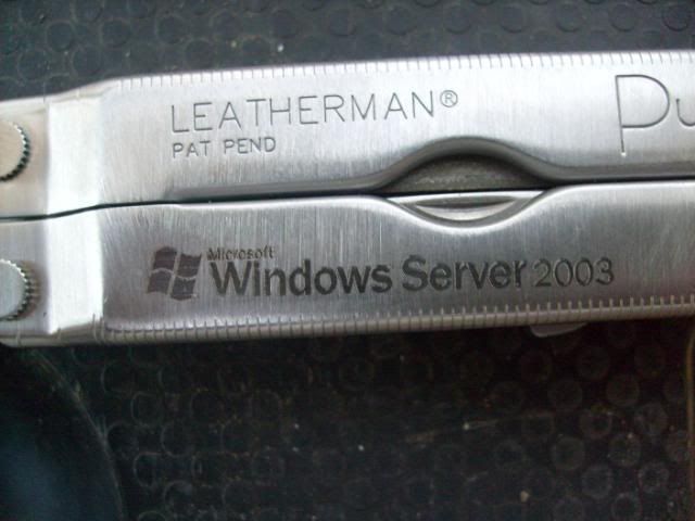

This has been a problem of mine for a while. The only "branding" I want on my MT is the company that made it. I have had a LM Pulse for a couple of months & I never really liked that on one handle it had " Microsoft Windows Server2003"
http://i291.photobucket.com/albums/ll287/multimat426/multitools/df341da6.jpg[/img]]
I have already bought a rust eraser from Ebay US(2 weeks away :( ) to try & debrand the Pulse , but I am a inpatient bugger & I thought I would give my Dremal a go with the cotton/felt polishing attachment & some automotive machine polishing cutting compound
http://i291.photobucket.com/albums/ll287/multimat426/multitools/45e7a21a.jpg[/img]]
The technique that worked the best for me, was too put some cutting compound in a tin lid & then apply a small amount on the branded area of the MT, then a small amount on the face of the polishing attachment. Using my finger too apply small amounts of polish( cutting compound) . It is important not to apply too much as it can get messy & it is important to try & avoid getting the gritty substance stuck in the pivots & various nooks of the MT as it is abrasive. The actual polishing technique I used involved holding the Dremal like a pencil & applying slight downward pressure & then starting the Dremal on it's slowest speed , by doing this you avoid splattering the polish everywhere. Frequently wiping the surface with a rag & re-applying the polish ,I used the slowest speed for the whole process ,only varying the downward pressure I applied . Photos to follow :D

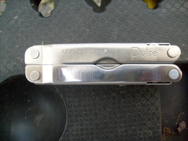

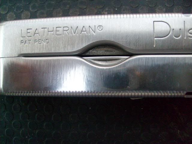

http://i291.photobucket.com/albums/ll287/multimat426/multitools/585379ee.jpg[/img]]
I started very conservatively as I was unsure how it would turn out. I am really happy with the finished outcome , the etching is completely gone . That side of the tool is a lot more shiny than the rest of the tool , it reminds me of a Swisstool  :o :D :D. In day light the polished surface looks a bit cloudy in spots but I am sure it would come out with a less aggressive polish if I wanted too , but I wont  :D
http://i291.photobucket.com/albums/ll287/multimat426/multitools/8fd0220d.jpg[/img]]
http://i291.photobucket.com/albums/ll287/multimat426/multitools/3bce7620.jpg[/img]]

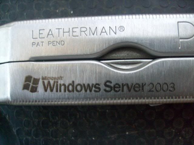

So from this  :(
http://i291.photobucket.com/albums/ll287/multimat426/multitools/5fc1350a.jpg[/img]]
To this  :D :D :D
http://i291.photobucket.com/albums/ll287/multimat426/multitools/65791266.jpg[/img]]
http://i291.photobucket.com/albums/ll287/multimat426/multitools/87774683.jpg[/img]]
In closing I would recommend this technique for sure. Tips go slow ,use small amounts of polish/cutting compound & give the tool a really good clean when finished to get rid of any errant cutting compound from pivots etc.Also Dremal has its own cutting compound but I could not be arsed driving 30mins to the hardware store to get it :D.It would be interesting to see how that worked.
